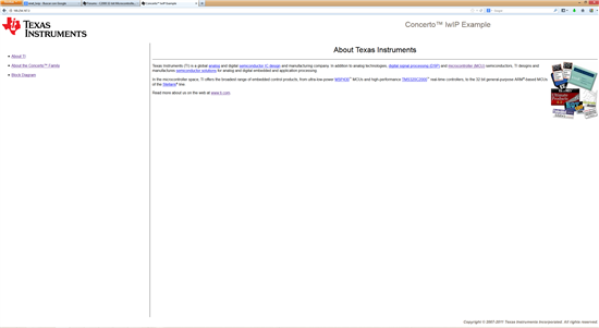

  • Hello
    Thanks you so much, now my enet_lwip example is already working:
  • It is the same solution for the enet_uip example.
    I changed the  set_pinout_f28m35x.c and  set_pinout_f28m35x.h files and now it works both, with Static IP and with DCHP:
    Thanks again.
