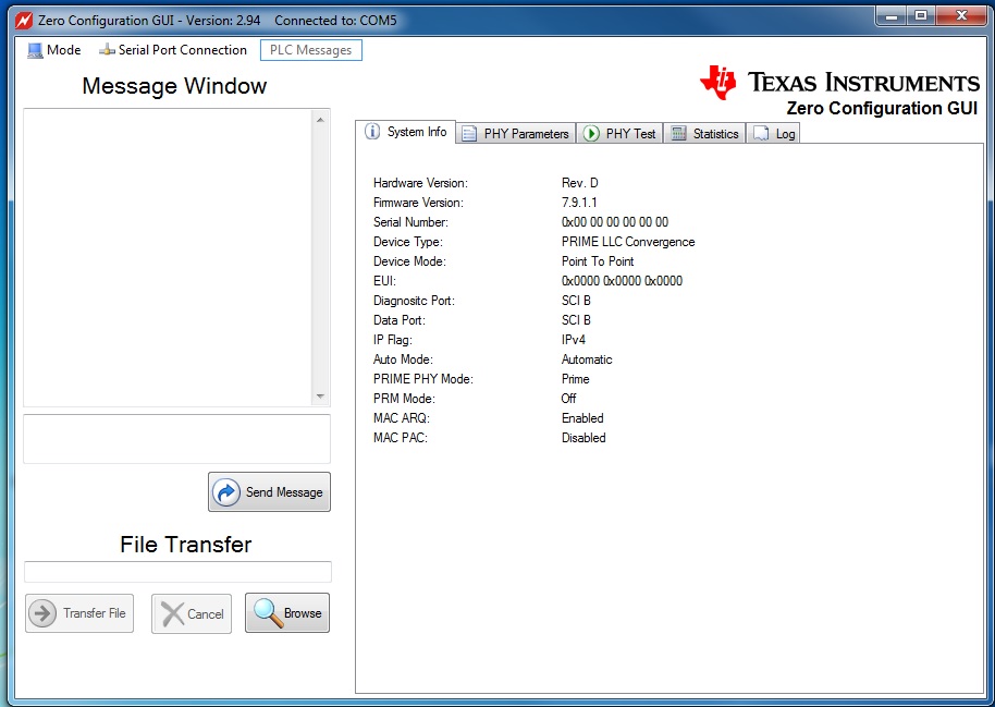

Hi,  I have a TMDSPLCKIT-V3 kit, and am having problem with the std out of the box test using  Zero Configuration GUI.
The kit ships with PRIME protocol loaded.
I have connected as in the getting started guide, but cannot transmit data. When I disconnect from 220V supply and have just cold connection, it transmits and receives data successfully.

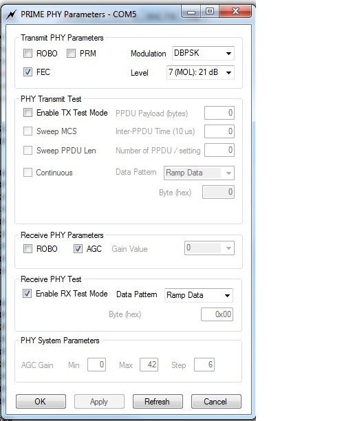

  • Hi Igor,
    Still no luck... yes, J10 and J17 are fitted. I have reflashed modems with both latest version of Prime 7.9.1.1 as well as G3.
    No go.   I have checked jumpers J24 and J22 too. J24 is in position 7-8  and J22 1-2 (cenelec A). So this is the default setting.

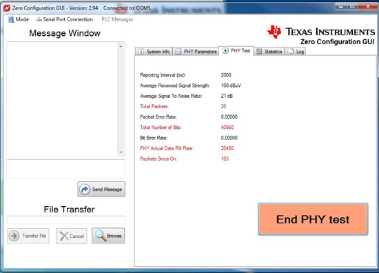

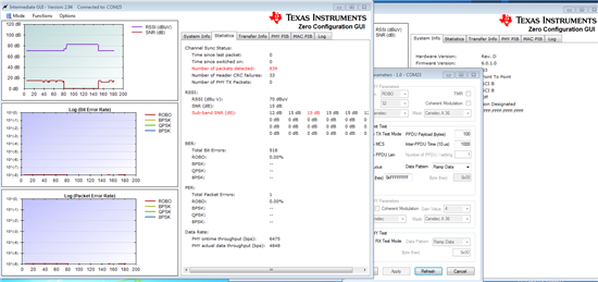

  • Hi Igor,   I have been doing some addition tests.  I do not have any filter surge protection or other. I simply have an extender plug, and plug the modems into the extender..
    I had the local TI rep come and check, and he is also concerned. We did some tests using the intermediate mode. Hopefully you can see these graphs. With COLD connect, the SNR is about 15dB. When I plug into power, the SNR goes to 0dB. Then when I unplug from hot, it jumps up to 15dB.
    Does this make sense to you?

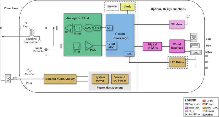

  • Hi Erich,
    I find it hard to make any assumptions...But perhaps some element (or elements) of input chain is damaged in one of modems. For example, input sourge protector (in the figure below). I don't think that both modems are damaged simultaneously. It makes sense to test each modem separately. Maybe your local TI rep has another kit for checking this idea.  Anyway SNR 15 dB very small for normal connection conditions without significant attenuation in short cold wire. It must be about 21 dB! This is not a theoretical value. I got this SNR when worked with these modems and Zero configuration GUI.
    Igor

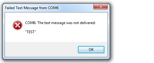

    I am a stundent of University and I have the same Problem like Erich described before.
     I Start the Zero Configuration GUI and set on the first pc the Prime PHY test as Transmitter, the second pc as Receiver. I can not send a message from one modem to the other. A error occurs
    But on the "Receiver gui" i can see received packets:
    Here are my choosen Parameters:

    I have connected the modems like in the video described and did the same with two different Kits.
    Also my SNR is very low and i cant choose the OFDM Modulation.
    I hope you can help me with my Problems.
    Christoph

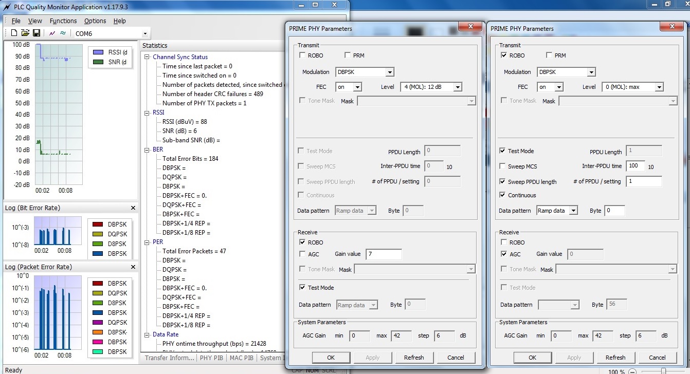

    what exactly is "ROBO" mode ? Can you explain it to me ?
    I set the Parameters like u described but the SNR is down to 6 dB and i got a lot of Errors
    any other ideas ?
    I will try g3 now instea of prime...maybe i get better results.
    regards
    Christoph
