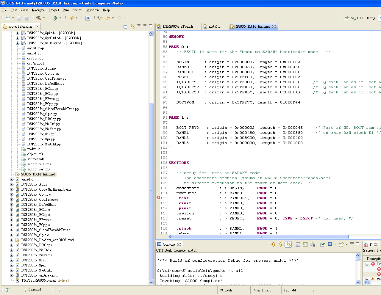

hi everyone I'm new in CCS and i use TMS320F28035
Here is the problem, since i was build my program the error code #10099-D cames out

"../28035_RAM_lnk.cmd", line 112: error #10099-D: placement fails for object
".text", size 0xcbd (page 0). Available ranges:
RAML0L1 size: 0xc00 unused: 0xc00 max hole: 0xc00
error #10010: errors encountered during linking; "andy1.out" not built

I don't know how to fix it
Can someone help?
    The cmd file seems to be having some issues. Try replacing the same from the one available in controlSuite.
    Gautam
  • Liang-Yen,
    The error message says:
    It's telling you that the section .text is of size 0x0cdb words, and is too large to fit in the RAML0L1 memory to which it is linked.  There is onloy 0x0c00 words free in RAML0L1.
    The .text section contains your actual code instructions.  I suspect you've been adding code to your project, and now it has gotten too large to fit in the memory you are linking it to.  You need to adjust your linker .cmd file to link .text to a larger memory, either some large RAM, or start using the flash.
    David
  • Thanks a lot !!!!I
    I just change another cmd file and it works~
