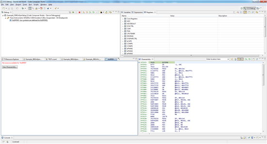

I'm working on a custom speed controller and am having trouble loading a program to the MCU --TMS320F28027FPTT...
I was initially having no trouble with this but I accidentally smoked the MCU by shorting something with my scope probe while troubleshooting something else. I have since replaced the MCU and the DRV8301 (just to be safe) and now I get the title error.
This is what it looks like:
with flash program setting: Program, Verify..
and with flash program setting: Erase, Program, Verify
slightly different...
If I enable silicon real-time mode, most of the registers go to 0x0BAD or Error: unable to read...ie
Other info:
After initial failure to load, I can hit run->reset->rest cpu and the play button will come up (it doesn't when I just hit debug) which I can press and see the CPUTimer and GPIO registers updating.... (The MCU is clearly not running my code though)...
The code I am running is not the issue...I used it successfully before I first blew up the MCU and I have used it on launchpads.
 JTAG Test Connection result:
'The JTAG DR Integrity scan-test has succeeded.'

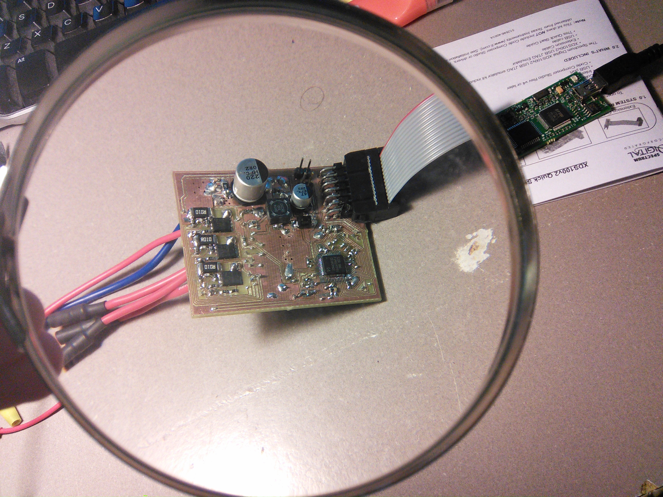

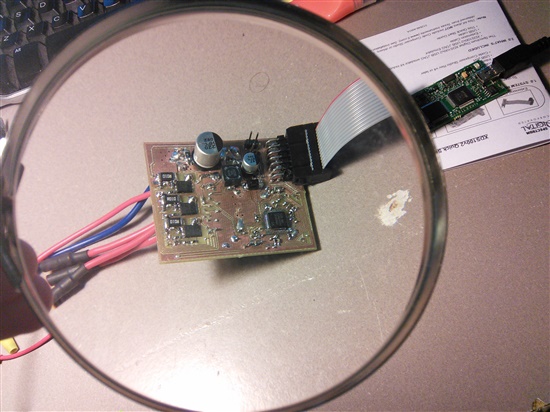

I am confident the MCU has not been stressed (no high voltage, static or high temperatures) but, the nature of the board means that it is possible that there may have been something conductive between traces or something like that... Do I have a dead MCU or could it be something else?

What I meant by 'nature of the board':
    You don't have to worry about the "No source available" error.
    Here's more info on that: http://e2e.ti.com/support/microcontrollers/c2000/f/171/t/252845.aspx
    Also, the board layout seems very very... (can't describe in words). If your MCU was dead, you would not be able to program it. There can be certain peripheral failures though!

    perhaps I wasn't very clear, ill try to be more succinct - my steps:
    *Check JTAG connection...
    *JTAG test succeeds so I go ahead and press debug...
    *Everything seems fine but the green play button is greyed out and the aforementioned error appears..
    *By hitting CPU reset, I can get the green play button to become 'pressable' but when I press it, it either comes straight back out of play or I just can't manipulate any registers. e.g. if I try to toggle GPIO12 by changing GPATOGGLE to 0x1000, GPIODAT does not change. However, if it gets to this point, I can see CPUtimers changing and some other registers that are set by default at reset....
  • Thanks for the detailed description, Patrick. I would first like you to check with one of the simple example code from controlSuite. Let me know whether that works or not!
