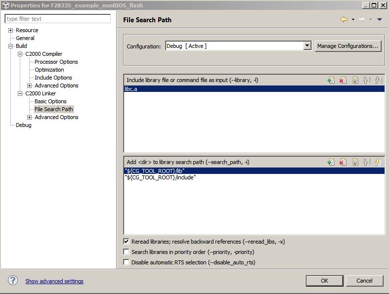

    I don't follow you here.  You are showing a file search path (C:\ti\ccsv5\tools\compiler\c2000_6.1.0\lib\libc.a) and a library file (rts2800_fpu32.lib).  How do you switch the order of these?  They are not the same type of thing.
    The link search path window should look like this:
    And when using libc.a (the automatic library inclusion based on your project options), you specify 'automatic' as the Runtime support library:
    libc.a and rts2800_fpu32.lib do not go together.  libc.a says you want CCS to determine which RTS library it should pull in based on the project settings (e.g., if floating point support is checked, then the fpu32 lib will get pulled in, and so on).
    - David

  • Hi David,
    Screen shots below. Order is changed using the buttons circled in red. I probably don't need the libc.a line anymore but haven't tried without it. Another post will follow:
    Edit - I can't see my screen shots  so will describe:
    where you see "libc.a" in the first I have two lines:
    "rts2800_fpu32.lib"
    "C:\ti\ccsv5\tools\compiler\c2000_6.1.0\lib\libc.a"
    in that order. You can switch the order using the up down arrow to the top left of the box (greyed in you screenshot).
    In you second I see "rts2800_fpu32.lib" (no quotes) instead of <automatic>.
    If I do this I build with no warnings.
    Adam
