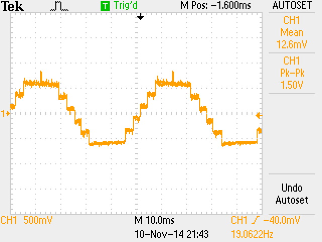

  • I have made good progress on this and have produced the sine output shown below.  Could somebody help me work on being able to manipulate its frequency?  It is at 20 Hz, but I want it to be in audible range.  I am aware that I am not using HRPWM, and would like to eventually but am not quite ready.  I thought that changing my sampling rate variables on lines 110 and 248 would change the frequency but they are not.  I am also working towards being able to play files by putting in arrays of data.  Here is my code: https://github.com/VoiceOvers/VoiceModule/blob/e24167400cdbef06c4d8e121805de9203d3d714f/VoiceModule.c
    Any advice would help, but especially about changing the frequncy - thanks!!

  • I have narrowed down the source of my issue.  For some reason, interrupts are not being called proportionally to the length of my period.  For example, by using a sine wave made of 256 samples, printing when every few thousand interrupts occur and tapping it out on a metronome I did find out that in fact the played frequency should be 20 Hz!!!  But changing the period directly did not affect the rate that the interrupts occurred.  The only progress I have made is that by removing PWM2A and leaving 2B, and removing CMPA, I have doubled the frequency to 40 Hz.  Does anyone have any insight on this?  I am happy I found the root of the problem but am unsure why the interrupt wouldn't be occurring more frequently.  Thanks to anyone who can help!
  • Mr. Lynch,
    It sounds like your ISR is too slow.  Try reducing it to just toggling a GPIO pin and watch that pin with an oscilloscope.  Make sure the period is what you expect.  Then add back in lines of code until you find the one that appears to change the period.
    Bill
  • PS: never print from an ISR.  It takes hundreds of msec.

  • Your hunch definitely put me in the right direction.  Though the 20 Hz was achieved without any print statements as I said, I began thinking that my interrupt was doing too many calculations.  By taking out half of the calculations I noticed an immediate jump, and then by pre-calculating all the duty cycles before playing any audio, the same signal jumped all the way up to 486 Hz!  Thanks!
