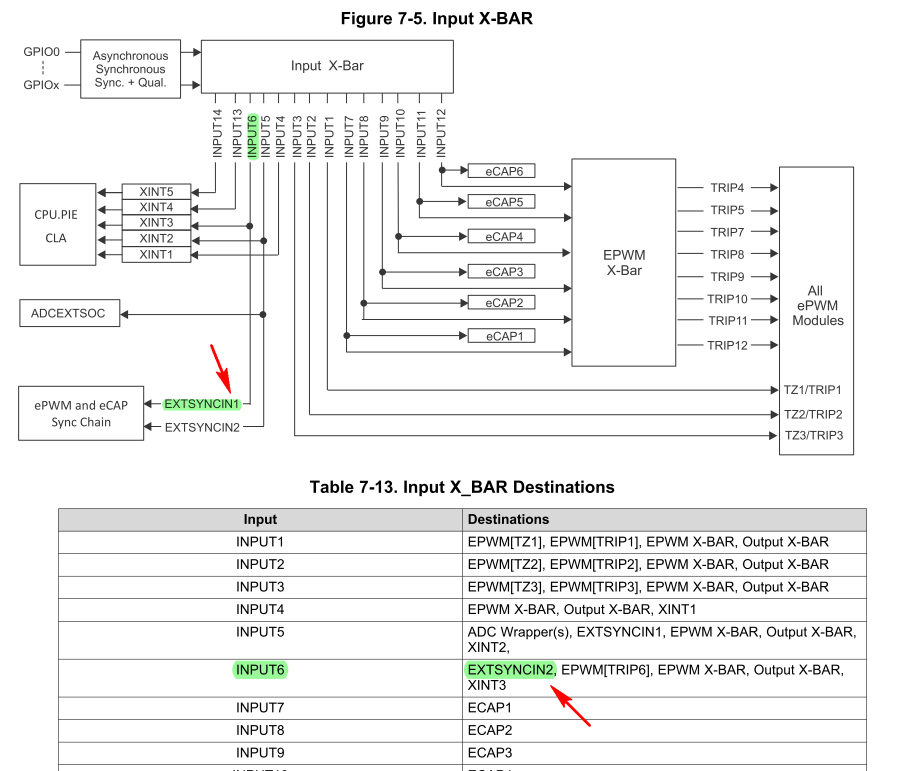

Hello, I read at page 859 of SPRUHM8C
but I found a mismatch
figure 7-5 show input X-BAR and signal EXTSYNCIN1 is connected to INPUT6, but in table 7-13 INPUT6 is connected to EXTSYNCIN2

Thank you for reporting this issue. Gautam is correct. I will submit to have this corrected in the next TRM update.
