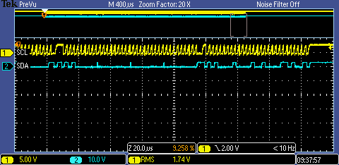

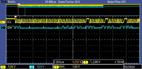

    Write 2 bytes and it was ok. Software stops in void pass();
    Sequence is 0x50(write address), 0x00, 0x00, 0x12, 0x34 and then loops writing 83 consecutive 0x50 with NAKS as responses, then writes a 0x50 and gets ACk as response. See next image that shows the last 0x50 with a NACK. GOOD WRITE CYCLE.
    Read 2 bytes and it was ok. Software stops in void pass();
    Showing Last NACK then the Sequence is 0x50(write address), 0x00, 0x00, 0x00(what is this data?), 0x50(read address), 0x12, 0x34 and ends with Stop condition. GOOD READ CYCLE.

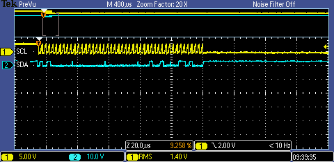

    Next Wrote 3 bytes. Using the same code as before but change the bytes to send to 3.
    #define I2C_NUMBYTES 3 //ja-was 2.
    This is the failure capture.
     Sequence is 0x50(write address), 0x00, 0x00, 0x12, 0x34 with ACK but SCL stays low.
