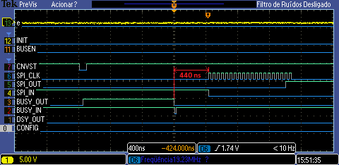

I'm using DMA channels to control the dataflow from an external ADC to the shared memory from F28M36, through the McBSP port configured as SPI Master.
After the end of the A/D conversion, the BUSY_OUT signal from the ADC externally triggers DMA-CH1 (XINT1 negative-edge), which starts a "dummy" SPI transfer, in order to receive the most recent sample. Then MREVT flag from McBSP triggers DMA-CH2 to move the sample from DRR registers to the Shared RAM.
The concept was successfully implemented in a F28M36 ControlCard (C28 @ 150 MHz) and the resulting waveforms are showed in the figure below. My question is whether the delay of 440 ns measured between the XINT1 trigger (negative-edge of BUSY_OUT signal) and the start of transmission (first positive-edge of SPI_CLK) is expected or not, and whether it can be reduced. It seems too long to me, since it corresponds to 66 sys_clk's!
Thanks in advance!
Gabriel

    Are you still facing issues here? you are right that 66 cycles does seem like a lot. Let's take a look at where the delays are coming from.
    Check out this FAQ on Interrupts in C2000: processors.wiki.ti.com/.../Interrupt_FAQ_for_C2000
    First of all, an external interrupt will take 16 cycles for the Full Context Save/Restore. If you ISR is in wait-stated memory, you will incur additional delays. I.e. if your ISR is located in flash, then you will incur additional delays. 3 per instruction at 150MHz. Depending on the number of instructions inside of your XINT interrupt before initiating the actual transmission, the time may add up.
    There will also be some delay from writing your dummy 'data' to this data being copied from the DXR1 to the transmit shift register, then out to the pin. I do not have the exact timing for this process at the moment, but more than a few cycles seems excessive here.
    At the moment, my best suggestion is to ensure your ISR is mapped to a RAM location to avoid the Flash wait-state delay. You could optimize your code to initiate the dummy write earlier as well.
    If this timing is still too much, or you have more questions, please let me know!
    Mark

  • Gabriel,
    I have been getting some assistance on this and needed that clock rate for a timing calculation.
    Here is what I have found so far:
    A. Time for XINT Synchronization: ~3 SYSCLK cycles = 20.01ns
    B. Time for DMA to transfer the dummy data to DXR2 then DXR1: 1 cycle to start, 6 for each word = 13 SYSCLK cycles = 86.71ns
    C. Time from DXR1 being copied to a valid MCLKX Signal = 5 CLKX cycles. CLKX = SYSCLK/8 = 5*53.36ns = 266.8ns
    Total time accounted for is 20.01ns + 86.71ns + 266.8ns = 373.52ns.
    I am still tracking down this last 10 SYSCLK cycles.
    You do not have an XINT ISR running, correct? The XINT is wired up to DMA and the DMA interrupt is when the transfer is complete?
    Mark

  • Gabriel,
    I'm glad I was able to help.
    Regarding the timing: the 5 CLKX cycles is how the module was designed. It takes 3 CLKX cycles for the DXR to register and then be copied to the internal Transmit shift register, and then an additional 2 cycles to move the state machine from idle to starting the external CLKX generation
    I will get this information added to the McBSP Chapter.
    Mark
  • Gabriel,
    I got a little more information overnight.
    We found where the extra ~10 SYSCLK cycles is coming from.
    The internal DXR write detection logic may incur an additional CLKX cycle delay if the timings don't align properly. This additional cycle is another 53ns.
    Also the path from the McBSP to the IO pin will take ~2 SYSCLK cycles or ~14ns.
    I think we can sufficiently say that we have traced the entire route of your transmission path :)
    The biggest factor in the timings is the McBSP Clock rate. If you cannot speed this up any more, you look to be stuck with the ~440ns delay.
    Mark

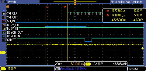

  • Hi Mark,
    I'm here just to further contribute to this topic posting the same image from the original question, but for LSPCLK = 75 MHz. We can see that 440 ns delay was reduced to 328 ns. I didn't make the calculations, but it seems that your estimations would apply correctly in the case too.
    Gabriel
