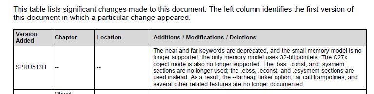

    I found the following in the C28x Assembly Language Tools User's Guide, November 2014, SPRU513H, p.335:
    This user's guide version applies to compiler version v6.4 and later.  I do not see anything in the readme files for the compiler versions however (I checked the readme.txt file for cgtools v6.2.5 and v6.4.5).
    I built a test code project using both cgtools v6.2.5 and v6.4.5.  I included a malloc in the code.  According to the .map file, for v6.2.5, the heap was placed in the .sysmem section, constants in the .econst, and variables in the .ebss.  .const and .bss sections were not used.  For v6.4.5, the heap was placed in the .esysmem section.  Everything else was the same (meaning .sysmem, .const, and .bss sections were not used).  So it does appear that these sections are no longer employed by the compiler.
