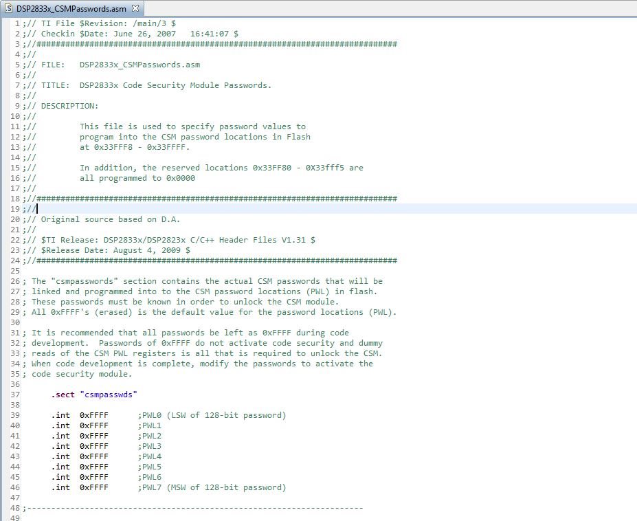

  • But how is the CSM programmed for production? Is it assigned values in the code? If so, what is the syntax? Or something else?
  • You can program the passwords in CCS once the code is developed. In your project look for DSP2806x_CSMPasswords.asm or something similar.
    You can find something like this once you open it:
    You enter your codes in PWLx locations.
    Gautam
  • Make sure you also have the appropriate linker command file which maps "section .cmspassrd" to the correct memory locations in flash.

    The file for the TMS320F28069 is F2806x_CSMPasswords.asm. This file does 2 things: it sets the 8 password locations, and it sets the 0x3F7F80 - 0x3F7FF5 locations to 0x0000, apparently necessary for password to work. However, launching a debug session in Code Composer to program the chip, the session aborts when trying to write these locations because the password is (apparently) programmed first, and locks out the programming utility.
    The chip still programs ok, and the password lock works, apparently because these locations are 0x0000 anyway (in my case); however, to prevent this, split the assembly language source file F2806x_CSMPasswords.asm into 2 files: a new F2806x_CSMPasswords.asm file and F2806x_CSMPasswords_prep.asm file. Then, remove the part of F2806x_CSMPasswords.asm that contains the code to set 0x3F7F80 - 0x3F7FF5 to 0x0000, and place it by itself in a new assembly file F2806x_CSMPasswords_prep.asm. Now, the new F2806x_CSMPasswords.asm and F2806x_CSMPasswords_prep.asm files replace the original F2806x_CSMPasswords.asm file.
    You will see these 2 files in the C/C++ Projects file listing in Code Composer. Exclude F2806x_CSMPasswords.asm from the build by right-clicking the file name in the C/C++ Projects file listing, and selecting “Exclude from Build” from the menu options, then launch debug session to compile, link, and load the program. Next, include F2806x_CSMPasswords.asm in the build by right-clicking the file name, and un-checking “Exclude from Build.” Then, select F2806x_CSMPasswords_prep.asm and exclude it from build. Re-run the debug session. This will complete programming the firmware and lock the chip. The session will abort when the system tries to read back to verify the values, but the firmware is programmed and the chip is locked. Exit Code Composer, and you’re done.
