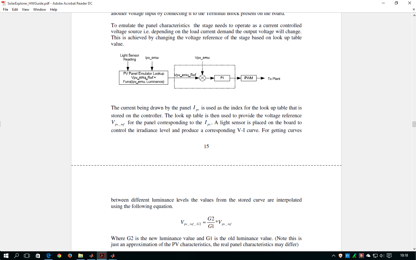

  The V-I characteistic of PV Emulator is shown as such in the manual(see attachment). Here the voltage varies a lot with irradiation while current not so much. But in reality it is supposed to be the opposite ! Is the VI characteristics wrong ?

  •  In this manual, they are indicating that the voltage varies proportionately to irradiance

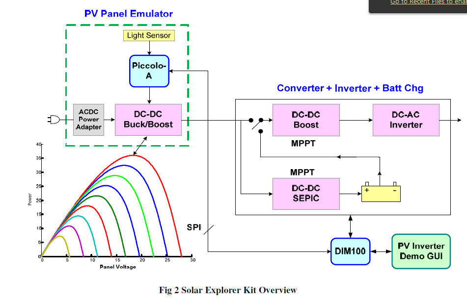

  • See I have uploaded the oher graph given in this manual .
  • Arpan,
    the idea behind the PV emulator on the solar explorer kit was to give a quick demo with some sort of PV characteristics implemented in the emulator.
    We used a basic curve and then just linearly scaled it based on luminance, and did not modify it with complete non linear characteristics that a panel will show under varying lighting conditions.
    The control scheme does not change irrespective of PV characteristics in the emulator. Which is the primary focus of the kit.
    The aim was not to provide a PV emulator reference  design. The source code is available in controlSUITE and you can modify based on what you need for your application.
