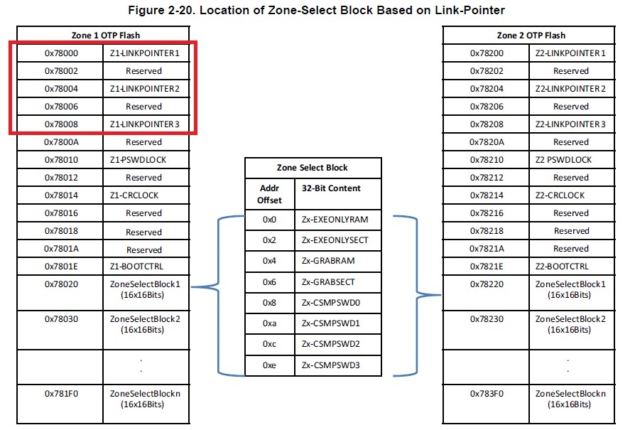

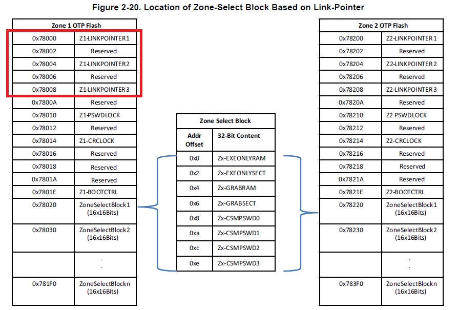

  • Three link pointer locations?
    Could you help show the detail location address for Z1_LINKPOINTER1/Z1_LINKPOINTER2/Z1_LINKPOINTER3?
  • Hi Chen,
    Please refer "Figure 2-20. Location of Zone-Select Block Based on Link-Pointer" DCSM section of TRM.
    Vivek Singh
  • Hi,Vivek,
         I am puzzled.What you refer to  is valid for TMS320F2837xD Dual-Core Delfino MCU.
         But I operate TMS320F28054PNT device.

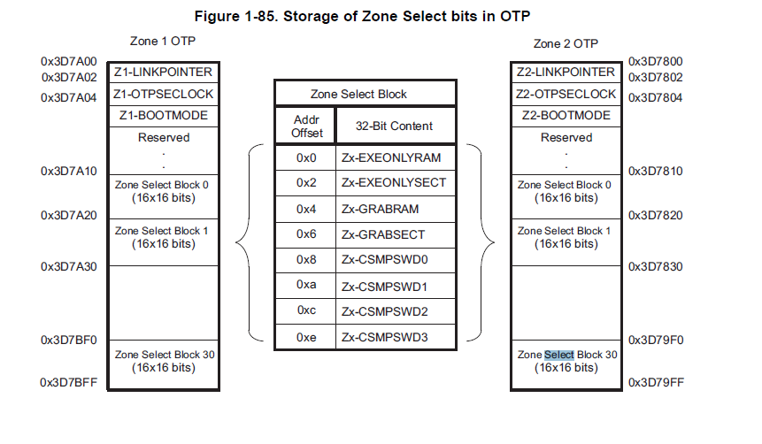

         location of USER OTP for TMS320F28054PNT is below:
         How should I do?
        Thanks~
    Best regards~
    Xin Chen
  • Hi Chen,
    Sorry, I misunderstood the part number.
    Yes, on this device there is only one LINKPOINTER location in OTP and sequence you are trying is correct.
    Could you try following steps on this -
    1) After CCS connect, issue debugger reset.
    2) Hit "Run"
    3) After CPU halts (if doesn't halt automatically, halt it manually), read the Z1-LINKPOINTER register (0xB80) from memory watch window.
    If it still does not show the correct value, to make sure there is no issue with this one specific unit (device), use another TMS320F28054PNT unit (hope you have another one) and try the same thing?
