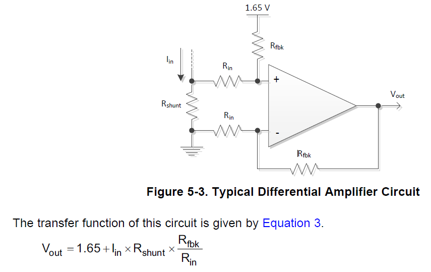

  • My question?
    DRV8301 reference diagram below, the resistance Rfbk is different, Is also a power source REF 2.5V.
    In this case, the equation is not satisfied, and provided in the 14.InstaSPIN-FOC™ and InstaSPIN-MOTION™ User guide. 5.2.1(Current feedback gain) Equation 3.
    How that DRV8301 the 19.08V based on the circuit  is calculated?

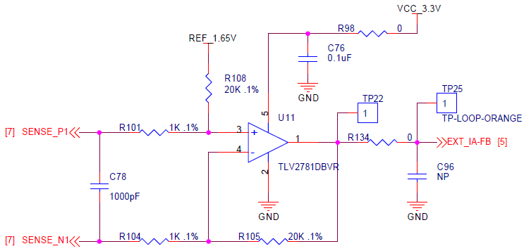

  • Thanks to answer my question?
    DRV8301 reference diagram below, the resistance R108, R105 is different, Is also a power source REF 2.5V.
    In this case, the equation is not satisfied, and provided in the InstaSPIN-FOC™ and InstaSPIN-MOTION™ User guide.(5.2.1-Current feedback gain, Equation 3)
    How that DRV8301 the 19.08V based on the circuit is calculated ?
    sung-ho.
  • Take a look at this other post that talks about feedback resistors being different, and Vref being different.
    https://e2e.ti.com/support/microcontrollers/c2000/f/902/t/357169
    However, if this is for a new design of yours, I STRONGLY recommend using a differential amplifier circuit like the one we have in the 8301 board, to get the best noise immunity when you sample your currents.
    -Jorge
