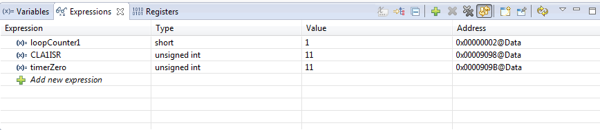

My program : Cla Task 1 is triggered by Timer 0 every one second and inside cla task 1 a variable is incremented.
First I modified the example program sdfm_filter_sync_cla_cpu01 and it worked perfectly.
loopCounter1 is the variable incremented inside CLATASK 1
CLA1ISR is the variable incremented in the CLA 1 ISR function
timerZero is the variable incremented inside the TIMER0 ISR function

Somehow the  Cla Task 1 is executed just once because the loopCounter1 is incremented one time here and I have initialized it with zero.

  • Hi Prakash
    Prakash Kumar Thulasi Kumar said:
    warning #10247-D: creating output section ".bss_cla" without a SECTIONS specification
    This is the reason the code doesnt work. The .bss_cla section is not assigned in the linker command file so the linker will place it in the first available memory e.g. RAMM0, and this memory is usually not accessible (or not configured to be accessible) to the CLA. The .bss_cla section is where all your globabl unitialized variables get stored.
    If you are using the default linker command file you will notice the cla compiler sections (including .bss_cla) are placed in a #if #endif block with the condition being CLA_C=1. You need to define this in the project properties under
    c2000 Linker -> Advanced Options -> Command file preprocessing -> in the "--define" box add CLA_C=1 (no spaces before and after =)
