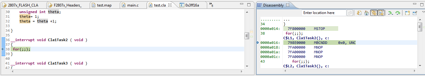

I am trying to implement a task in CLA.

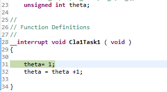

 I have taken a global variable and incrementing it while watching it in watch window.
Code is shown below
And dis assembly is shown below
But it seems that neither the variable is updated nor incremented its value remains 0 only.
The variable is taken globally in CLA (I tried taking it locally also)

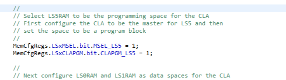

Memory allocation is as mentioned below
    // Select LS5RAM to be the programming space for the CLA
    // First configure the CLA to be the master for LS5 and then
    // set the space to be a program block
    MemCfgRegs.LSxMSEL.bit.MSEL_LS5 = 1;
    MemCfgRegs.LSxCLAPGM.bit.CLAPGM_LS5 = 1;

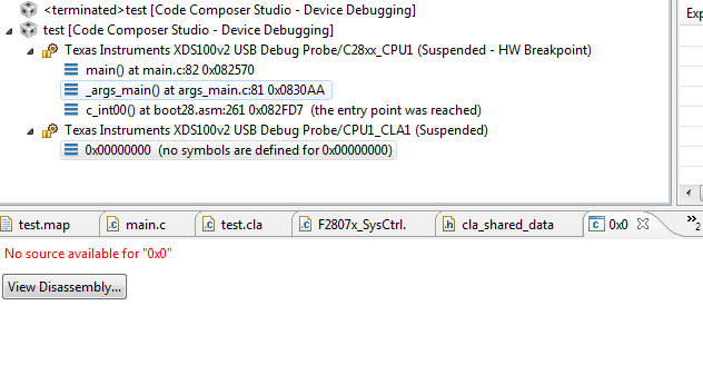

one more thing when i connect CLA with jtag tool it looks like this

    The CLA comes up with no symbol info when you connect to it. What you see is correct, you need to load the symbols to be able to debug in C. Here is a training video that demonstrates the idea:

    4)      I have seen the video of debug but I observe something different than video,
     The program counter of cla “MPC” continues to increment even after MSTOP instruction. (please note that i have only triggered one task of CLA)

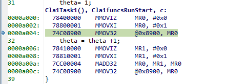

    From the last snapshot you posted, in the disassembly window you can see task2 actually resides in RAMLS4 (0xa016), so i imagine the section "Cla1Prog" is placed in RAMLS4. It looks like you have configured RAMLS5 as your CLA program RAM?
  • Hi vishal,
    Thanks for the sharp observation. I could not have found that out. :)
    I added following two lines
        MemCfgRegs.LSxMSEL.bit.MSEL_LS4 = 1;
        MemCfgRegs.LSxCLAPGM.bit.CLAPGM_LS4 = 1;
    And it works!!
    But I am wondering why the CLA demo codes don’t have same problem?
    As I am checking “cla_divide_cpu01” this demo project.
    There is "2807x_RAM_CLA_lnk_cpu1.cmd" file being used for linking
    That file has merged RAML4 and RAML5 as shown below.
    But in demo code also they have made RAML5 as program memory (nothing done about RAML4!) see image below.
