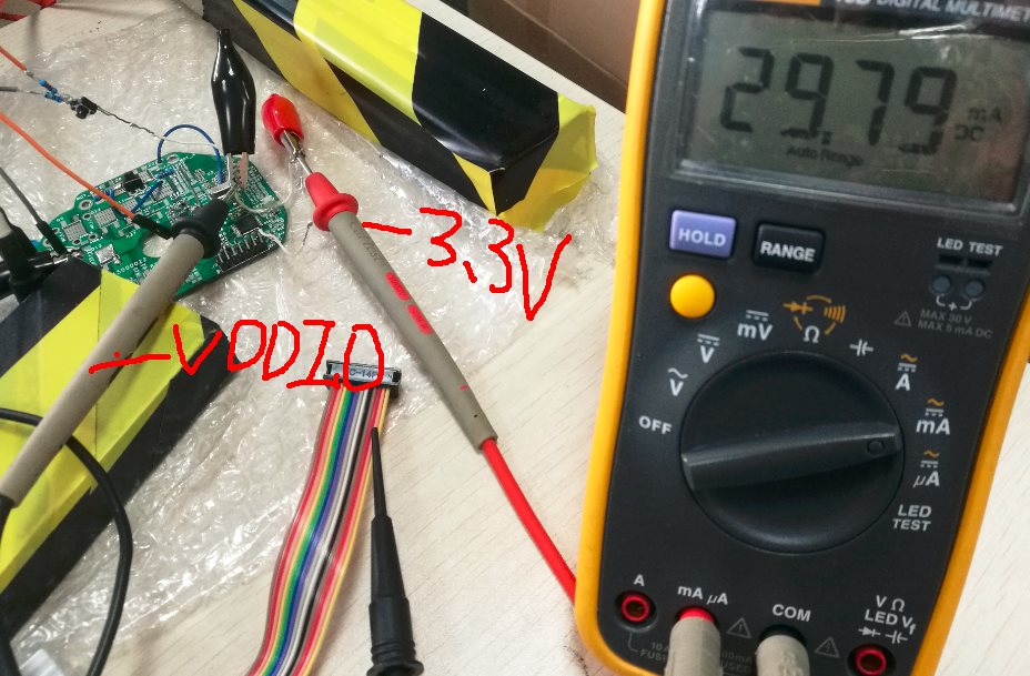

How much is the minimum Power Consumption  of  TMS320F28027F ?   Download  Example_F2802xHaltWake into the TMS320F28027F;   the current measured is 5mA.

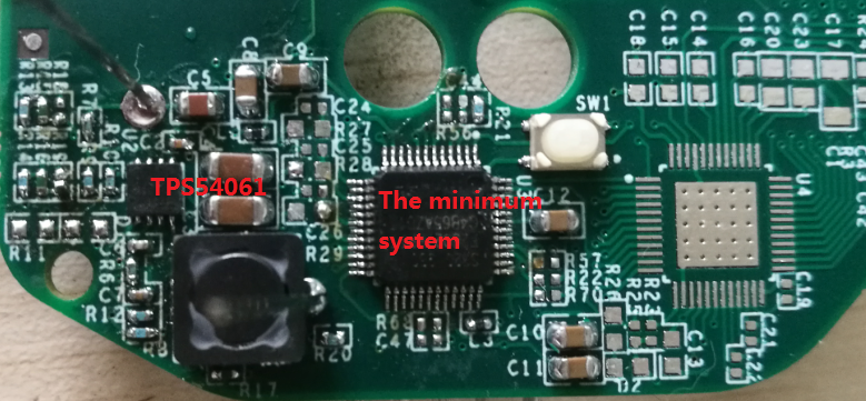

电源系统用的是TPS54061,该电源在24V供电下静态功耗在测得有256uA。(没有接任何负载)
The power supply system with   TPS54061,Power in 24 V power supply,  Current Consumption have 256uA.(there is No load)
The entire board welding with a minimum system, and a download the circuit. Runninng Example_F2802xHaltWake ,the Current Consumption is 5mA,and then wake up the Current Consumption is 10mA.
How much is the minimum Power Consumption of  TMS320F28027F? Could I reduce it more?

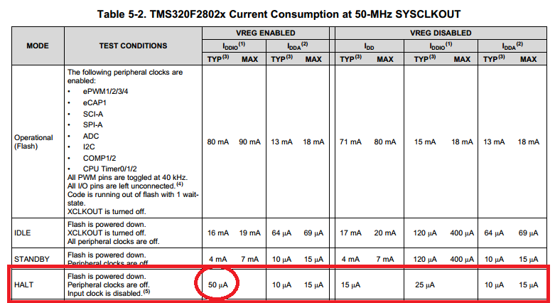

    The device level power consumption information is in the device datasheet. www.ti.com/.../tms320f28027.pdf . See sections 5.4 Power Consumption Summary and 6.1.15 Low-power Modes for more information.
    Halt mode is the lowest power state of the device, essentially one step above being powered down, so there is not much more that you can do. Please verify that the Flash bank is powered down, and that you have disabled the internal Oscillator during halt mode (CLKCTL.INTOSC1HALTI and CLKCTL.INTOSC2HALTI are both 0 -the default). Note that if the internal oscillators are turned off during halt mode, the wake up time will increase.
    What board are you using? is it a custom board? If so, how are you measuring the power consumption of the device? Are there any additional components on the regulator output?

  • There are nothing another loads;only power supply and TMS320F28027F microcontroller minimum system.

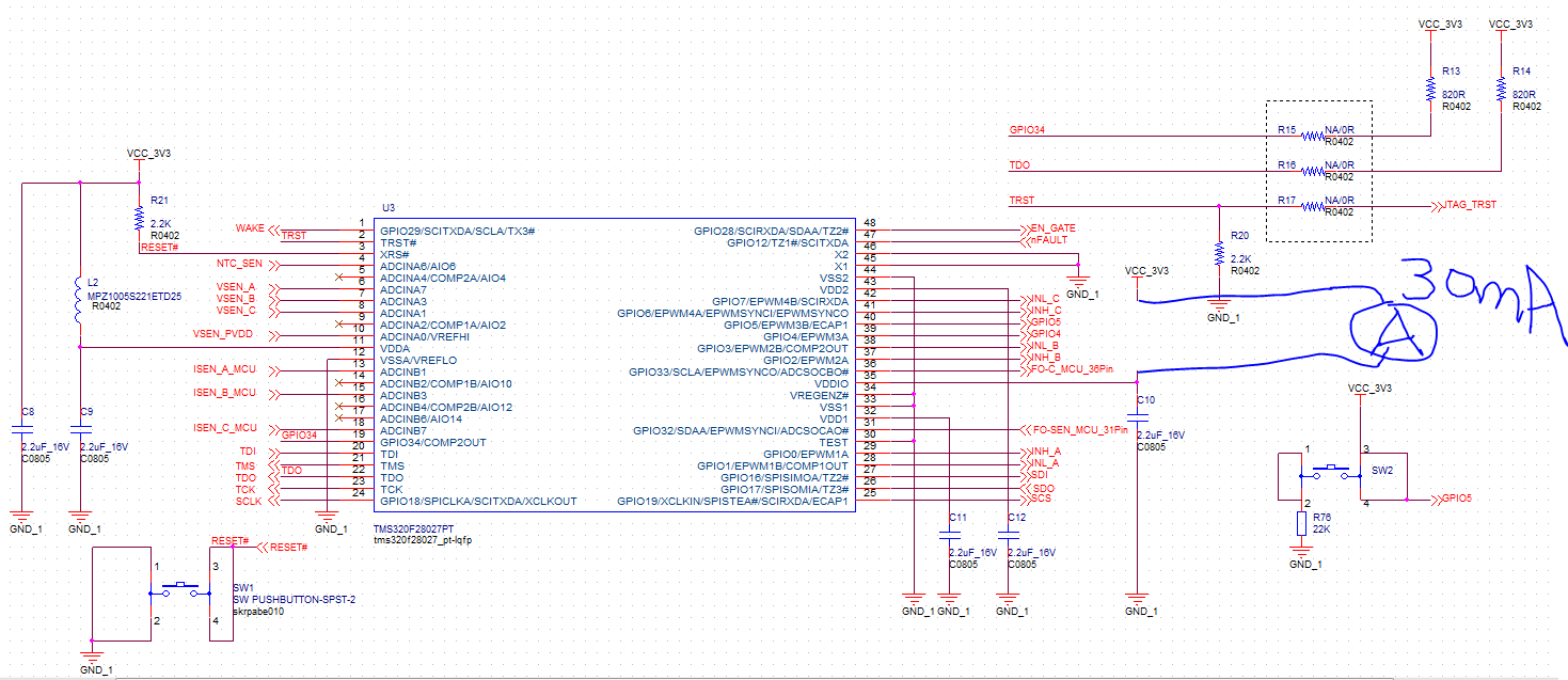

    Can you share exactly where and how you are measuring the power consumption of the device. Are you mesuring a voltage drop across a shunt resistor, putting an ammeter between the output of the TPS and the MCU? I cannot zoom into your schematic image. Please increase the size, or use the attach feature so the image can be clicked.

    both of he IDDIO  value is 30mA !!!!!
    but in datasheet  the  IDDIO value is only 4-7mA.  How did you test?  could you give me some advises.
    There are nothing another loads;only power supply and TMS320F28027F microcontrol  minimum system.
