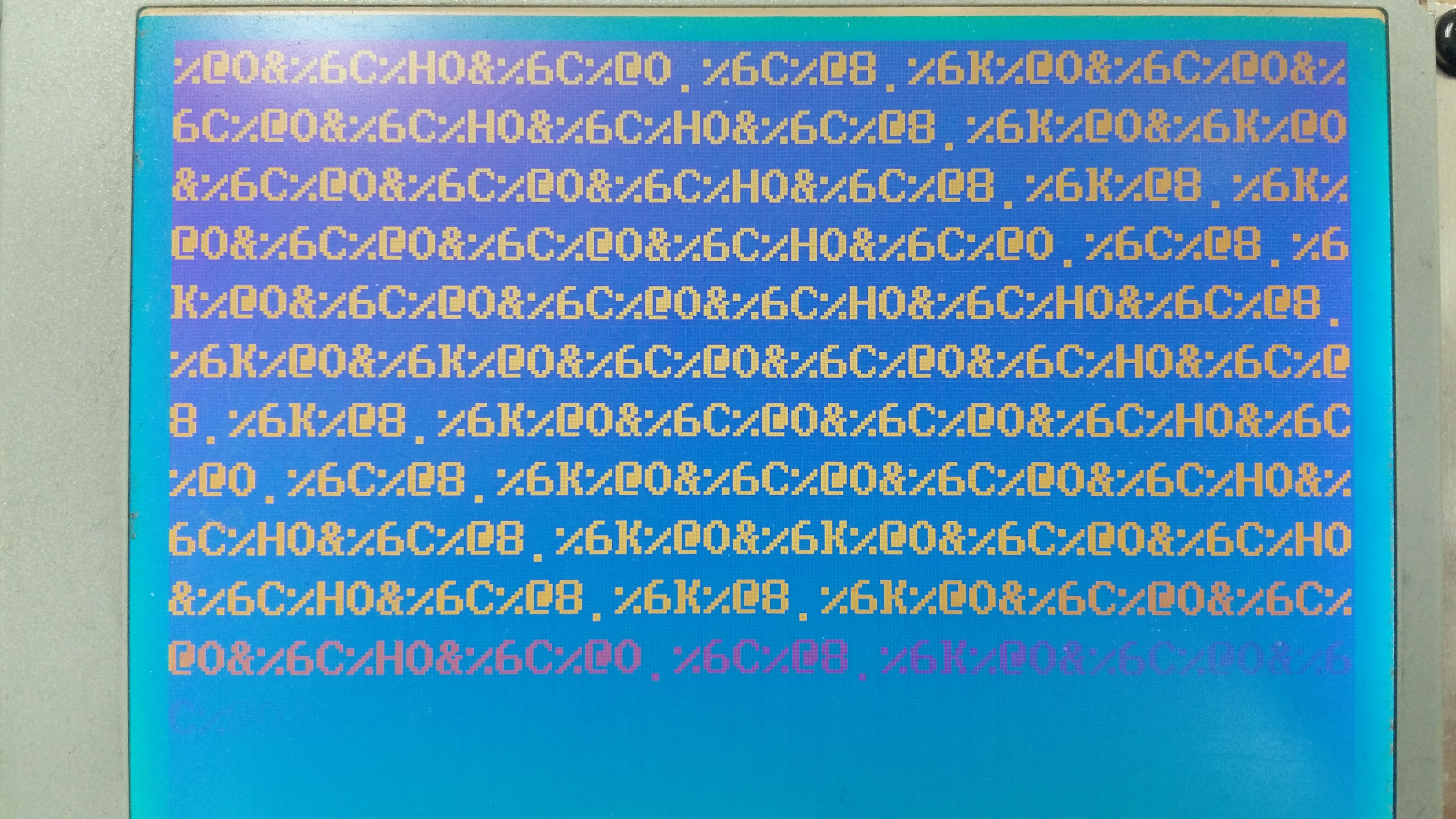

I'm facing to problem that   there is digital signal in SCI gpio out , but in LCD monitor any numbers and values I want .  Can everyone help me ?   Here Sci  registers are :

  •  Hi !   Thank you for your reply  Sal  Pezzino !
    I ' ve successfully built sci echoback example in 2.1 and 2.0 , 1.91 versions of 28377s , but there was no stream of data on TXDA out.
    The data  view below  has  Ascii characters .  I just want ADC results ( voltage sensor values ) in SCI data format on the LCD monitor .The data is not I expected .
    So , that's why I've been concerning .
    Thank  you  in  advance  !
  • Raw data from ADC will not print out of the SCI and appear that way as ASCII values. Perhaps what is printed out of the SCI is correct, but as an ASCII value it looks incorrect. Can you confirm?
    What values are you expecting and what are you receiving? What are the hex values and ASCII characters?
    sal

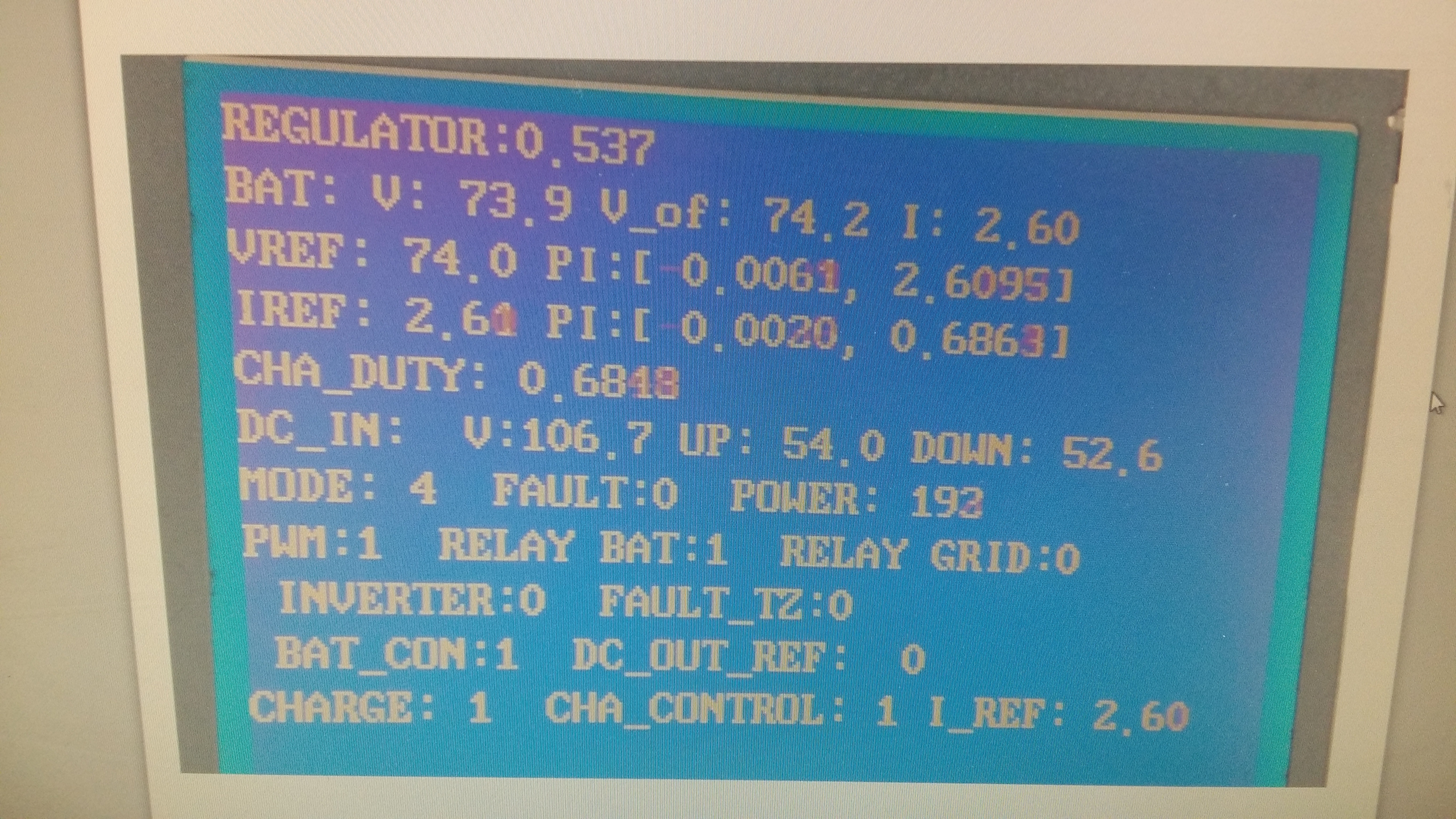

  • LCD_monitor.zipThe problem is : SCI connection is not working properly , briefly . I want to view ADC sensor values ( in decimal format ) on LCD monitor by SCI connection . To do this I used ASCII format changing . I used many examples including sci_echoback , sci_loopback_interrupts , but anyone example source code is not working . But in case of 28335 and 28069 DSPs SCI connection works as well and no problem . I ' ve briefly read SCI part in TMS320F28377S technical manual reference guide . I did all the programming as the same as the guide , but any changes .
    Below the picture is LCD monitor view by 28027 DSP . So I want the view to be from 28377s DSP . Is it possible ?
    What chip TMS320F28377S are ?
  • Below there is zip. file where LCD monitor is picturing as normal through 28027 DSP . Please , when you see pay attention to that all values I want to see are normally being displayed. ......
  • You issue may with the baud rate for the SCI. the F28337x can run at 200 MHz.
    You can configure XCLKOUT to see what the SYSCLK frequency of your device is. F2802x will run at a different frequency than the F28337, so your HBAUD and LBAUD registers will need to be different.
    sal
  • Sal !
    Yes , I know that most of DSPs have the different SYSCLK , for example 28335 has 150 MHz , 28069 has 90 MHz and 28027 has 60 MHz. In my example all of three type DSPs are working well , there is excellent view in LCD monitor .
    Today I've regulated BAUD rates , but there is still unknown picture on LCD monitor . But I want to know when we say that BAUD rate is 9600 , we mean transmitting frequency , right ? On other words , in oscilloscope we have to view TXDA signals with 9600 Hz freq. If that , in my example , when I use BAUD rate = 9600 , there were many frequencies from low freq to 4.8 kHz . I think it's no correct . Which BAUD rate is the best value to transmit data ? In tech manual ref. guide there are 5 values , saying that all of them are ideal ... If that , why in my source code the rate is not working ?
  • 9600 is a common baud rate. So it 115200.
    sal
  • So, you mean the main reason of wrong TXDA signals is wrong baud rate ,right ? And I should to use either 9600 or 115200 ?
    Thanks !
