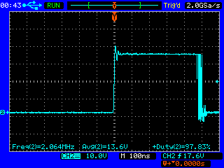

Having been able to get HRPWM to work, I am a little bothered as the result I got is not as good as I had expected. The HR Configuration is as follows:
EPwm4Regs.CMPA.half.CMPAHR = (1 << 8);       // initialize HRPWM extension
EALLOW; EPwm4Regs.HRCNFG.all = 0x0; EPwm4Regs.HRCNFG.bit.EDGMODE = 2; // MEP control on falling edge EPwm4Regs.HRCNFG.bit.CTLMODE = 0; //CMPAHR control EPwm4Regs.HRCNFG.bit.HRLOAD = 0; //load on ctr = 0 EDIS;
I embedded the coded in my normal epwm code. And I am updating the CMPA and CMPAHR registers with Adc output through epwm ISR. I converted the Adc output before the CMPA and CMPAHR update by following the steps listed in http://www.ti.com/lit/ug/spru924f/spru924f.pdf. My Tsysclkout is 6.667ns and my MEP is calculated as 44. Below is what I got:
1. With HRPWM
2. NO HRPWM
I really can't tell the difference. Maybe I am doing something wrong.
I'd appreciate advice and pointers.
+ don't mind the frequency displayed (I believe it is as a result of expanding the image, so to speak), the true frequency is 330kHz.
Thanks.
David.

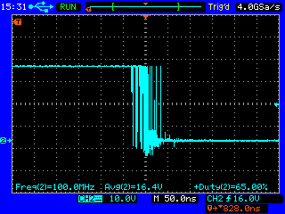

    In addition what Elizabeth suggested, can you zoom in on the falling edge? It looks like there is something bad going on there (why is the waveform so thick)?

  • Thanks.
    I have zoomed the falling edge, find below. It truly looks weird. I will also place the two side by side for better comparison. But in the mean time, what do you think about this?

  • I agree with you. The falling edge is messed up.
    I am not driving anything at all. I am just plotting the pwm output on a scope. The hrpwm initialization is as follows:

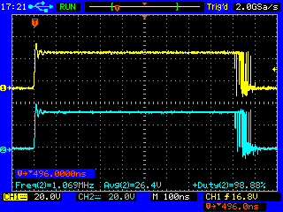

  • Hello Kris,
    I have placed the two pwms together. Yellow - No hrpwm. Blue - with hrpwm
    There is really no difference. What do you think?
    Thanks.
    David.

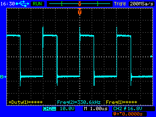

  • Thanks for your response.
    I have tried debugging the pwms. I tried lower frequencies and I got good results. I think the falling edge blur may be because of the frequency I am working with and the fact that the adc output is never constant even at constant analogue input.
    Ordinarily, this is what I am getting:
    I only start seeing the blur whenever I zoom the falling edge. Is there a way to keep the output of the ADC constant as it seems its fluctuation is responsible for the blur?
    Or what other thing can I try?

  • David,
    That doesn't look like a variable frequency ADC issue to me unless your scope just isn't updating in time. If it were just different timing I don't think we'd see the signal bouncing. I could certainly be wrong but my hunch is there's more to the story. Let me contact one of the ADC experts to see if they can help us here. I'd like to get that straightened out before trying to work with the HRPWM.
