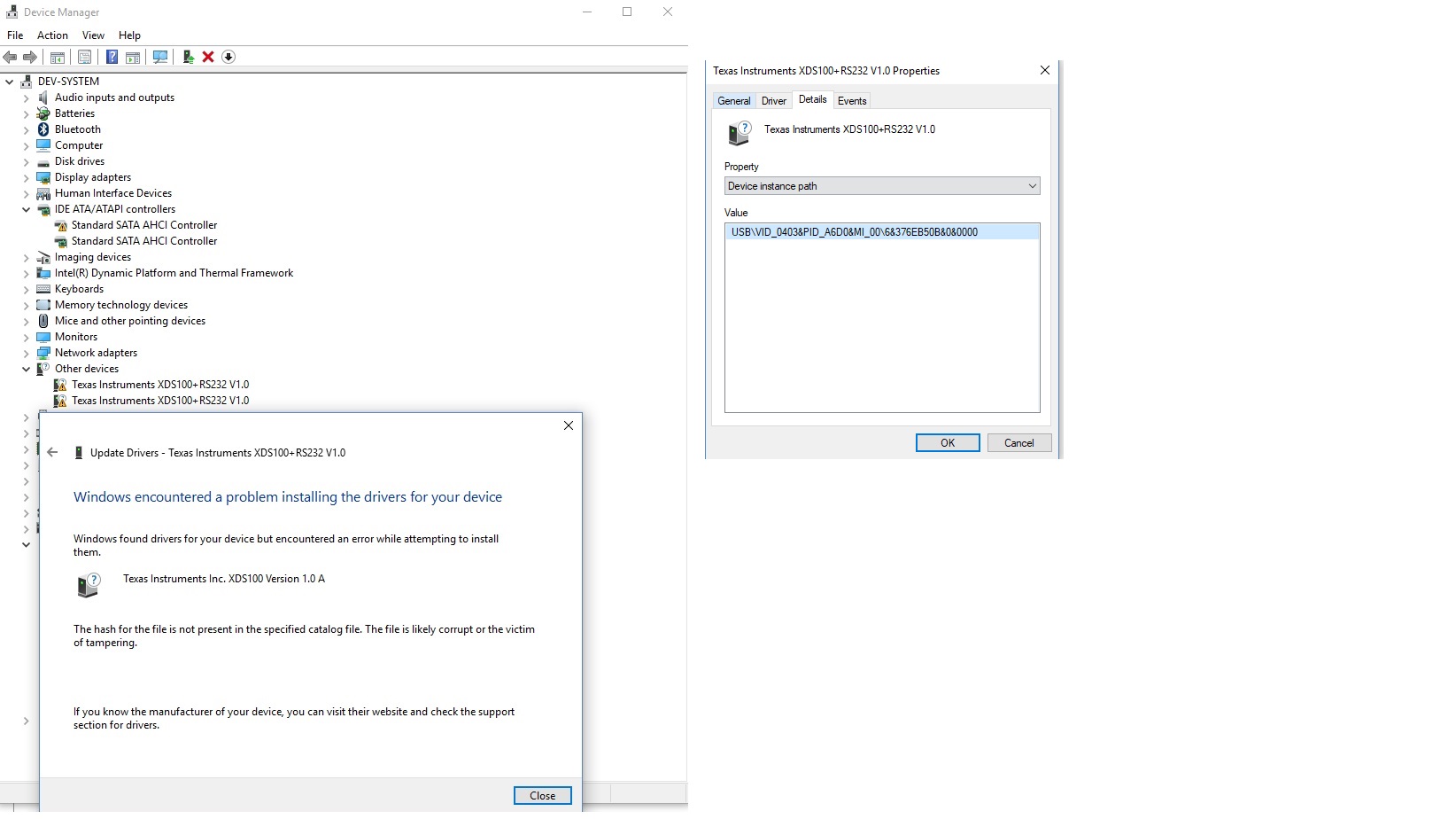

  • Hello Christopher
    Yes i have reviewed this link but still problem is not solved.
    Followed the steps from link didn't worked.
    I have tried fresh installation of   ccs v7 on another pc bt still the xds100 is detected in dual RS232 mode and followed the steps in post but still it is showing Dual XDS100+RS232 V1.0 in device manager.
    after disabling digital signature check for drivers i am able to install the drivers but still jtag connection test failed.

  • Hi Pushpender,
    Can you confirm that Windows Device Manager shows XDS100 entries when the USB cable is plugged in?  I think you have mentioned that you do, but just making sure.
    Is the main board's J1 ([Main]-J1) populated?  It needs to be populated in order for CCS to work with the kit.  It enables the JTAG debug probe's TRSTn to go to the device.
    (you can find the relevant schematics in the zip file located in the following wiki: http://processors.wiki.ti.com/index.php/C2000_DPSWorkshop)
    Hopefully this helps.
    Thank you,
    Brett
  • Hi Brett
    Thanks for the tip, After populating J1 everything is working fine.
    Pushpender
