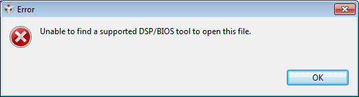

I am getting the following error when I double click on a .tcf file in my project.

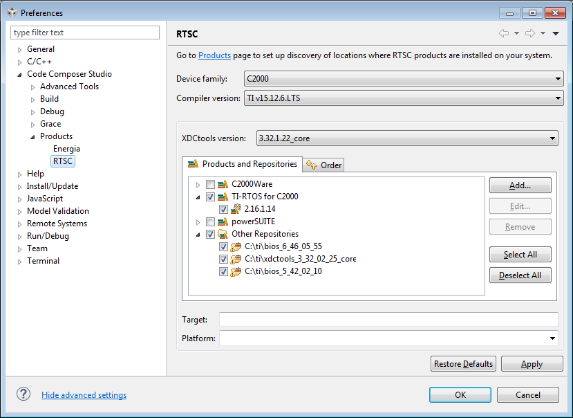

My XDC type system variables have the following values:
XDCPATH
C:\ti\bios_6_46_05_55;C:\ti\tirtos_c2000_2_16_01_14\packages;C:\ti\tirtos_c2000_2_16_01_14\products\tidrivers_c2000_2_16_01_13\packages;C:\ti\tirtos_c2000_2_16_01_14\products\bios_6_45_02_31\packages;C:\ti\tirtos_c2000_2_16_01_14\products\ndk_2_25_00_09\packages;C:\ti\tirtos_c2000_2_16_01_14\products\uia_2_00_05_50\packages;C:\ti\xdctools_3_32_02_25_core;C:\ti\bios_5_42_02_10
XDCROOT
C:\ti\ccs6_2_0\xdctools_3_32_01_22_core
XDCTOOLS_JAVA_HOME
C:\ti\ccs6_2_0\ccsv6\eclipse\jre
The RTSC Product is setup as shown below.  Also, the project that I have was a CCSv5 project imported into CCSv6.2
