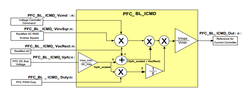

PFC_BL_ICMD,In assembly, the algorithm of this module is   :out = [(VacRect*VinvSqr*Vcmd*VmaxOverVmin)/(Vpfc*VoutMaxOverVinMax*Duty)]*(Vpfc*VoutMaxOverVinMax - Vacrect).
but,
I don't understand the specific operation of the PFC_BL_ICMD:n module,And then I found DPLIB.pdf,as flowing:
BUT,I found that this is just a block diagram of that algorithm, and I still don't understand how it works.Why is it designed like this?Why do these inputs carry out the reference current?Please tell me the algorithm.
