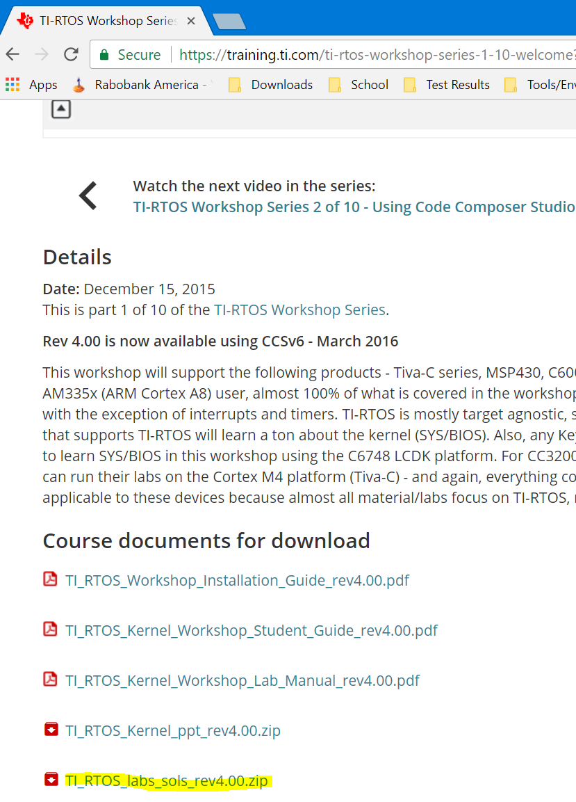

I try to make first steps following TI-RTOS workshop, where can I download the TI_RTOS_labs_sols.zip files for the TI-RTOS workshop series (https://training.ti.com/ti-rtos-workshop-series-introduction)?

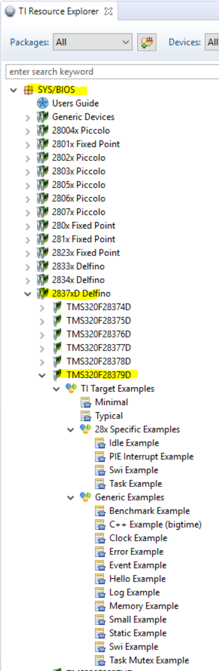

  • Hi Lukasz,
    You can install SYS/BIOS and then have CCS discover it. The examples are in Resource Explorer Classic. Here is the download site:
    I'd install in the default directory (c:\ti) and then start CCS and follow the prompts when it discovers SYS/BIOS.
    The solutions for the TI-RTOS Workshop are on the individual pages. Note: they are getting a little stale.
