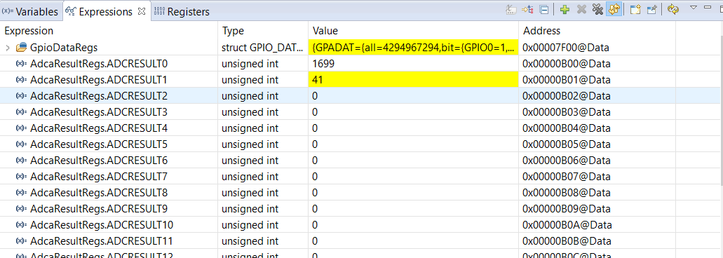

I have a problem with a multiple SOC and their results.
I need to use 12 channels, for each channel I use singly SOC. I have started with lunching of one channel, have no problem with this, all works perfect.
The next step was to make 4 SOC for 4 channels, and here the problems begins.
By giving 1.5V at channel A0, I've become result in registers ADCRESULT0 and ADCRESULT1 (See Image 1).
By giving 1.5V at channel A1, in register ADCRESULT1 (all right).
By giving 1.5V at channel A2, I've become no result at all, and so on.
I have read all examples over 10 times, same thing with Technical Manuals... I have no answers found.
What's a reason could be?

    Is your ADC-A INT1 ISR occuring?
    The general setup looks OK: ePWM SOCA triggers ADCA SOC0-SOC3 then end of SOC3 triggers ADCISR.
    The channel select and S+H settings also look OK.
    However, even for A0, it doesn't look like your results are quite rights: even with 3.3V VREFHI range, 1.5V/3.3V*4096 = 1862 but your ADCA result0 is 1699, which is much too low. You might want to check the physical connections for VDDA, VREFHI, and the actual ADC A inputs.
    Is this a TI kit or your own custom board?
  • Hello Devin,
    Yes, adc_interrupt works fine, it's just empty now =)
    I use this Kit www.ti.com/.../TMDSDOCK28379D
    with this ControlCard www.ti.com/.../TMDSCNCD28379D
    so the REFVoltage is intern.
    Besides, most of the time there is another program on this chip, that use ADC and all works fine. And I havn't find distinctions in properties...
    The result from A1 that is laying exactly in ADCRESULT1 show 1863+-5, the same result show result register, when only one channel works. That's meens that there are no problem with REFHI REFLO voltage =(
    I'm stumped... I have even tryed to use the epwm_adc_example but with 4 channels - the same problem.. With one channel even with 4 SOCs all works prety well.

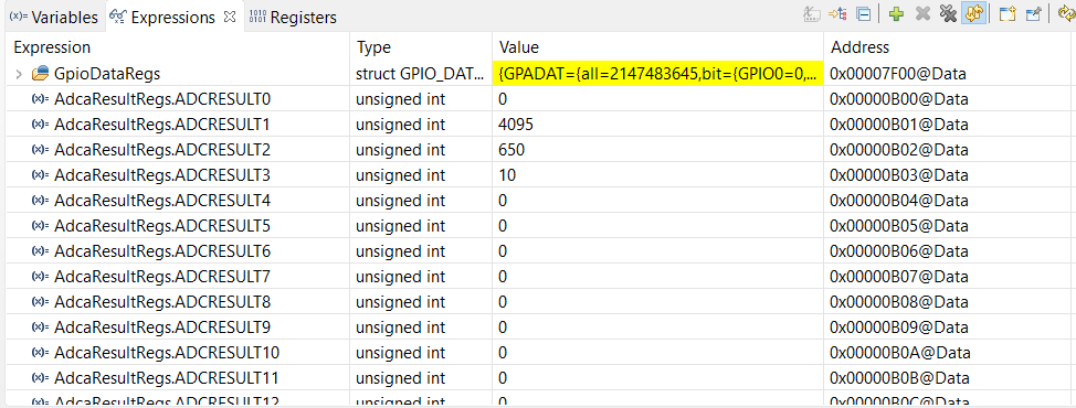

    "In the left position – ADC-A is configured to use VDDA (3.3V) as the ADC’s voltage reference. The fullscale
    range of this ADC will be 0-3.3V, but the ADC will have reduced accuracy/precision.
    • In the right position – ADC-A is configured to either use a precise 3.0V voltage reference or an
    external voltage may be used as a reference. R59 and R60 determine which setting is used (see
    description for R59/R60, above)"
    I am using left position for switches SW2, SW3. This means that the reference voltage is 3.3 V.
    In previous tests I've applied 1.5 V to A0 channel, this time I've apllied 3.3 V (see screenshot)
    3.3 V to A1
    3.3V to A2
    3.3 V to A3
    It's look like an overflowing is occurring... but why put it the result in others registers? (With 1.5 V same story, but with smaller values)
    Thank you!
  • Hi Anton,
    Are you driving anything on the other channels? In the absence of an input, whatever charge is leftover from previous conversions will be converted.
    It does seem strange that A2 and A3 aren't reading exactly 4095.
  • Hello Devin,
    no, I am using a single cable and applying voltage to each channel separat. 3.3 V I take directly from the Kit-Card.
    In this board another person use his programm with this properties (see code) and ADC works well. I don't need so many interrupts and ADC's only ADCA and one interrupt. I see no difference in properties and don't understand why the result is so wrong...

  • Hi Anton,
    If you apply the voltage to each channel one-at-a-time (while the other channels are floating) we do expect to see what you presented previously. You need to drive all the channels you are using with some voltage all the time.
  • Hi Devin,
    Thank you for your advice! I will try it and write later an answer =)
  • Hi Devin,
    Your advice was very useful! Now all works pretty good!
    Thank you!
