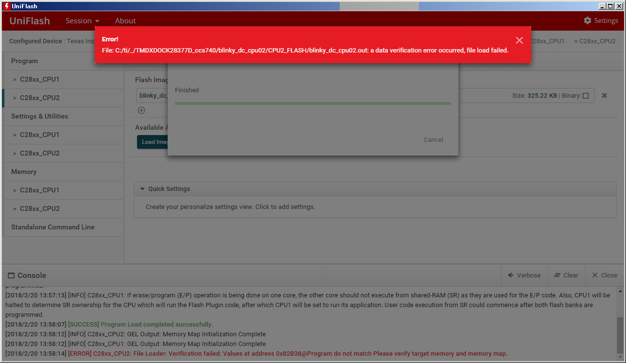

My Uniflash 4.2.2 console output the following error message. Could you please advise?:
[ERROR] C28xx_CPU2: File Loader: Verification failed: Values at address 0x82B38@Program do not match Please verify target memory and memory map.
Test procedure:
- The source project was blinky_dc_cpu02 in C2000Ware_1_00_03_00.
- The source project was built by CCS740 in build configuration CPU2_FLASH.
- The output blinky_dc_cpu02.out was fed to Uniflash 4.2.2.
- Launch Uniflash 4.2.2.
- Program the blinky_dc_cpu02.out.
- Verify the CPU02 flash. >>> Error.
Findings
- The error points 0x82B38@Program. I attached its map file for reference.
- I also found that the Uniflash memory browser display the address 0x82B38@Program as all 0x0000. (Please be noted that my main point is the verify error.)
- The CPU02 finely blinked when the CPU01 was also porgrammed. Therefore the CPU02 program result should be okay. And the checksum was also okay. So the point would be just verification.
