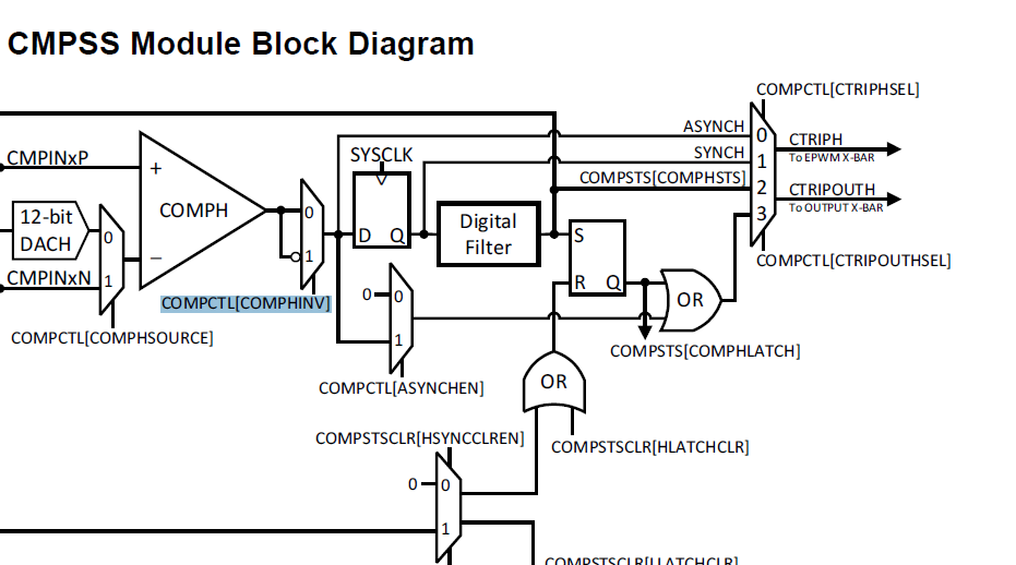

hello Community,
What I got:
At the moment I got a working Peak-Current with slope-compensation.
The PWM starts (ON) at the beginning of the PWM-period with a CounterCompare.
The Off-Switching happens when the meausred Signal is same or higher the Comparator-Value. Positive-Pin is the measured external signal and the Negative Pin is feed by DAC-Output. The DAC-Value is configured with the internal Ramp-Generator. (At the Beginning of the PWM-Period is a fine working blanking-window)
Until now the Comparator-Sts is sychron read and feed through x-bar and so into Trip-Zone as a CBC-Event.
I noticed, that my DIGITAL FILTER right after the comparator is not working. I need this Filter to avoid peaks from 2nd switching device.
What I want:
I read, that I have to configure this
Cmpss1Regs.COMPCTL.bit.CTRIPHSEL = CTRIP_SYNCH
to this
Cmpss1Regs.COMPCTL.bit.CTRIPHSEL = CTRIP_FILTER;
or this
Cmpss1Regs.COMPCTL.bit.CTRIPHSEL = CTRIP_LATCH;
to use the right output of the digital Filter.
For some unkown reason the Switching-Off not happen often enough. The picture in this post shows it. Every PWm-Period should the PWM switch off at the same ponit, but nothings happen.
Channel1 (yellow) -PWM2A
Channel3(blue)-The input-Signal for the Comparator
Channel4(green)-PWM7A -shows the Beginnning of a new PWM-period and covers the on the ON-Time the Blanking-Window
After The Green-PWM rises the DAC produces 3,3V-Output and this falls until a new PWM-period stars to 1,66V

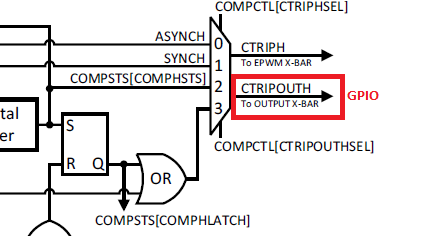

  • Hi Basti,
    I'll be glad to help. Not exactly clear on what you want to happen and what you think is happening. The CMPSS is designed to work well with the EPWM but since the EPWM is it's own complicated module, it's usually a good idea to scope signals going into the EPWM from the CMPSS in order to isolate where the problem might lie.
    So keep your code configuration the same and add this: Cmpss1Regs.COMPCTL.bit.CTRIPOUTHSEL = CTRIP_FILTER. You will also need to configure the OUTPUTXBAR to route it to a GPIO. If you need help on how to route the CMPSS output directly to the GPIO, you can follow the example "cmpss_asynch_cpu01.c" in C2000Ware.
    Basically, i want you to send the same CMPSS output to both the EPWM and GPIO. Plot the GPIO output on the scope and this should make things a little more clear.
    thanks for this fast Response.
    This is really good tip for testing. (I would like to vote for this comment with ++.)
    Tomorrow I will test it.
    (I want to avoid Filter-Results at the End of the PWM, that influences the next PWM.) At the picture 2 of 5 PWMs switch OFF because the Compartor (inkl. decremting Ramp) fill the Filter with enough high Samples. These trips a Event that shutdown the PWM.
    3 of 5 PWMs never switched OFF and I guess this is a Problem with reseting the latch or PWM-Sync don´t work. Or something else....
    Without using the Filter all works fine and every PWM switched at the same Time in each cycle.
    I want to understand how I can get the same result by collecting Samples (for avoiding peaks in Voltage and current) before the Trip-Event happens.
    Would this Code be suitable?
    Cmpss1Regs.COMPCTL.bit.CTRIPOUTHSEL = CTRIP_FILTER; //Filter-STS to Output
    OutputXbarRegs.OUTPUT3MUX0TO15CFG.bit.MUX0 = 0; //Link CTRIPOUTH and OutputXBAR3
    OutputXbarRegs.OUTPUT3MUXENABLE.bit.MUX0 = 1; //Enable OutputXBAR3 Mux
    GPIO_SetupPinMux(15, 0, 1); //PIN15,CPU1,MUX-PIO-Option is 1
    Regards Basti

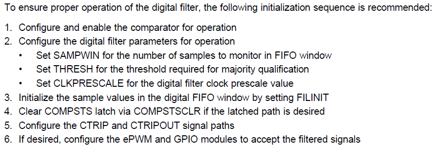

    It would also be good to compare your CMPSS Digital Filter initialization sequence against the TRM recommendation:
    -Tommy
  • Hello tlee,
    I used the TRM recommendation to config, but under point 4, there is for me too less information to handle it right.
    The behaviour of the RAMP and the genereal CMPSTS at different events for me is not clear. PWM-Sync should reset both, but the DIGITAL Filter have to run some cycles to produce a low Output (run out of high Samples)and so on...
    How and when to reset the LATCH of CMPSTS right and whats happend in the crossing of PWM END and START in Combine with a Blanking-Window....
    Regards Basti
  • Basti,
    To clear COMPSTS during initialization, you can reset the RAMP generator by setting the DACSOURCE bit.
    For clearing COMPSTS during operation, I would encourage you to see the CMPSS advisories in the errata in case you are experiencing a known issues.
    -Tommy

  • Basti,
    I have looked through your attached code. The code you have that enables the comparator output on GPIO is not correct. The code below should work.
    OutputXbarRegs.OUTPUT3MUX0TO15CFG.bit.MUX0 = 0; // Setup MUX0 as CMPSS1.CTRIPOUTH
    OutputXbarRegs.OUTPUT3MUXENABLE.bit.MUX0 = 1; // Enable MUX0
    GPIO_SetupPinMux(14,GPIO_MUX_CPU1,6); // Setup GPIO14 as OutputXbar3
    Also, the filter initialization sequence you have is not correct. As Tommy highlighted, this is important to follow so filter behavior will be as expected. To correctly initialize the filter, you can easily follow the initialize sequence done in the "cmpss_digital_filter_cpu01" example in C2000Ware.

  • Basti,
    You are initializing the filter before it is configured.
    Cmpss1Regs.CTRIPHFILCTL.bit.FILINIT = 1; should be called after the filter is configured. Also, you should make filter initialization code the last CMPSS configuration code. What i mean by this is, lines 8 to 12 should be relocated to after RAMPGEN is configured.
  • Hi Frank,
    thanks for this helpful reply!
    I will test this as fast as possible, for me it was not apparent that the these steps have to take in this discret order. Thanks!
    Now I get it.
    Basti
  • Basti,
    Because the filter has memory, initialization sequence is important. It might not be where your problem lies but let us know what you find from the test.
