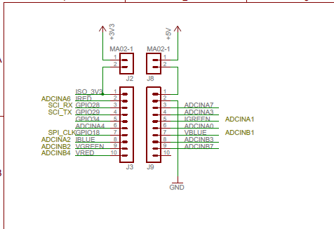

  • Hello Matt,
    I was trying to understand the code from BOOSTXL-C2KLED 2p2z connections, say boost 1 (BLUE):
    // Boost 1 connections
    ADCDRV_1ch_Rlt1 = &AdcNetBus[1];
    CNTL_2P2Z_Ref1 = &IrefNetBus1; // point to Iref1
    CNTL_2P2Z_Fdbk1 = &AdcNetBus[1]; // point to Iout1
    CNTL_2P2Z_Coef1 = &CNTL_2P2Z_CoefStruct1.b2; // point to first coeff of 1st loop
    CNTL_2P2Z_Out1 = &UoutNetBus1; // point to 2P2Z Uout1
    PWMDRV_2ch_UpCnt_Duty1A = &UoutNetBus1;
    The feedback is coming from the current sense resistor voltage multiplied by the gain of the OPAmp to the ADC, IBLUE (ADCINA2) .
    Say later on, still using BOOSTXL-C2KLED, I will make a boost conv with feedback coming from the voltage divider VBLUE (ADCINB1), of course my K will change accordingly.
    But how do I redirect AdcNetBus to get the "new" feedback from IBLUE (ADCINA2) to VBLUE (ADCINB1)?

  • Hello Matthew,
    Thanks for the answer. I just thought so too, changing and redirecting by ChSel[x].
    I did the same when I convert the firmware for TMDSRGBLEDKIT firmware but still using BOOSTXL-C2KLED hardware as I asked in the link below.
    As I thought the software is modifiable and able to adapt on a certain hardware.
    e2e.ti.com/.../2483841
    I was trying to use the firmware of TMDSRGBLEDKIT
    C:\ti\controlSUITE\development_kits\Multi-DCDC-Color-LED-Kit_v1.0\LED-ColorMix_v1_0
    on my BOOSTXL-C2KLED.
    Open loop is working and can light the GREEN or RED LED but when I close the loop, I cannot seem to lit GREEN led. BTW, the BLUE LED seems to be spoilt already.

    few questions:
    1. why is B3 on both firmware different? 11 vs 12
    2. can I swap ADC channels? since the GREEN on BOOSTXL-C2KLED is using A1 while in TMDSRGBLEDKIT A1 is used for Iout4. It seems to work on RED LED but not on GREEN.

  • Victor,
    I noticed there is a similar dialogue on this thread https://e2e.ti.com/support/microcontrollers/c2000/f/171/p/666638/2483841#2483841.  It looks like we are coming to the same conclusions(I spoke with Brett as well).
    As he mentioned the physical connections on the BOOSTXL-C2KLED are different than the RGBLED KIT.  I can say that the ChSel[11] = 12 for the BOOSTXL-C2KLED is correct, the comment is what is wrong here.  VRED(Vout3) is on ADCINB4(see below schematic capture) on that PCB so value of "12" for the channel is correct for ADCINB4.  On the RGB kit it was ADCINB3, hence the 11 for that PCB.
    For the above for the I and V that do exist this looks correct.  Note that on the BOOSTXL-C2KLED Iout4, 5, 6 don't exist in HW and are not connected to any analog pins of the F28027 device.  My point being there is no need to sample those channels as they are floating.  I would not enable the triggers(leave as "0" vs the "5") for the float channels to save ADC sample time.
    I assume for the GUI interactions there may be differences as well that are causing your issues you'll need to examine the code.
    Matthew
