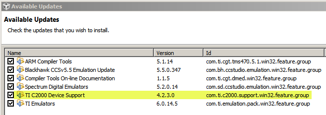

    I hear that you are having trouble creating a new CCS target configuration for the controlCARD. Many of the TMS320F28004x devices were added to CCS in December. Can you check for CCS updates to see if you have an update available for TI C2000 Device Support? Launch the check from the Help Menu >> Check for Updates.
    If the update installs correctly, you will be able to see the F28004x devices when you create a new target configuration.  You will also be able to see the source files in your CCS device support directory: \ti\ccsv7\ccs_base\common\targetdb\devices\

  • I tried that several times. I always get message saying no new updates found.
    I did try the following: I went to the XDS100v2 in the config menu, and then typed in "F280049M" and then did a SAVE & Test. It seemed to work, but when I tried to run debug, i still get error message "...can't connect to target". To reiterate, I purchased the C2000 Microcontrollers Development Tool, "TMDXDOCK280049M". I downloaded and installed CCS version 8 (the latest version). I also downloaded the C2000 suite.
