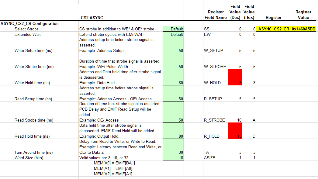

    i have used the (excel file to calculate EMIF values) tool to update the Setup, Strobe and Hold timings. Please find the observation below.
    As per the FPGA,
    Write Setup Time, Write Strobe Time, Read Setup Time, Read Strobe Time is 50nsec.
    Write Hold time, Read Hold Time is 80nsec.
    Please find details below:
    Where, Write & Read Hold time are going more than the bit field limit (R_HOLD, W_HOLD are 3bit range 0-7). So, i have opted to use W_HOLD & R_HOLD values to 7h. Which is less than expected. Same for TA.
    However, I am using the below calculations for SETUP, STROBE, HOLD & TA timings
    R_SETUP/W_SETUP = SETUP * fEM1CLK -1
    50ns *100 MHz -1 = 5-1 =4
    R_STROBE/W_STROBE =  STROBE * fEM1CLK -1
    R_HOLD/W_HOLD = HOLD *  fEM1CLK -1
    80ns * 100 MHz -1 = 7
    Where  fEM1CLK  is 100MHz.
    Please suggest me the impact by using the values which is less than calculated value. Please suggest me an alternate to resolve this?
    I have captured the FPGA Read Write Timings, Please find details below. The Blue color marked is the "additional 38-50ns before end of STROBE time". Which means FPGA is already providing an extra STROBE time.
    Unfortunately, we don't have provision to change FPGA timings (Limitations).
    Is this timing can impact on data loss? Suggest me any possible solution to over-come this timing. Any suggestions greatly appreciable.

  • Chandra,
    TA will not help you much unless the FPGA has a response time limitation for recognizing back-to-back operations.
    Can you use a larger STROBE value?  The data is expected to be valid at the end of the STROBE period, and the STROBE register field is 6-bits wide so you can have up to (63+1) cycles of delay for the data bus to be valid.  That should be more than enough based on your wave forms.
    I am not able to tell which of your signals is FPGA-input or FPGA-output so please help to clarify that if increasing STROBE is not helpful.
    -Tommy
  • Hi Tommy,
    We have solved the issue. There is no issue regarding FPGA-EMIF. It is internal bug, we have cleared.
