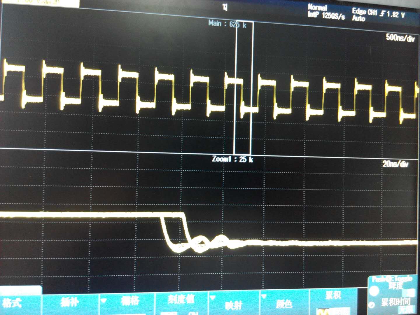

Customer is using F28004x for their digital power application.
Now we have a issue based on our HRPWM demo code (from C2000ware). If we adjust these points, the PWM output duty will be not stable, 10ns difference, that's one PWM clock difference between each duty.
1) Fix the TBPRDHR with a value: (*ePWM[i]).TBPRDHR = 100<8;
2) Fix the TBPRD with a value: 1000;
3) UpDown mode;
4) Shadow load when HR_CTR_ZERO.
5) Fix CMPA with a value: 200;
6) Fix CMPAHR with a value: 100.
In this case, the duty one PWM clock varies. If we change the load mode from HR_CTR_ZERO to HR_CTR_ZERO_PRD, there's no this issue.
In all of these cases, HRPWM can output successfully.
We'd like to know, why in HR_CTR_ZERO mode, the duty can't be stable, but with one PWM clock difference between each duty.
Thanks a lot.

  • Just to clarify, the PWM duty cycle varies by 10ns from one period to the next? Can you provide oscilloscope images?
  • Yes, I can.
    If you do a test on our EVM, you will find, too.
    Thanks a lot.
    Br, Jordan
  • By evm you mean the F280049 Control Card?
    Can you also tell me which example code you are basing this on?
  • Here's the code:C:\ti\c2000\C2000Ware_1_00_04_00\device_support\f28004x\examples\hrpwm
    Actually there's only one HRPWM demo code.
    Here's the oscilloscope:
    Br, Jordan

    The load needs to occur on both ZRO and PRD. And you double check with this and let me know if this fixes the issue. I believe this is necessary.
    Yes, you are right.
    If the load mode is HR_CTR_ZERO_PRD, there's no this issue.
    But if the load mode is HR_CTR_ZERO, there's the issue.
    We'd like to know why.
    Thanks a lot.
    Br, Jordan
  • Jordan,
    That's correct - you need to use HR_CTR_ZERO_PRD for this mode.
    The high resolution values are calculated internally and loaded on both Zero and prd match instances.
    For the new values to take effect at both these instances, you need to use this mode.
    Note that these values change internally for correct operation - though there is no change from user.
    -Bharathi.
