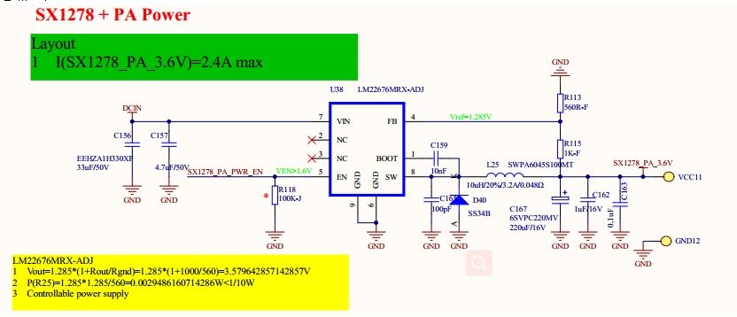

Part Number: LM22676
In the above circuit, Short circuit occurred in VIN pin and SW pin at the beginning of test, which has not happened before.What was the cause?Is there a problem with the LM22676 or with the testing process?
