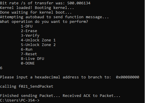

I have been using tms320f2837xS launcpad.I selected SCI boot mode. When cmd terminal interface is sent the run packet, I try to achieve jump to application by branch to entrypoint.then I expecxted run blinky application.but it did not run! I used hex2000 for out file format to asci hex format. Like this:

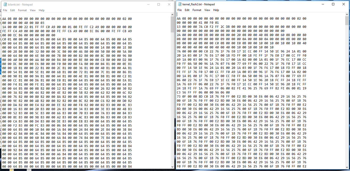

C:\ti\ccs810\ccsv8\tools\compiler\ti-cgt-c2000_18.1.2.LTS\bin\hex2000.exe -boot -a -sci8 C:\ti\c2000\C2000Ware_1_00_02_00\device_support\f2837xs\examples\cpu1\blinky_with_DCSM\cpu01\ccs\CPU1_RAM\blinky_with_dcsm_cpu01.out -o C:\Users\PC-354-\Desktop\bilenki_yeni.txt
C:\ti\ccs810\ccsv8\tools\compiler\ti-cgt-c2000_18.1.2.LTS\bin\hex2000.exe -boot -a -sci8 C:\ti\c2000\C2000Ware_1_00_02_00\device_support\f2837xs\examples\cpu1\F2837xS_sci_flash_kernel\cpu01\ccs\CPU1_RAM\F2837xS_sci_flash_kernel.out   -o C:\Users\PC-354-\Desktop\kernel_flash2.tx
   t

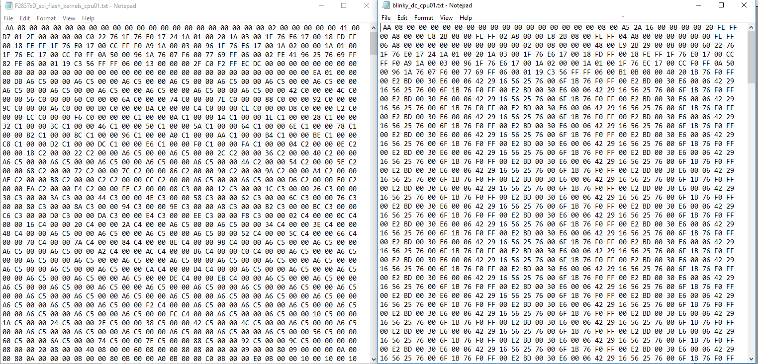

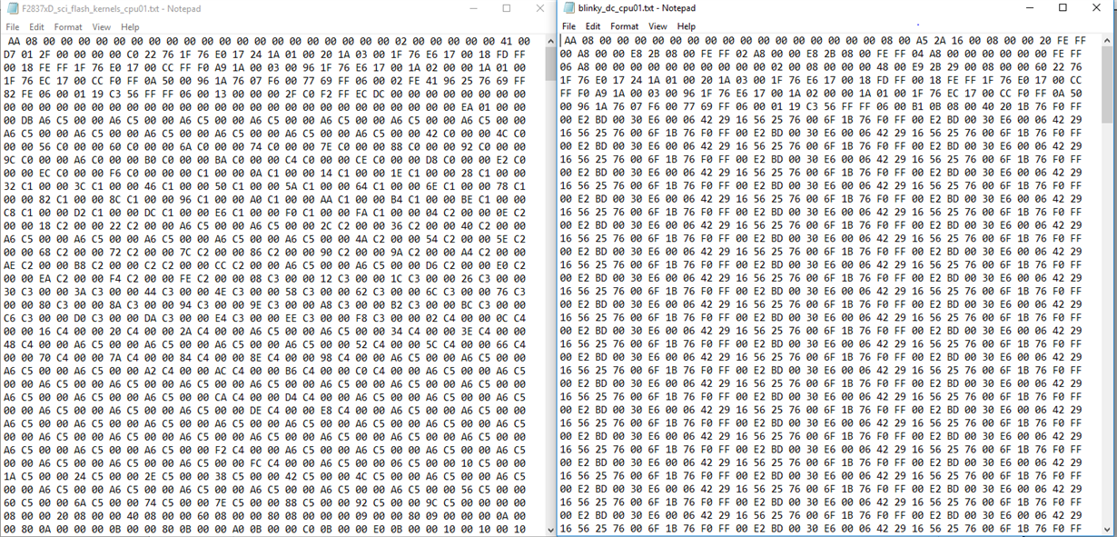

it is not the same Orijinal kernel.txt and blinky.txt hex format.The number of column doen not match yours.Do you have any problem?
Orginal_hex(C:\ti\c2000\C2000Ware_1_00_05_00\utilities\flash_programmers\serial_flash_programmer\f2837xD_fw_upgrade_example):

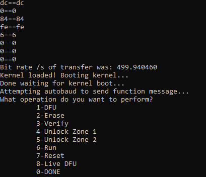

then C:\ti\c2000\C2000Ware_1_00_05_00\utilities\flash_programmers\serial_flash_programmer\serial_flash_programmer.exe  -d f2837xS -k C:\Users\PC-354-\Desktop\kernel_flash2.txt  -a C:\Users\PC-354-\Desktop\bilanki.txt -p COM6    -b 4800  -v
if I select DFU
but waiting in the  last step without endlessly.I dont know why this happened!
İf I select run:
I can not see any action when I select run option!

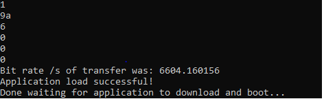

  • thanks for helping,
    It is working well blinky application when run packet is sent .After application code was dowload via the C2Prog on SCI mode.
