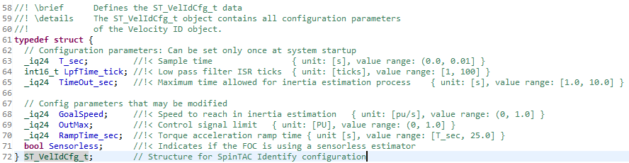

    From Table 3-12 in the InstaSPIN-FOC User's Guide, it looks like OutPos is a member of the 'cfg' type member in the ST_VelId_t structure for SpinTAC identfiy. That said, when I look at the ST_VelIdCfg_t type which is the defined type for 'cfg,' there is no OutPos member of that struct.
    In "spintac_vel_id.h" we see
    of which GoalSpeed is the only config parameter that I believe would correlate to the OutPos function. You could also try manipulating the 'Out' member of the ST_VelCtl_t type, which is defined as the control output between [cfg.OutMin, cfg.OutMax], similar to how OutPos and OutNeg function per their description in Table 3-12
    My suggestion would be manipulating GoalSpeed and Out in an effort to fix error 2004 during the identify process in lab12a
