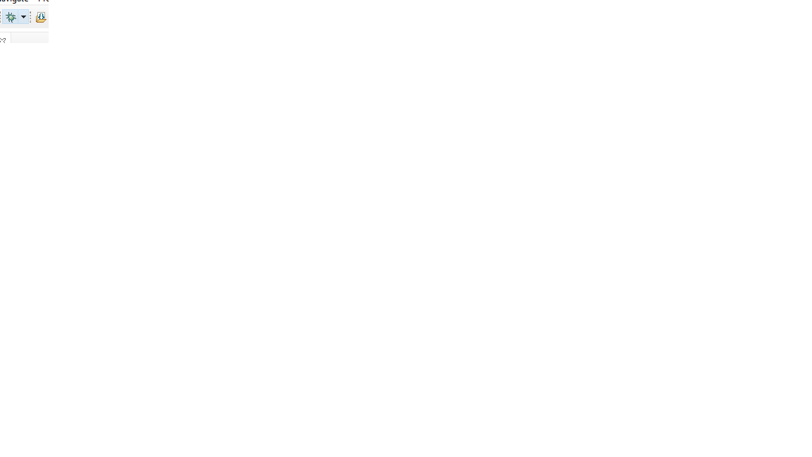

  • Hi Ozino,
    Thank you for your time and pointing me to the C2000ware examples, as it can narrow down the issues.
    I downloaded the C2000ware, and repeat my experiment with one of the examples.
    4.14 ePWM Timer Interrupt (epwm_timer_interrupts)
    Project name: Example_2833xEPwmTimerInt, from the directory: C:\ti\c2000\C2000Ware_1_00_05_00\device_support\f2833x\examples\epwm_timer_interrupts.
    Here is my experiment with F5 and F8. I did not change anything in the example code.
    (1) double click to the left of the ISR of ePWM1 interrupt (line 328, Example_2833xEPwmTimerInt.c) to create a break point.
    (2) start debugging by clicking the button in the following picture.
    (3) by pressing F8, it stops at the break point. Repeat, it always stops at the break point. It is the expected behaviour.
    (4) keep pressing F5, after it finishes the ISR, it is always in the forever loop below. Even if the ePWM1 counter becomes 0 again, after it reaches the peak. (It takes a while). Nor it will enter any other ISRs for other ePWM modules.
        // Step 6. IDLE loop. Just sit and loop forever (optional)
        for(;;)
            __asm("          NOP");
            for(i=1;i<=10;i++)
    (5) if you press F8, it enters the ISR and stops at the break point as expected.
    Clearly, F8 is working properly, but F5 is not.
    My questions is, according to my understanding, F5 is used when I want to execute the code line by line. Using F5 in the above way, it should go back into the ISR when the time has come. But in my experiment, it is not. Is there any setting I have missed, or I should not use F5 in this way?
    As I have explained before, I try to use F5 in this way, because I want to see in my project, why it takes 900 cycles to enter an ISR.
    I am using CCS8.2 and TI F28335 experimental kit.
