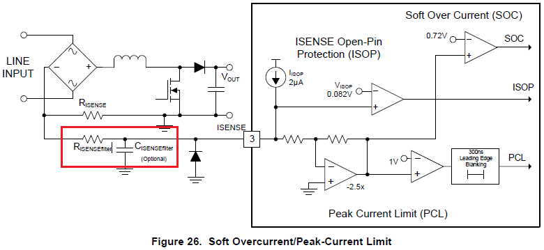

The datasheet recommends 220ohm for RISENSE_filter.
Is it no ploblem if we use more than 220ohm?
My customer wants to adjust CISENSE_filter value because of short supply.
Yaita
  • Hello Yaita,
    The purpose of RISENSE and CISENSE is to filter out any noise spikes from the low level current signal on the current sense pin input , ISENSE.
    Normally RISENSE is set at 220 Ohms and CISENSE is set at 1000pF. This gives you a time constant of about 0.22uSecs.
    If you keep the RC time constant approximately the same then there will not be a problem.
    For example you can make RISENSE = 330 Ohms and CISENSE = 660pF.
    Do you know what value of resistor your customer is planning to use ?
    John

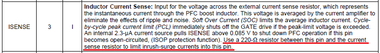

    The datasheet shows 1000pF for CISENSE as the following.
    (datasheet page 28)
    To protect the device from inrush current, a standard 220-Ω resistor, RISENSE, is placed in series with the ISENSE pin.
    A 1000-pF capacitor is placed close to the device to improve noise immunity on the ISENSE pin.

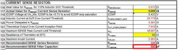

    On the other hand, Design Calculator recommends calculated value (not fixed value).
    Which is recommended value 1000pF or the value calculated by Design Calculator?
    Yaita
  • Hi Yaita-san,
    Please use a value close to the recommended value in the calculator tool. In this case use 680pF
    John
  • Hi John-san,
    Thank you for your support. I understand.
