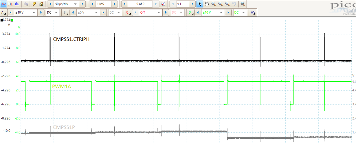

  • Hi Frank,
    Thank you for the information, I know the reason why CMPSS1.CTRIPH/CMPSS1.CTRIPOUTH only
    remains high for a short time. But The issue is: CMPSS1.CTRIPH is used as PWM1 DCAEVT2
    (TRIP4 is active high), PWM1A should take trip action until the end of PWM period when
    CMPSS1.CTRIPH becomes high, but from PWM1A's waveform, it only remains high when CMPSS1.CTRIPH
    is high, and it goes to low when CMPSS1.CTRIPH goes low(see the picture below). Can you find
    any wrong setting at the following initialization code?

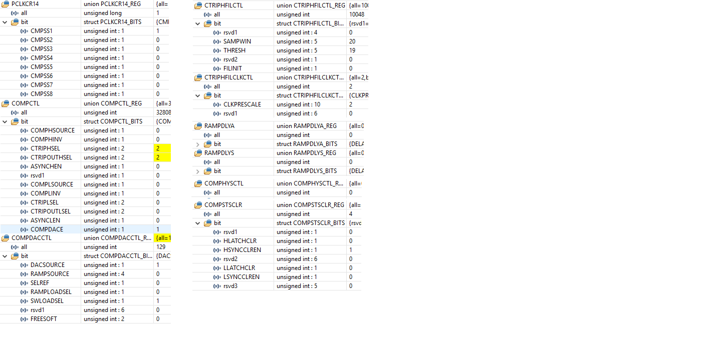

    // Compartor 1 initialization
    EALLOW;
    CpuSysRegs.PCLKCR14.all |= 1; // enable clock to CMPSS1
    Cmpss1Regs.COMPCTL.bit.COMPDACE = 1;
    Cmpss1Regs.COMPHYSCTL.bit.COMPHYS = 0;
    Cmpss1Regs.COMPDACCTL.bit.RAMPSOURCE = 0; // Sync. to PWM1
    Cmpss1Regs.COMPDACCTL.bit.RAMPLOADSEL = 0;
    Cmpss1Regs.COMPDACCTL.bit.SWLOADSEL = 1;
    EDIS;
    // Set Comparator DAC voltage reference
    EALLOW;
    Cmpss1Regs.COMPDACCTL.bit.SELREF = vRef; // use VDDA
    EDIS;
    // Initialize comparator1 high side
    EALLOW;
    Cmpss1Regs.COMPCTL.bit.COMPHSOURCE = 0; // Compare to internal DAC
    Cmpss1Regs.COMPCTL.bit.COMPHINV = 0; // do not invert the result
    Cmpss1Regs.COMPCTL.bit.CTRIPOUTHSEL = 2; // Use digital filter result
    Cmpss1Regs.COMPCTL.bit.CTRIPHSEL = 2; // Use digital filter result
    Cmpss1Regs.COMPCTL.bit.ASYNCHEN = 0;
    Cmpss1Regs.COMPSTSCLR.bit.HSYNCCLREN = 1;
    EDIS;
    // Set digital filter, window:0.2us, 95%
    EALLOW;
    Cmpss1Regs.CTRIPHFILCLKCTL.bit.CLKPRESCALE = 2;
    Cmpss1Regs.CTRIPHFILCTL.bit.THRESH = 19; // 19 of 20
    Cmpss1Regs.CTRIPHFILCTL.bit.SAMPWIN = 20;
    Cmpss1Regs.CTRIPHFILCTL.bit.FILINIT = 1;
    EDIS;
    // Initialize Ramp generator
    EALLOW;
    Cmpss1Regs.COMPDACCTL.bit.DACSOURCE = 1; // use ramp
    EDIS;
    Cmpss1Regs.RAMPDLYS.bit.DELAY = 0;
    Cmpss1Regs.RAMPDECVALS = 2;
    // Pwm X-Bar initialization: CMPSS1.CTRIPH as TRIP4 input
    EALLOW;
    EPwmXbarRegs.TRIP4MUX0TO15CFG.all &= ~0x3UL;
    EPwmXbarRegs.TRIP4MUX0TO15CFG.all |= 0; // Set CMPSS1.CTRIPH as TRIP4 input
    EPwmXbarRegs.TRIP4MUXENABLE.all |= 1; // enable that mux input
    EDIS;
    // Pwm X-Bar TRIP4: do not invert
    EALLOW;
    EPwmXbarRegs.TRIPOUTINV.all &= ~1UL; // do not invert
    EDIS;
    // Output X-Bar initialization: CMPSS1.CTRIPOUTH as OUTPUT1 input
    EALLOW;
    OutputXbarRegs.OUTPUT1MUX0TO15CFG.all &= ~0x3UL;
    OutputXbarRegs.OUTPUT1MUX0TO15CFG.all |= 0; // Set CMPSS1.CTRIPH as OUTPUT1 input
    OutputXbarRegs.OUTPUT1MUXENABLE.all |= 1; // enable that mux input
    EDIS;
    // Output1 initialization
    EALLOW;
    OutputXbarRegs.OUTPUTINV.all &= ~1; // do not invert
    OutputXbarRegs.OUTPUTLATCHENABLE.all &= ~1; // do not use latch
    EDIS;
    // Set GPIO24 for Output X-Bar OUTPUT2
    // PWM1 initialization
    EALLOW;
    CpuSysRegs.PCLKCR2.all |= 1; // Enable PWM1 clock
    EDIS;
    EPwm1Regs.TBCTL.all = 0x0000;
    EPwm1Regs.TBCTL.bit.CTRMODE = TB_COUNT_UP;
    EPwm1Regs.TBCTR = 0x0000;
    // Set GPIO0/GPIO1 to PWM
    // Set PWM1A action mode
    EPwm1Regs.AQCTLA.all = 0x0000;
    EPwm1Regs.AQCTLB.all = 0x0000;
    EPwm1Regs.AQCTLA.bit.ZRO = AQ_SET; // for up count sawtooth
    EPwm1Regs.AQCTLA.bit.CAU = AQ_CLEAR;
    // Set PWM1B as complementary of PWM1A
    EPwm1Regs.AQCTLB.bit.ZRO = AQ_CLEAR; // for up count sawtooth
    EPwm1Regs.AQCTLB.bit.CAU = AQ_SET;
    EALLOW;
    EPwm1Regs.HRCNFG.all = 0; // Reset HRPWM setting
    EDIS;
    // Set PWM1 dead band
    EPwm1Regs.DBCTL.all = 0;
    EPwm1Regs.DBCTL.bit.HALFCYCLE = 1;
    EPwm1Regs.DBCTL.bit.IN_MODE = 0; // PWMxA as the source of rising edge and PWMxA as the source of falling edge
    EPwm1Regs.DBCTL.bit.POLSEL = dbType;
    EPwm1Regs.DBCTL.bit.OUT_MODE = 0x03;
    EPwm1Regs.DBRED.bit.DBRED = 0;
    EPwm1Regs.DBFED.bit.DBFED = 0;
    // Set PWM1 interrupt type
    EPwm1Regs.ETPS.bit.INTPSSEL = 1;
    EPwm1Regs.ETINTPS.bit.INTPRD2 = 1;
    EPwm1Regs.ETSEL.bit.INTSEL = 0x004; // int on CMPA/C up count
    EPwm1Regs.ETSEL.bit.INTSELCMP = 1; // use CMPC
    EPwm1Regs.CMPC = 0; // Set interrupt position to the beginning of PWM period.
    // Set PWM1 interrupt vector
    EALLOW;
    PieVectTable.EPWM1_INT = Task;
    PieCtrlRegs.PIEACK.all = PIEACK_GROUP3;
    PieCtrlRegs.PIEIER3.all |= 1;
    IER |= M_INT3;
    EPwm1Regs.ETCLR.bit.INT = 1;
    EPwm1Regs.ETSEL.bit.INTEN = 1;
    EDIS;
    // Set PWM1 trip action
    EALLOW;
    EPwm1Regs.TZCTL2.bit.ETZE = 0;
    EPwm1Regs.TZCTL.bit.TZB = 1; // force high to PWM1B
    EPwm1Regs.TZCTL.bit.DCBEVT1 = 1; // force high to PWM1B
    EPwm1Regs.TZCTL.bit.DCBEVT2 = 1; // force high to PWM1B
    EPwm1Regs.TZCTL.bit.TZA = 2; // force low to PWM1A
    EPwm1Regs.TZCTL.bit.DCAEVT1 = 2; // force low to PWM1A
    EPwm1Regs.TZCTL.bit.DCAEVT2 = 2; // force low to PWM1A
    EDIS;
    // Start PWM1
    EALLOW;
    EPwm1Regs.TZCLR.bit.OST = 1;
    EDIS;
    // Set DC event
    EALLOW;
    EPwm1Regs.DCAHTRIPSEL.all = 8;
    EPwm1Regs.DCALTRIPSEL.all = 0;
    EPwm1Regs.DCTRIPSEL.bit.DCAHCOMPSEL = 0xF;
    EPwm1Regs.DCTRIPSEL.bit.DCALCOMPSEL = 0xF;
    EPwm1Regs.TZDCSEL.bit.DCAEVT2 = 2;
    EPwm1Regs.DCTRIPSEL.all = 0xFFFF;
    EDIS;
    // PS_PwmSetDcEvtFilter
    EALLOW;
    EPwm1Regs.DCACTL.bit.EVT1SRCSEL = 1;
    EPwm1Regs.DCFCTL.bit.SRCSEL = dcFltApply;
    EPwm1Regs.DCFCTL.bit.BLANKE = 0;
    EDIS;
    // DAC innitialization
    EALLOW;
    CpuSysRegs.PCLKCR16.all |= 1UL << 16; // enable clock to module
    DacaRegs.DACCTL.bit.SYNCSEL = 0; // Set Sync. PWM to PWM1
    DacaRegs.DACCTL.bit.LOADMODE = 1;
    DacaRegs.DACOUTEN.bit.DACOUTEN = 1; // enable DAC output
    EDIS;
    // Set DAC voltage reference to
    EALLOW;
    DacaRegs.DACCTL.bit.DACREFSEL = 1; // Set DAC-A's voltage reference to ADC VREFHI/VREFLO
    EDIS;
    // Start PWM1 clock
    EALLOW;
    CpuSysRegs.PCLKCR0.bit.TBCLKSYNC = 1; // Enable TBCLK after all ePWM setting
    EDIS;

    I have also checked all register values, they are same as the code set (except the value of
    Cmpss1Regs.CTRIPHFILCTL.bit.FILINIT is 0, but I think it is cleared by CPU).
    I took some register snapshots as below,
    thank you very much!
    Jiakai
