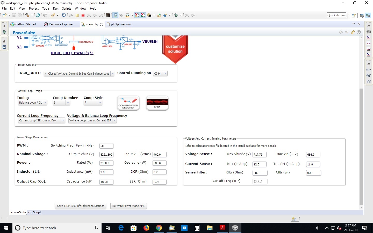

  Sir, we did booted the MCU in Get Mode (Flash by default). we powered up the module on 400Vac, 50Hz. and we had getting an output voltage of 612Vdc. and output voltage was gradually decreasing. we are attaching copy of main.cfg page and expression view for your reference. In the expression view, we observed board status showing as in Over Current Trip. We are testing the module on NO LOAD CONDITION only.we are usingTMSCNCD28379D. We bought this module and control card from Mouser. Please help me to solve this issue.

    d) HOWEVER, BUILD 4 WAS GIVING AN ERROR AFTER 1 TO 2 SEC AND INDICATING “BUS IMBALANCE TRIP” AS BOARD STATUS, VOLTAGE IS NOT BUILDING TO 600V AS INDICATED IN MANUAL AND POWER FACTOR IS NOT GETTING CORRECTED(IMAGE SCREEN SHOT ENCLOSED)

  • Please find the below attachment. Module started functioning in build4 under following conditions:
    Output voltage limit is set to 500VDC and the input voltage raised to 208VACL-L slowly and applied clear trip module is functioning.
    However the module is failing under following conditions :
    a) Voltage is directly applied without slowly raising module is failing to deliver and indicating "OVER CURRENT TRIP".
    b) Output voltage is set to 600VDC whether input voltage is slowly applied or instantaneously applied module is failing to deliver and indicating "BUS IMBALANCE TRIP".
    Please suggest.
  • What happens when you have it working at 500V and then raise the bus voltage reference ? does it trip again?
    Also how much load do you have connected to the output when you do these experiments?
  • We increased the Bus Voltage to 600VDC and again it is tripped. 530 Ohms Load we connected to the output to do these experiments.
