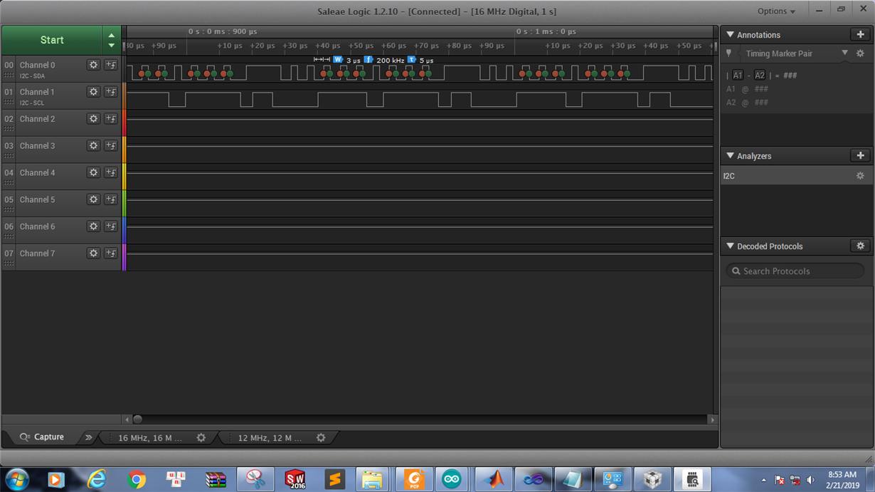

  • Do you have an oscilloscope or logic analyzer or something you could use to look at the activity on the I2C signals to see what it's managing to send?
    Whitney
  • This is what I get when analyze I2C read function. I dont have much experience using logic analyzer. Is there any problem with SDA signal ?
  • Updated:
    Now the program successfully jumped into I2C_INTSRC_REG_ACCESS_RDY, but sometimes it still stuck at the while(I2C_getStopConditionStatus(base)!=0) (the second one). sometimes it passed through but I could not get any data to the data buffer. Is it really necessary to get data inside I2C_INTSRC_STOP_CONDITION ISR as the example did ?
  • Another thing is that in each read function, the program jump into ISR 4 times. 2 times for I2C_INTSRC_STOP_CONDITION and 2 times for I2C_INTSRC_REG_ACCESS_RDY. Is it reasonable ?
  • Hi Minh,
    Your signals look fine, but you're SDA and SCL channels are reversed on your Saleae software. Also I suggest making the display setting "Hex" by clicking the cog wheel next to I2C on the right side of the pane. That will make it a lot easier to understand.
    Kevin
