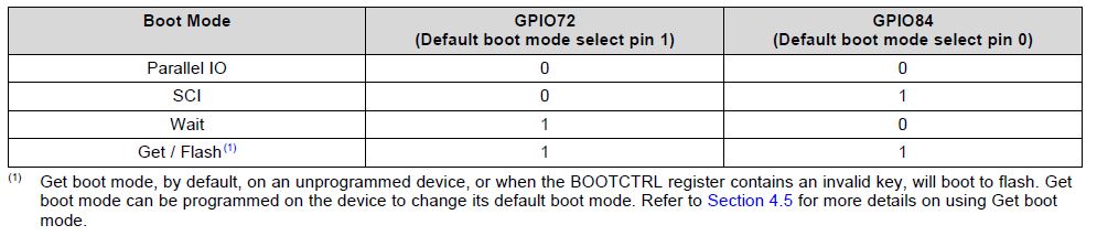

I am interested in upgrading the device firmware in the field and I know I can do it through the SCI port as follows:
where the Firmware Update decision is being taken by reading pins GPIO72 and GPIO84 as shown in the following table:
and setting BOOTCTRL register to 0x0B5A.

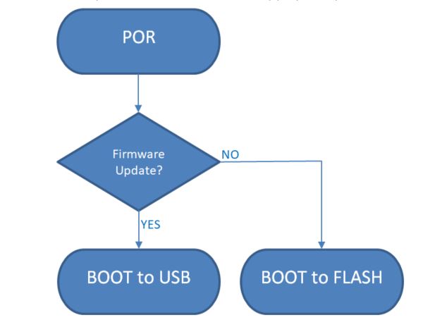

As SCI Firmware Update method is too slow for my purpose, I plan to use USB instead:
Is it possible to do it in an easy way, by reading pins GPIO72 and GPIO84?
