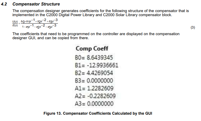

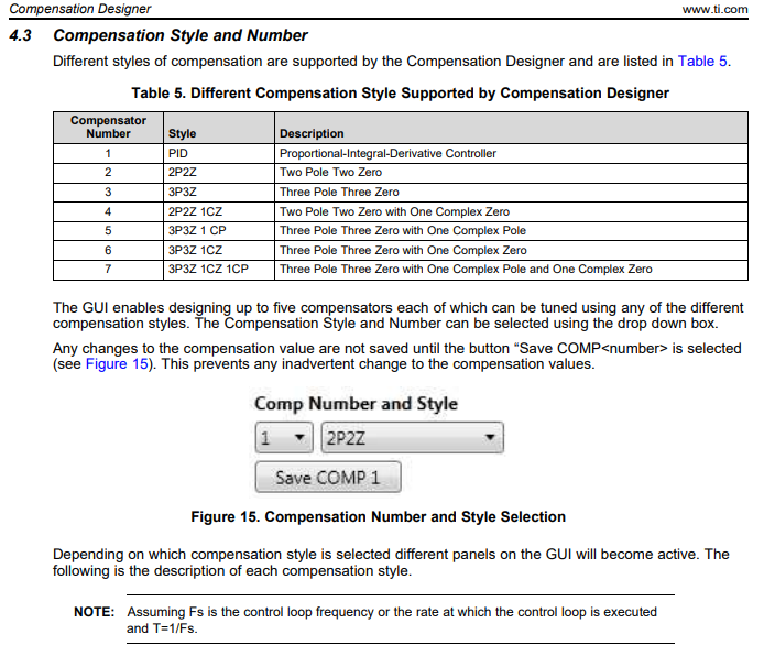

I just purchased this buck converter and LAUNCHSL-F28069M. I am wondering if I could add more coefficients for the compensator. Images below are found in the document whose link is shown also below.
http://www.ti.com/lit/ug/spruhz5a/spruhz5a.pdf
Looks like it can handle up to three pole three zero. Is there any way I can work with four pole four zero??

  • This compensator can have a maximum of 3 pole 3 zeros. This should be enough for a buck converter control. You can create a new 4 pole 4 zero compensator if you need it. The code will change accordingly. But, again we don't see a need for that for a buck converter control.
