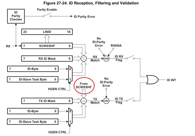

One question about F280049 LIN setting in SPRUI33B.
On below picture, when HGENCTRL = 1, mask = 1 is not used for the filtering criterion.
On table 27-36, when HGENCTRL is set to 1, it must set RXIDMASK to 0xFF.
How to set it? Thanks.

    Thanks for your help. F280049 is slave node, vehicle is master node.
    Customer hope to only receive the frame that is 0xC1 and 0x06, and make response to master when frames is 0x03 and 0x85.
    For other frames, It is filtered and don't to receive.
    The question is how to set TXIDMASK and RXIDMASK separately.
    We find both TXIDMASK and  RXIDMASK will work to filter the frames when working.
    Refer to the below picture, TX also handle the SCIRXSHF register.
    Besides, looking forward more comments about ID-Slave-Task byte configuration later.
  • Hi Daniel,
    From what you described, F280049 acts as a slave node. Based on my understanding:
    - To receive frame 0xC1 and 0x6, you need to set the LINMASK.RXIDMASK = 0xC7
    - To transmit frame 0x85 and 0x3, you need to set the LINMASK.TXIDMASK = 0x86
    - ID-Slave-Task-Byte needs to be set to 0x1 (i.e. LINID.IDSLAVETASKBYTE = 0x1), whose value is same for RX and TX.
    Please try this out and let me know if you still have any questions.
    Nirav
