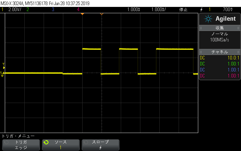

AQCTLA [ZRO] event is not executed when "0" is loaded to TBCTR.
Is this behavior correct?

I checked with the above source code.
AQCTLA [ZRO] event  was not executed when TBCTR = 0 in the interrupt function.
Please let me know if there is a method to execute AQCTLA [ZRO] event when TBCTR = 0.

  • Hi Vasudha-san,
    As I found new information, I add it to the following.
    The AQCTLA[ZRO] event is not executed when "0" is written to TBCTR Reg,
    but this event is executed when "0" is loaded from TBPHS to TBCTR using TBCTL[SWFSYNC](Software Forced Sync Pulse).
    Can you tell why the behavior is different for these two patterns

  • Hi Vasudha-san,
    Thank you for your support.
    The following is the result of my test.
    (1) Test to update TBCTR directly to 0 in program

    (2) Test to update TBCTR to 0 with TBPHS

    In the case of TEST2, the program jumps to ISR on the third rising edge of PWM and the PWM waveform goes low immediately.
    However, in the case of TEST1, the PWM waveform does not fall to Low immediately.

    I think this is some undeterminitic behaviour dur to both hardware and software trying to write to TBCTR.
    I realised that if you give some delay before writing to TBCTR = 0 in ISR, you can see the expected waveform.
    __interrupt void epwm2_isr(void)
        __asm("  NOP");
        __asm("  NOP");
        EPwm2TimerIntCount++;
    //    EPwm2Regs.TBCTL.bit.SWFSYNC = 1;
        EPwm2Regs.TBCTR = 0;
        // Clear INT flag for this timer
        EPwm2Regs.ETCLR.bit.INT = 1;
        // Acknowledge this interrupt to receive more interrupts from group 3
        PieCtrlRegs.PIEACK.all = PIEACK_GROUP3;
    Alternatly you can write TBCTR = 5999 to get similar behaviour.
        EPwm2Regs.TBCTR = 5999;
    I am still debugging this and will get back once I get more information on this.
    Vasudha
  • Hi Vasudha-san,
    Thank you for your support!
    I'll be waiting for your reply.
  • Hi Vasudha-san
    Do you have any update?
    We discussed over this and concluded that making TBCTR = 0 or TBCTR = PRD through software can lead to inconsistent behaviour.
    When the interrupt gets generated. counter is incrementing and when we write TBCTR = 0 or PRD in ISR this leads to counter load with specific value. Since the increment and load are not synchronized with TBCLK much slower than SYSCLK, this leads to inconsistent behaviour wherein counter = 0 is not getting detected by hardware.
    Hence it is better to make counter = PRD - 1, to get consistent behaviour.
    The latter case with SWSYNC works because it is being done by hardware on next TBCLK.
    Let me know if this resolves your query.
    Vasudha
  • Hi Vasudha-san,
    Thank you for your special support!
    I understood the mechanism. I will contact the customer to use PRD-1.
