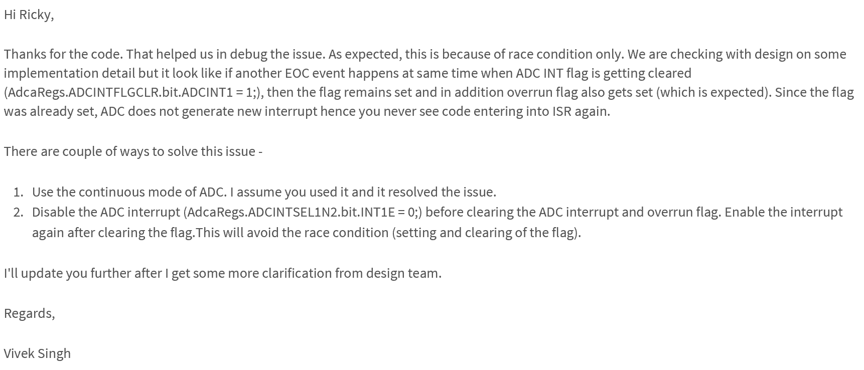

Hi Vivek,
I'd like to ask some question based on this thread: https://e2e.ti.com/support/microcontrollers/c2000/f/171/t/750511?TMS320F280041-F280041-ADC-Interrupt-Overflow-Issue#pi320995=1
Regarding your reply to Ricky, you suggest us to clear INT1E before clear ADC interrupt and ADC INT overflow flag, after that set this bit to high.
Could you help me understanding the reason behind? It do works but I think in this circumstance not ADC INT overflow flag will be set. Is my understanding right?
My customer meet the same problem and would like to know the mechanism.
