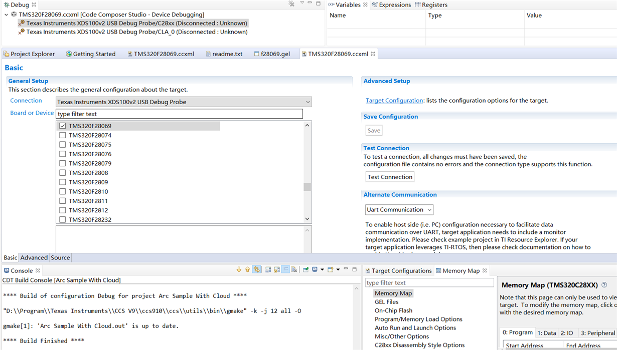

  • First of all, thank you very much for your reply!
    I am using a  custom  board I made myself.It worked fine when it was used before.
    I have checked target configuration,as following:
    when i run 'Test Connection',it can be observed as following:

    2) I am able to detect the XDS100 in device manager
    3)i am sorry for not understanding this question.But my ccs is the latest and XDS100's driver too.
    !!!!!!Now,
    ‘’‘The JTAG DR Integrity scan-test has failed.’‘’ this question has been solved.
    But I have a new problem:
    Error connecting to the target:
    (Error -1041 @ 0xFFFFFF66)
    The debug probe reported an error. Confirm debug probe configuration and connections, reset the debug probe, and retry the operation.
    (Emulation package 8.2.0.00004)
    Please help me!!!
