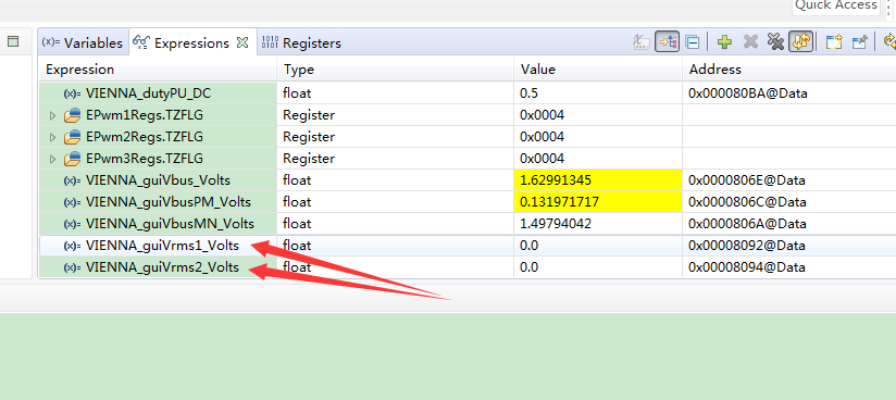

TIEVM-VIENNARECT: VIENNA rectifier communication lights are not bright:A:D3 and A:D4,I dont know if the hardware question or it need configure,can anyone help me?
Part Number: TIEVM-VIENNARECT
Other Parts Discussed in Thread: SFRA, TIDM-1007, TIDM-1000
and  V1,V2,V3 I1,I2,I3 ,the voltage and current of variable window is not update in time,as the figure below.
    1. A:D3 and A:D4 will only toggle when the SFRA GUI is connected.
    2. If you increase the input voltage to more than 20 ~ 30V, you will start to see those parameters updating.
    Chen
  • 1.The input voltage is more than 50V,but Vrms2 and Vrms3 Still not updated.The value of Vrms1 shown above is the same as that shown by the oscilloscope, but the value measured by the multimeter is less than ten volts. What's the matter?
    2.And I set all the switches of Sw2 and Sw3 to the left, and A: SW1 to the top, right?
    3.The Dual time graphs are unavailable,as shown  in the following figure. I did it step by step according to the guides.
    If the scope matches the value in the expressing window, it is good for me. I don't know what happened for your multimeter measurement. Those two should match for the RMS value.
    If Vrms1 is updating means the ISR is working, can you go back to check the ADC sensing values(not the GUI value, the initial ADC value) of Vrms2 and Vrms3? If they are both 0, then you need to check the hardware connection and settings. If not, then there are something wrong in the code. But if you have not changed the code, the software should work correctly.

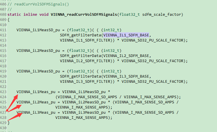

    2.here,ISR code pfccontrolcode have twp functions,readcurvolADCsignals() and readcurvolSDFMSignals(). VIENNA_il1MeasSD_PU,VIENNA_il2MeasSD_PU,VIENNA_il3MeasSD_PU,Should their values follow the previous function or the latter?
    3.When the input voltage has not increased, the value of Vrms1 has reached 22V. The input voltage has increased. Vrms2 and Vrms3 are still not updated. I don't know what to do. Is there something wrong with hardware or software?What should I do?I did exactly what the manual said.

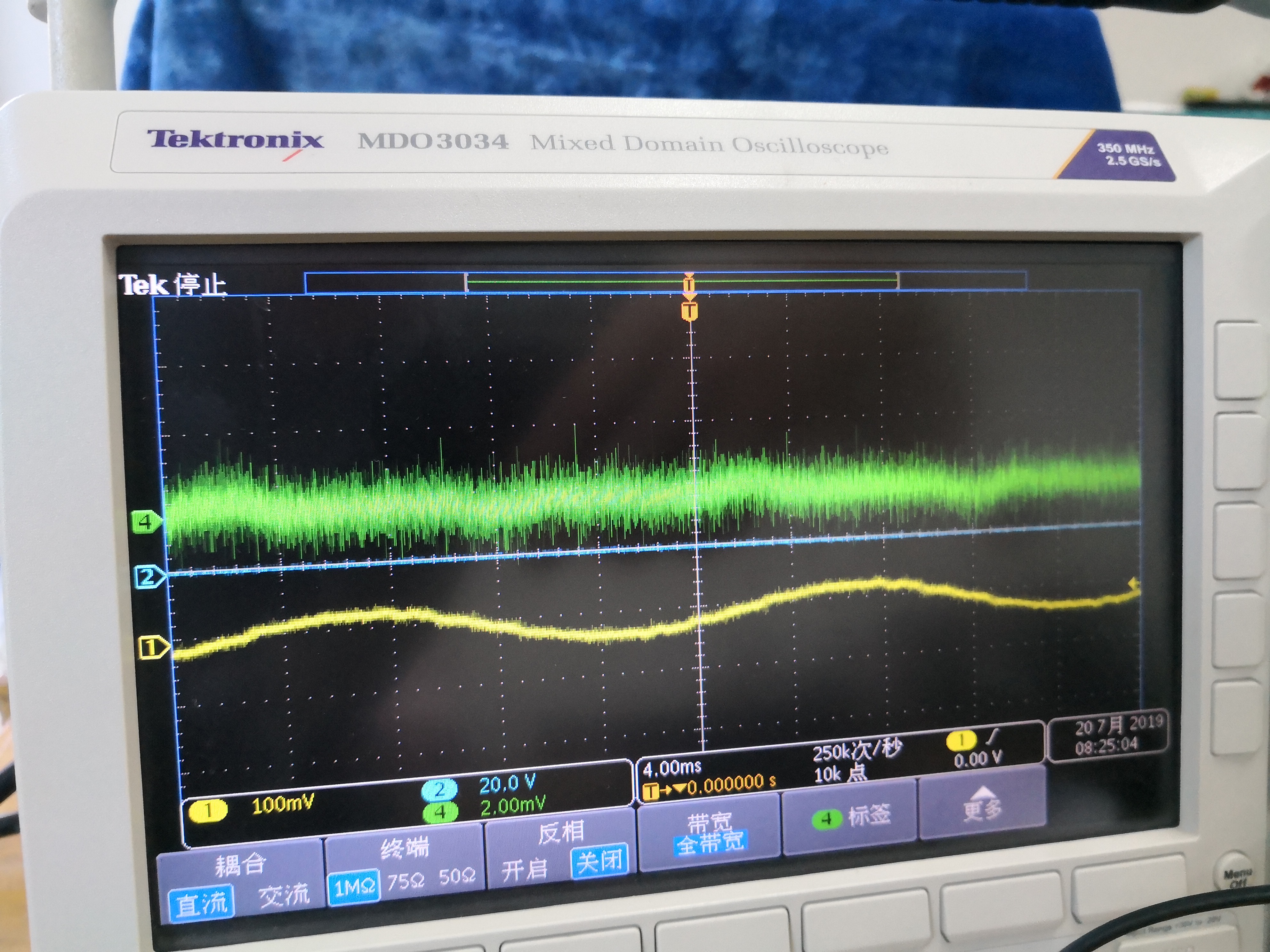

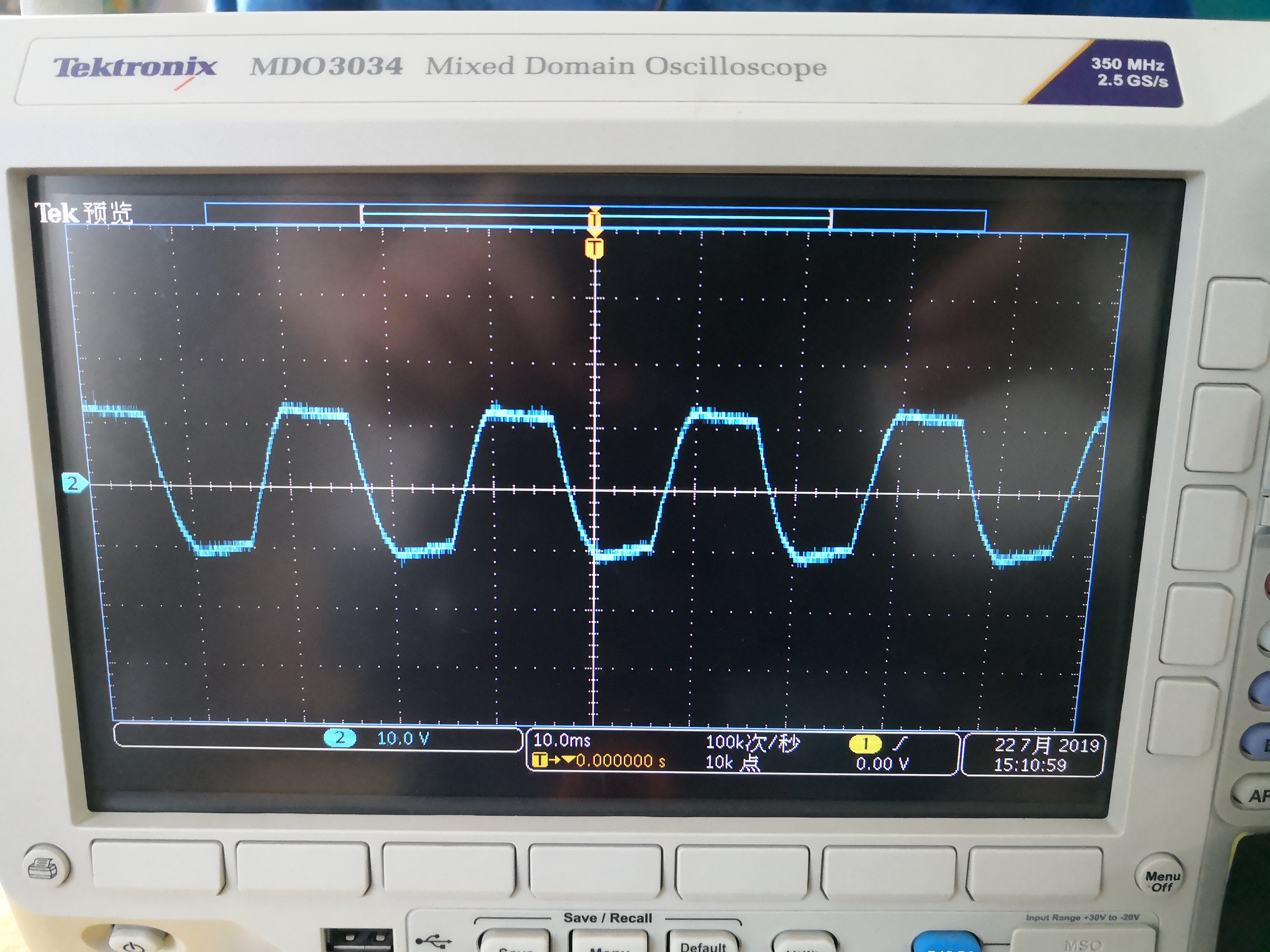

  • 1.The input voltage is shown in the figure below. Is that right?
    2.The input voltage is normal, but the A phase current is problematic.The last one is A phase current(Green).Is it possible that there is a problem with my three-phase input AC source?
    1. It is correct, but you probably can try to tune the acquisition size and the display data size to make it better.
    2.The current waveforms are correct. Is that the waveform of phase one current? I have not seen this issue before and I believe it is not something in the code, but according to the value shown in the expression window, it is huge (16.75 A?). Have you changed the original code other than the suggestion I gave to you? It can be something wrong with the Board or the AC source. Can you directly measure the three phase current in the oscilloscope to make sure the value shown in the CCS is correct?

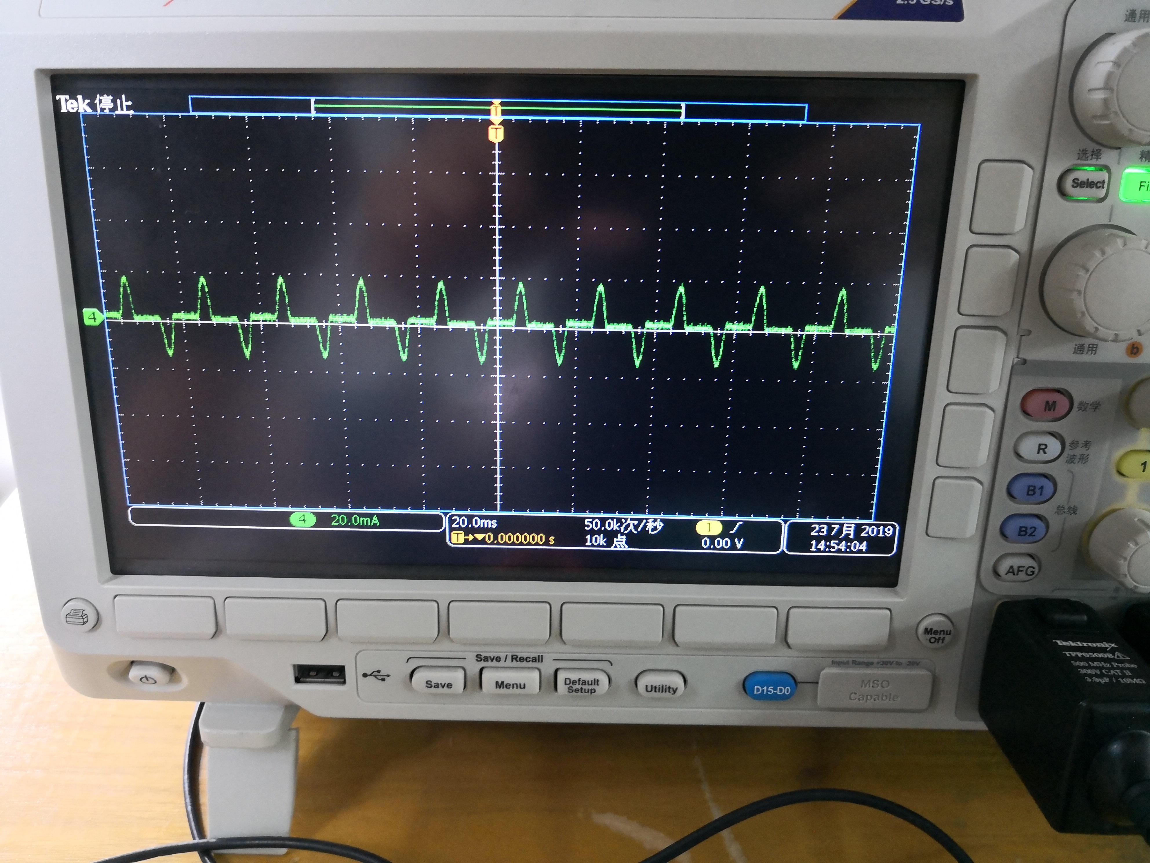

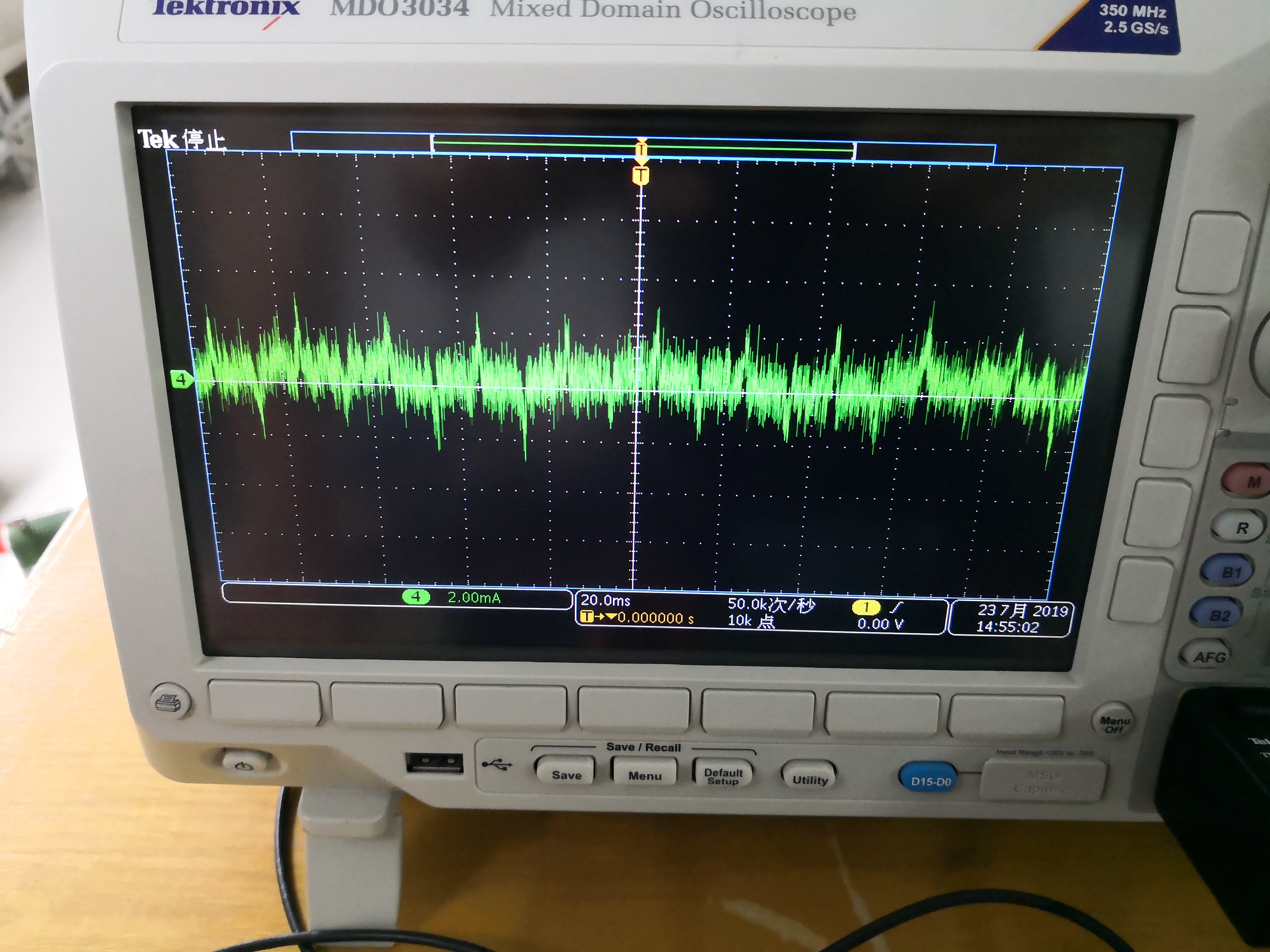

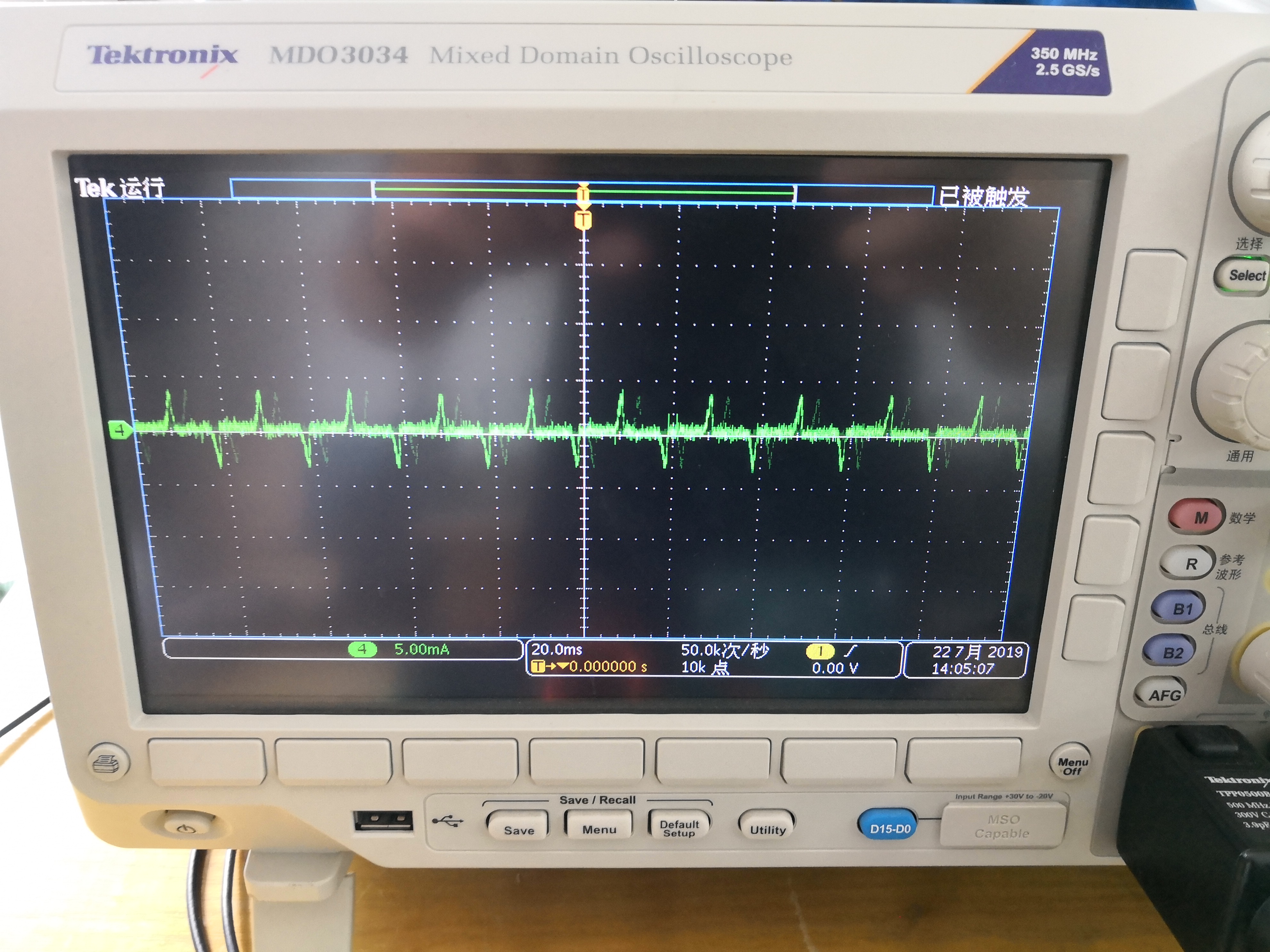

  • Answer your second question. The current value of iL1 is not updated in real time. Its value is wrong and the actual input is not that large.
    1.
    As shown above,As shown in the figure above, the input currents of three phases a, B and C are normal, which proves that there are problems in hardware or internal code. I have never modified the code. In the expression window, the current values of phase A are not updated in real time, it always keep the value of -1.39A, and other values can be updated normally. What's the matter? What should I do? The last figure is a fixed duty cycle. Is his waveform correct? The waveforms of the six pins on the board I tested are exactly the same as this one.

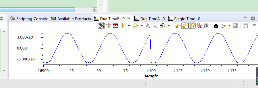

    2.As shown in the pictures above,they are a and b phase circuit,Why are waveforms not continuous? There is a vertical line between them.
    1.
    For the debug purpose, please change the settings in vienna_settings.h as below:
    from #define VIENNA_SDFM_SENSING 1
    to #define VIENNA_SDFM_SENSING 0

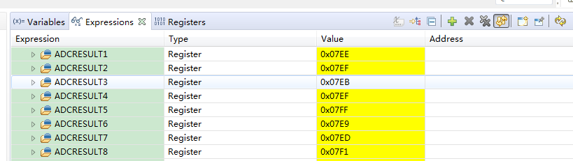

    I notice that VIENNA_iL1Meas_pu is not updating, can you enter the "AdcaResultRegs" in the expression window? and check whether ADCresult0~11 are updating? can you please attach a pic of that to me as before?
    Are all the three phase current you measured using oscilloscope or multimeter showing the correct value?  Can you also probe the IL1 sensing signal to see if it is correct?
    It is not like a software issue for me, more of a hardware sensing issue.
    2.  Please try to set acquisition size and the display data size both to 100.

  • 1.According to what you said, current and voltage waveforms can be displayed normally, and all values can be updated normally, but what is the value of Adcresult 0-11 not decimal?

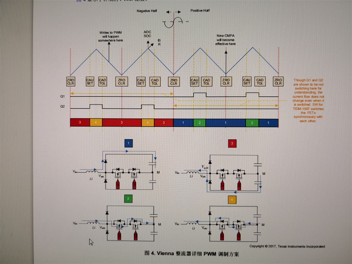

  • For the PWM output, please take a look at page 7,  and there are some notes as below:
    Though Q1 and Q2 are shown to be not switching here for understanding, the current flow does not change even when it is switched. SW for TIDM-1007 switches the FETs synchronously with each other

    3.Though Q1 and Q2 are shown to be not switching here for understanding, the current flow does not change even when it is switched. SW for TIDM-1007 switches the FETs synchronously with each other。
    I don't quite understand the meaning of this sentence.As shown in the figure below, aren't PWM1A and PWM1B waveforms complementary? Aren't the waveforms tested by Tp5 and Tp6 ?Can you explain it for me?

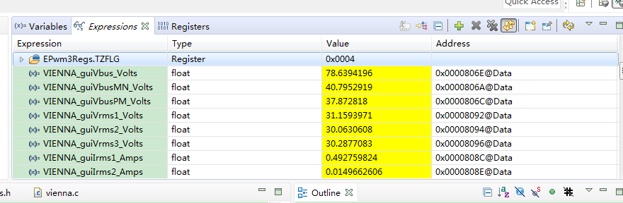

  • 1. You can always set VIENNA_SDFM_SENSING to 0.
    2. Do all the parameters value show up correctly? If yes, than you can jump into the next build
    3. The picture showing up in the user guide is one solution to setup the PWM. However, we implement the PWM in another way which is the waveform you saw in the scope. The PWM 1 and 2 are the same. They are not inverted. The notes is just to explain why this implementation can still work.

    2.Can epwm output in-phase or in-phase waveforms by setting them? As shown above, in the cases of 2 and 4, only one tube is conducting. Aren't their waveforms complementary?

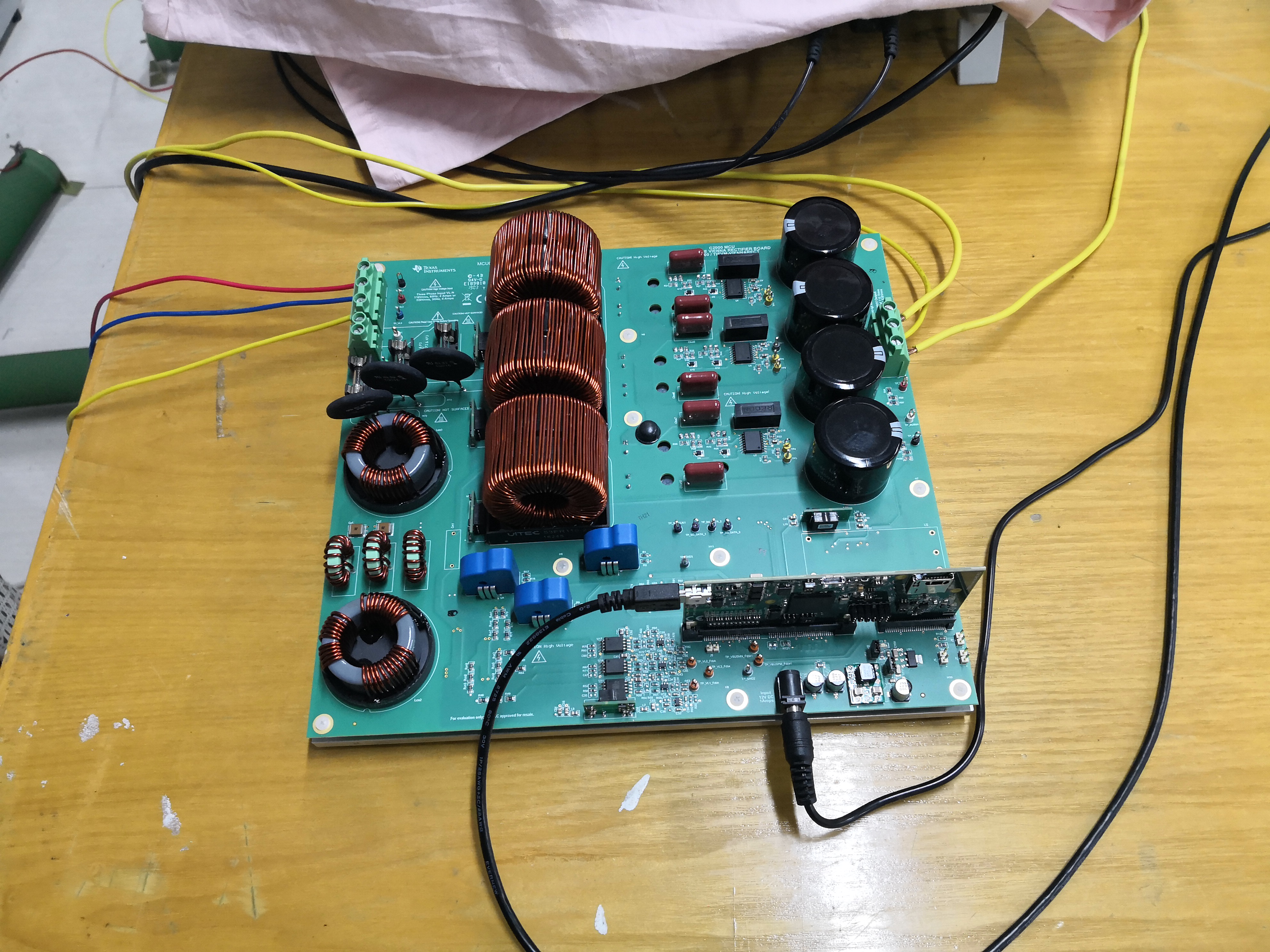

  • Today, I have done some experiments on closed-loop current. Here are a few questions I would like to ask you.
    1.The input voltage is 30V,DC side voltage is 70V. When I clear PWM trip,DC side voltage increase to 140V,Circuit boards emit louder current sounds. I see the guide manual whose DC side voltage reaches 600V,I don't have courage to try such a large voltage,because I am afraid that in case of hardware damage, it will affect my next experiment. Can I continue to validate the voltage loop at the input voltage of 30V?
