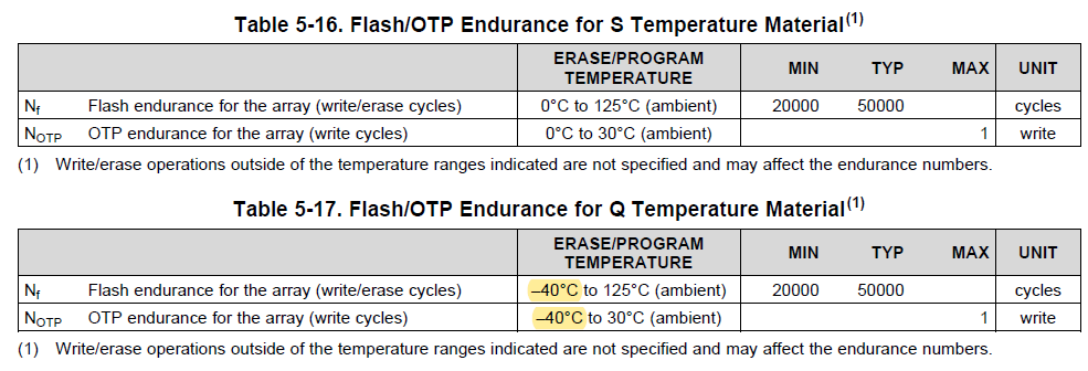

the FIT Rate vs. Operating Junction Temperature doesn't show difference between Q100 version and Non-Q100 version for the same package. And the recommended operating conditions of junction temperature of S version and Q version are both -40C to 125C.
So could you please list some key pros of Q version F2802x compared to non-Q version like S version?
For example, does the flash of Q version have longer lifetime?

    Automotive Q100 devices have extended specifications (especially in regards to temperature - see the datasheet) and often offer better reliability as expected in automotive applications.
    The flash endurance of Q grade devices are spec'd at a larger temperature range (down to -40C instead of 0C):

    My customer's main concern is:
    do we have comparison of "FIT Rate vs. Operating Junction Temperature" of Q100 version devices and non-Q100 version devices?
    http://www.ti.com/lit/an/spra963b/spra963b.pdf
    the paper doesn't show the difference.
    If S version, T version and Q version of F28022  have the same failure rate, they have no reason to choose Q100 version devices.
  • Hi Howard,
    Each device is tested to its respective temperature specification as stated in the datasheet. For Q-grade devices there’s a more extensive level of testing to align with automotive industry DPPM requirements.
