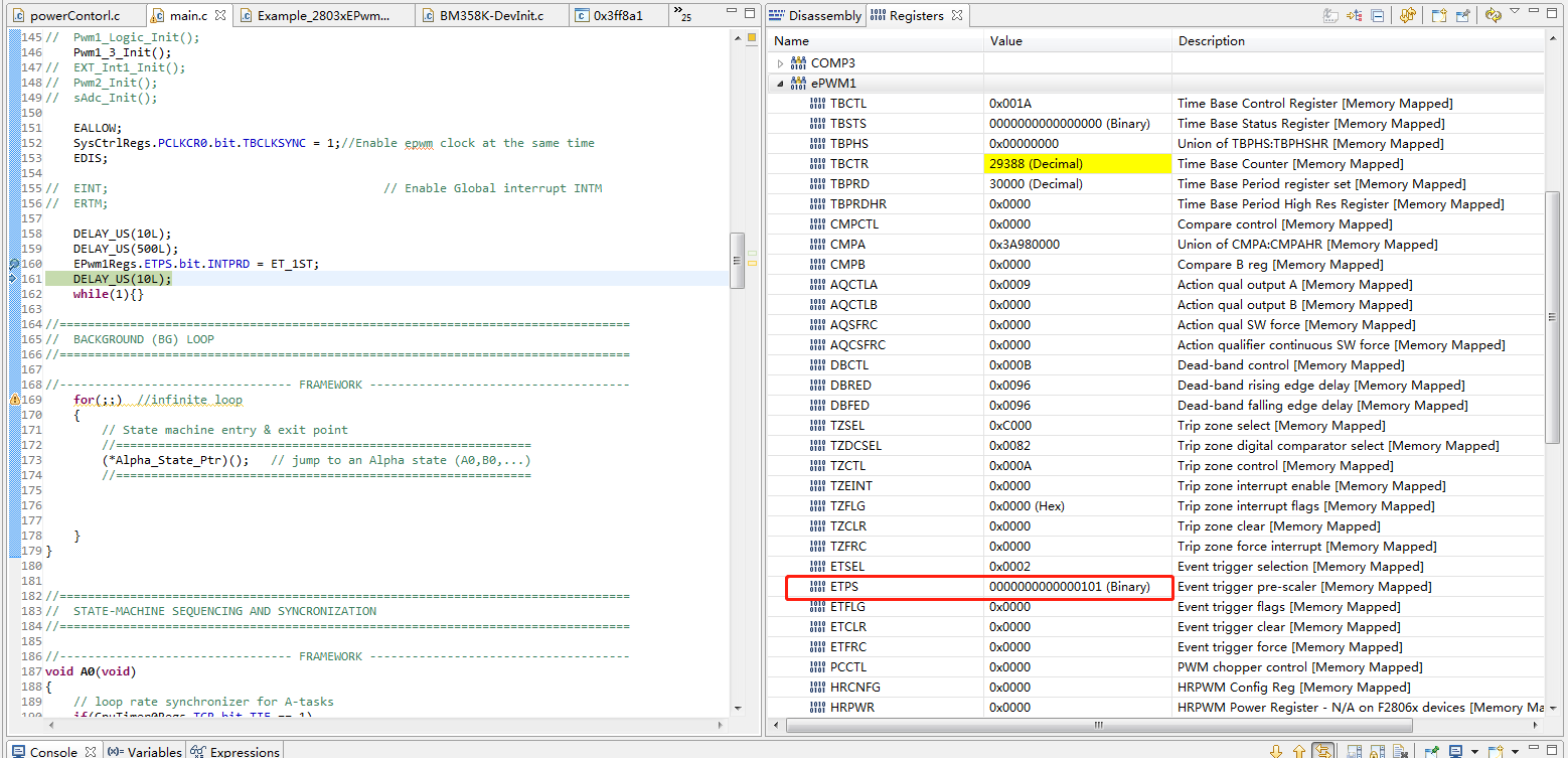

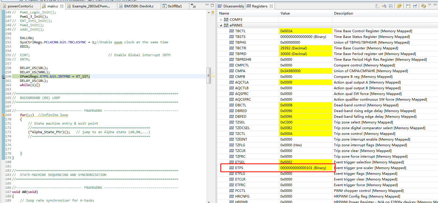

  • Thanks for your reply,
    bits [15:14] of the TBCTL register is a default value 0.
    I streamlined the code and it only have epwm1 module and DELAY_US() function,In addition, I blocked the global interruption.
    as you can see two picture below, after execute <EPwm1Regs.ETPS.bit.INTPRD = ET_1ST;>, The ETPS value changes nothing.
    DELAY_US(10L);
    while(1){}

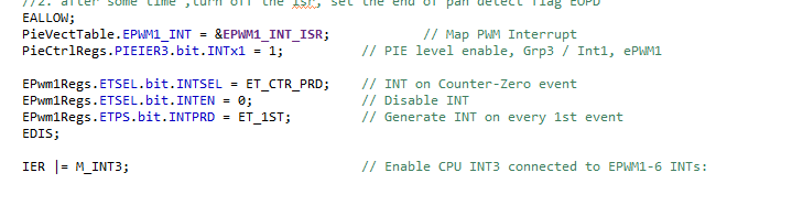

    EALLOW;
    PieVectTable.EPWM1_INT = &EPWM1_INT_ISR; // Map PWM Interrupt
    PieCtrlRegs.PIEIER3.bit.INTx1 = 1; // PIE level enable, Grp3 / Int1, ePWM1
    EDIS;
    EPwm1Regs.ETSEL.bit.INTSEL = ET_CTR_PRD; // INT on Counter-Zero event
    EPwm1Regs.ETSEL.bit.INTEN = 0; // Disable INT
    EPwm1Regs.ETPS.bit.INTPRD = ET_1ST; // Generate INT on every 1st event
    IER |= M_INT3; // Enable CPU INT3 connected to EPWM1-6 INTs:

    Soldier 76,
    Looking into this it appears that the counter clears when writing an INTPRD value equal to INTCNT or equal to 0. If you write INTPRD = INTCNT it will trigger an interrupt. For example INTCNT =2 you can reset this by writing 0 or 2 into INTPRD. Writing a 3 or a 1 will not reset INTCNT.
    If INTCNT =1 and INTPRD =2 setting INTPRD = 3 will not reset INTCNT.
    If you want the count to always be reset when adjusting INTPRD then write INTPRD = 0 and then INTPRD = 'desired value'.
    Hope it helps.
