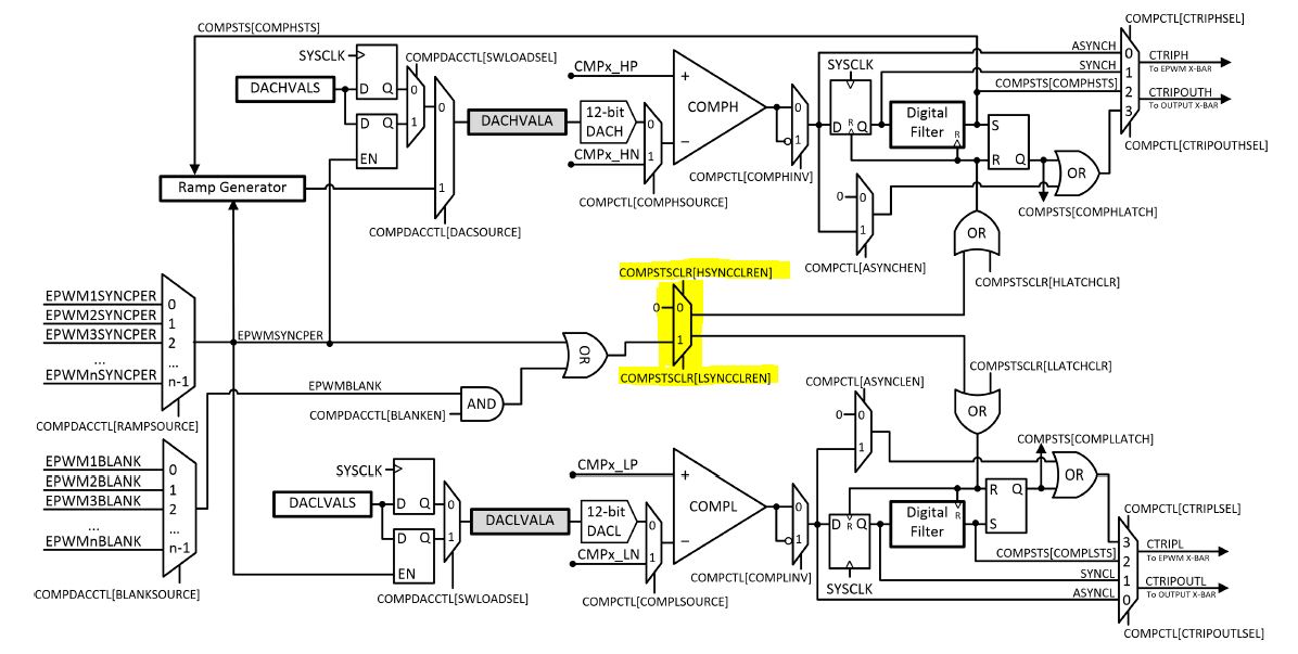

CMPSS block diagram captures only one MUX between HSYNCCLREN and LSYNCCLREN option.
Please refer the diagram below. Does it imply 2 MUX?

Hi Venkat,
Yes, they are 2 separate muxes. It's drawn this way for simplicity.
