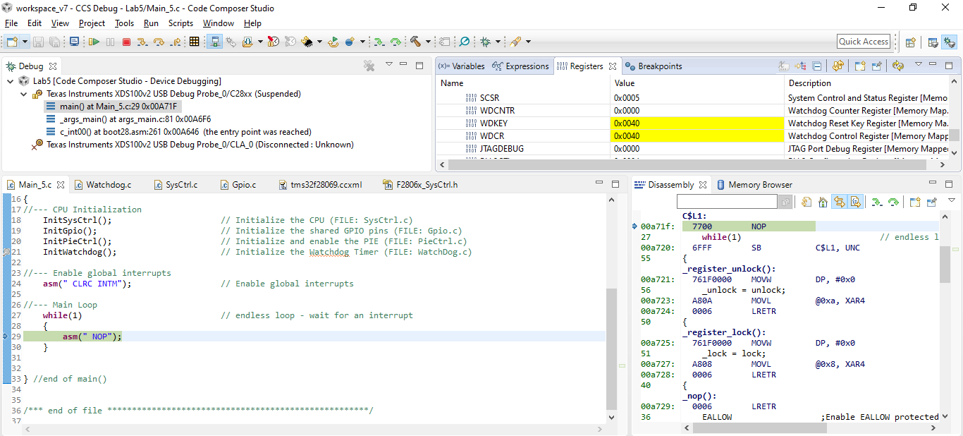

Before run code:

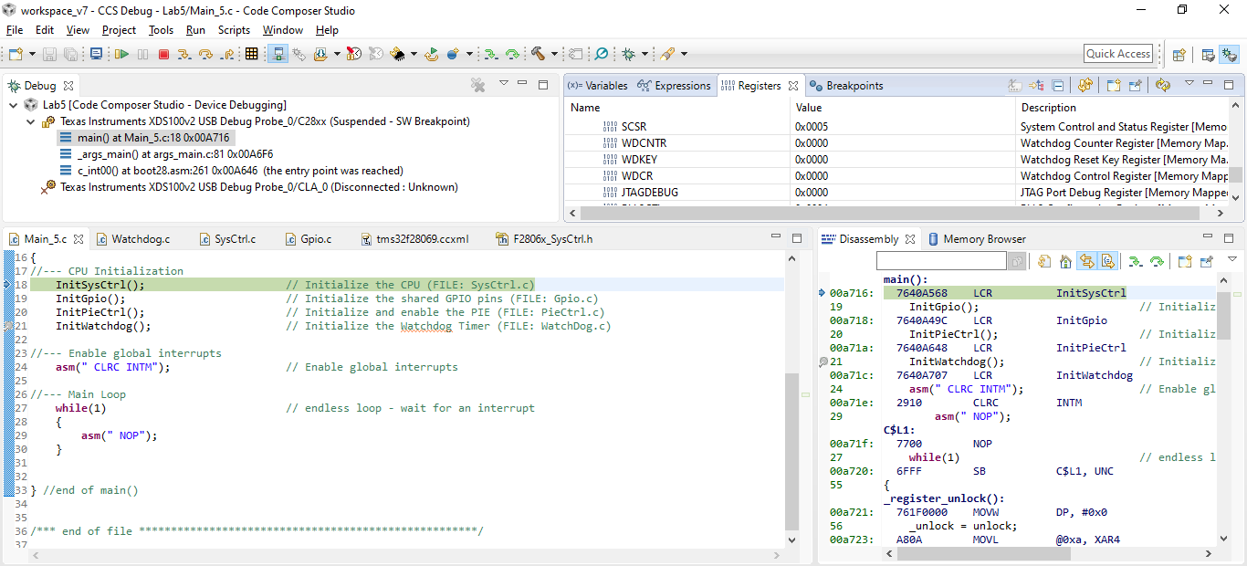

After run code:
So I cannot control watchdog module to complete this lab5.

  • Hi Ken,
    I'm in first part of Lab5 and I cannot complete it because the WATCHDOG registers don't change right value after run code to configure this module.
    Yesterday, I completed it once times but when I try again, this project appeared this bug.

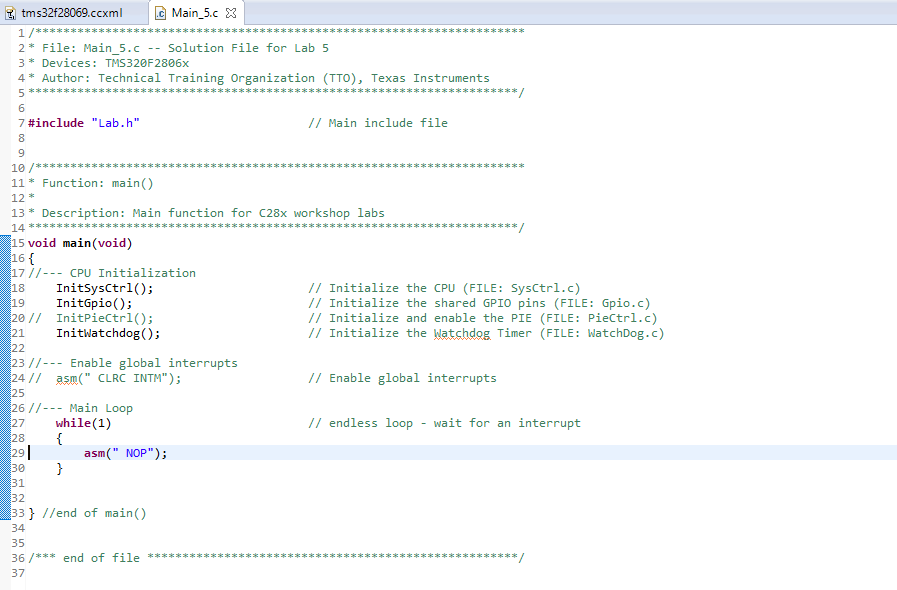

    Main.c:

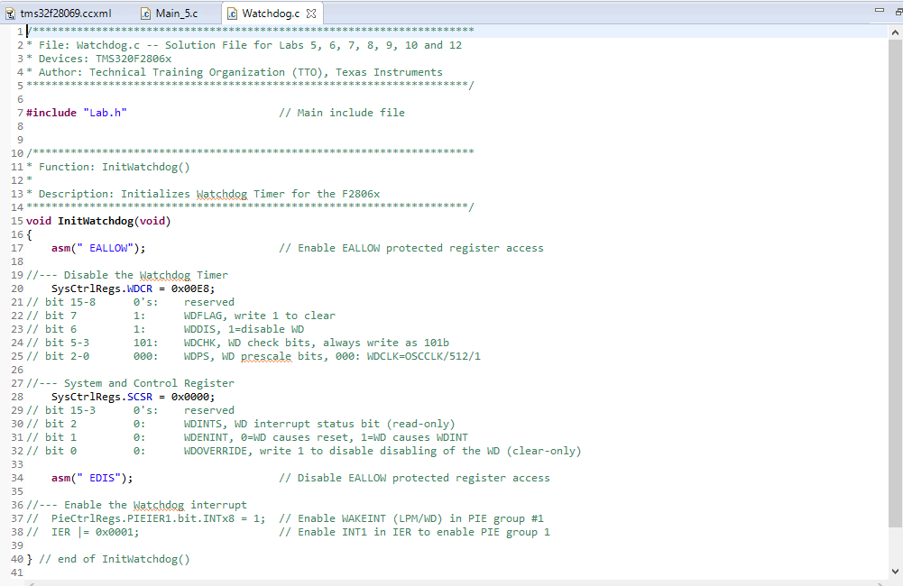

    Watchdog.c:
    Please help me.

    I ran the lab exercise and it works perfectly.  We have been using this workshop for many years without any issues.  In the first part of the lab exercise you need to place a breakpoint at the beginning of main().  I noticed that you are using the solution files, which is ok, and you did comment out the code for interrupts that is used in the second part - again this is fine.  I do not see the breakpoint set on line 18 in main().  Then you need to run the code with the watchdog disable.  In watchdog.c  the WDCR should be set to 0x00E8, which it is and when running the code it should be in the while loop.  Next, you need to enable the watchdog by setting the WDCR to 0x00A8.  Now when you run the code it should stop at the breakpoint.
    You might want to try deleting the project from CCS, close and open CCS, and import it again.  Also, you could delete the workspace and try again.  This might help.

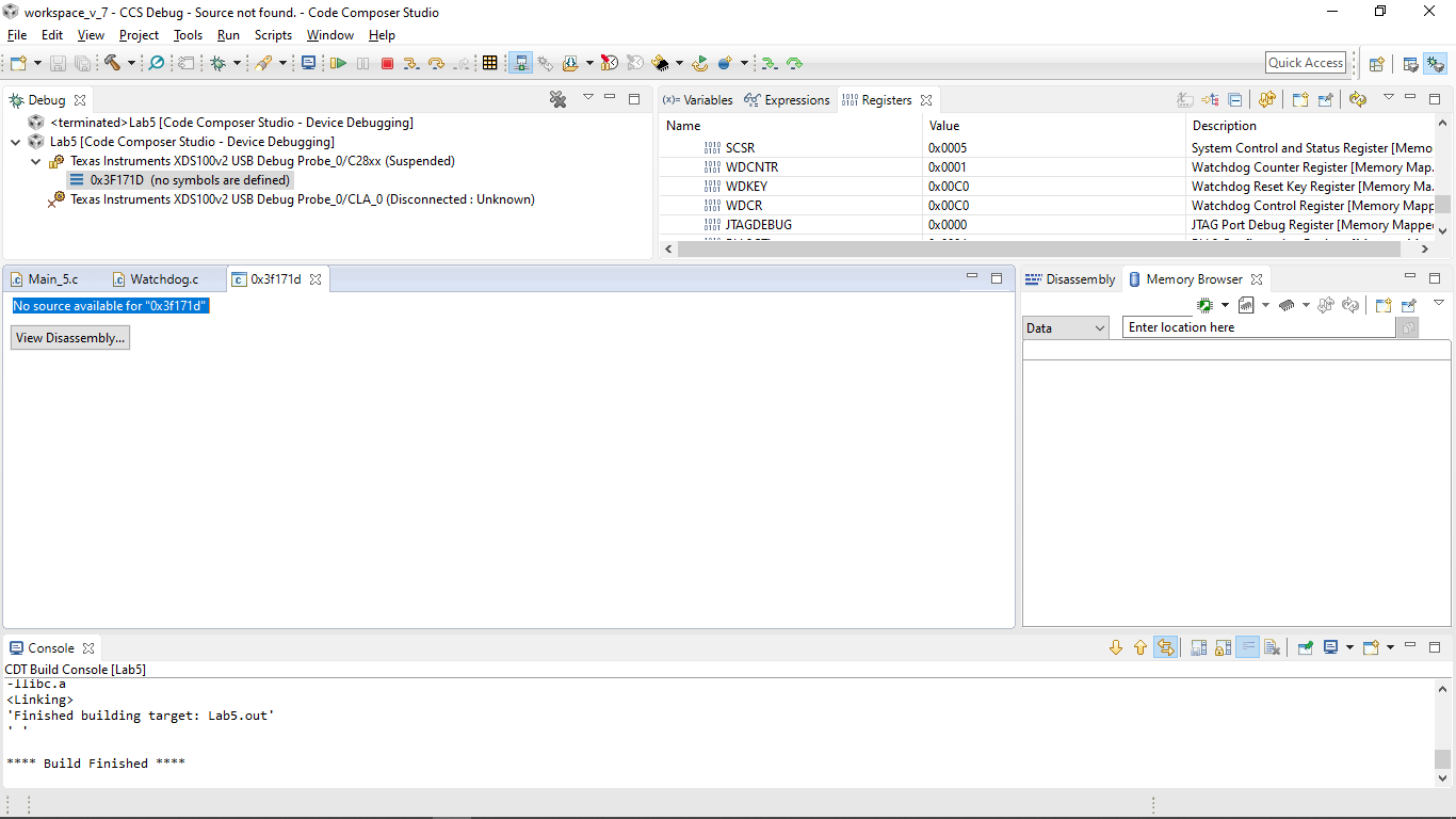

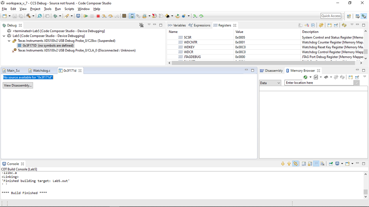

    And when I try to enable Watchdog, it appear new bug:
    "No source available for "0x3f171d" "
    I cannot understand.

    Also, the "No source available for "0x3f171d" is not an error or bug.  This address is in the boot ROM and CCS is just letting you know that it cannot display the source without the symbols.  By clicking "View Disassembly" you will then view the boot ROM contents in the Disassembly window.
