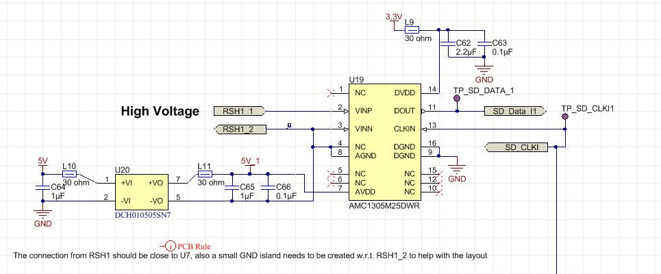

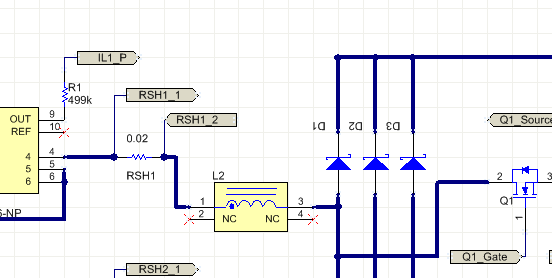

    As shown in the figure below, capacitor C1 exploded and current sampling chip burned, but this sampling chip is not used at all(The first picture U19 is a current sampling chip, not an AC voltage sampling chip.). Can you give me an analysis of the reason?
  • The C1 blown up here is useless.Because the rear U1 is not welded on the circuit board,Why did C1 blow up here?
  • But C1 is still connected between VBUSM and VBUSN. I assume it is because of the unbalanced input causing the output voltage to be larger then the cap voltage limit.

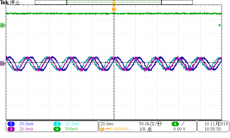

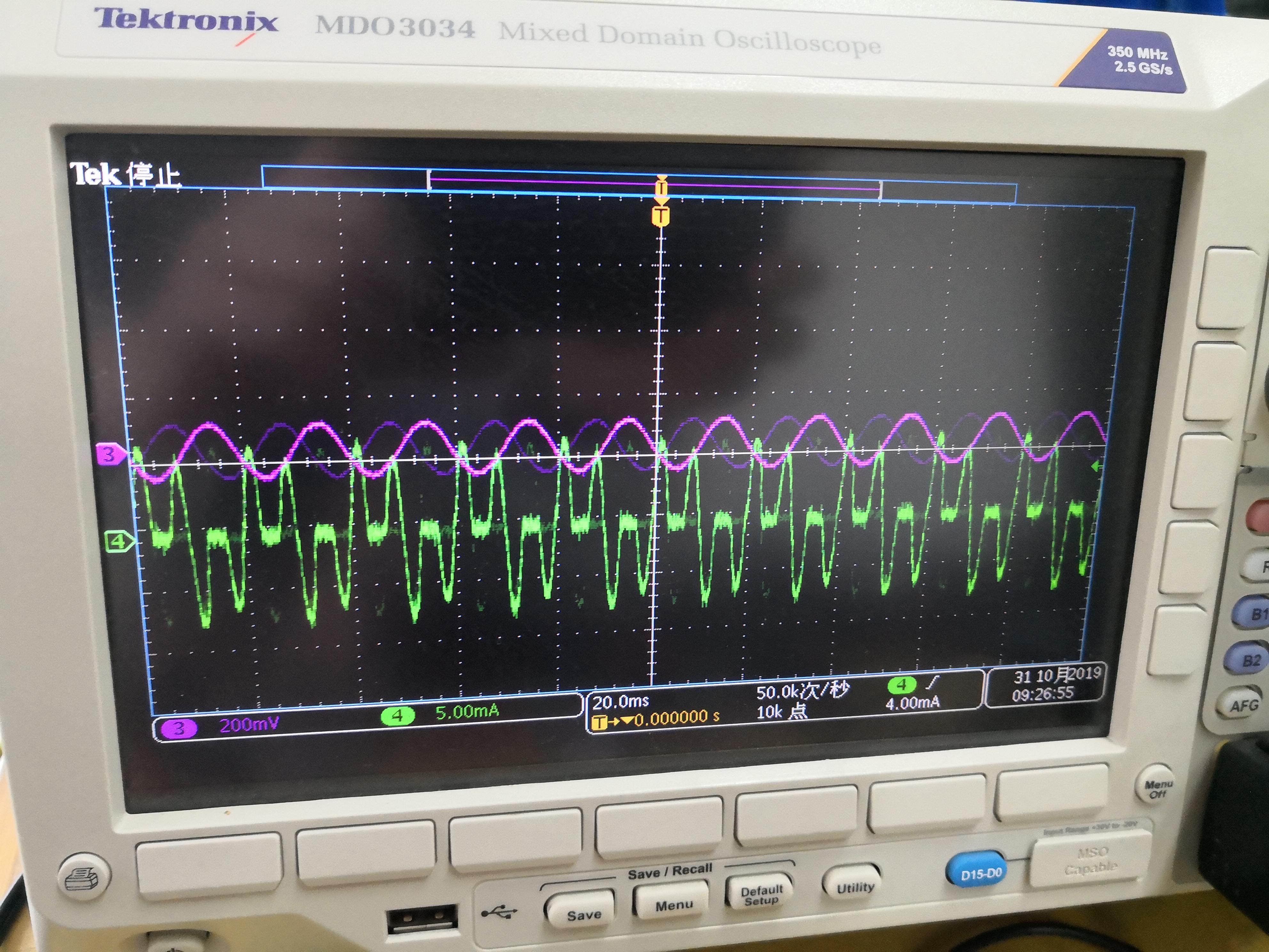

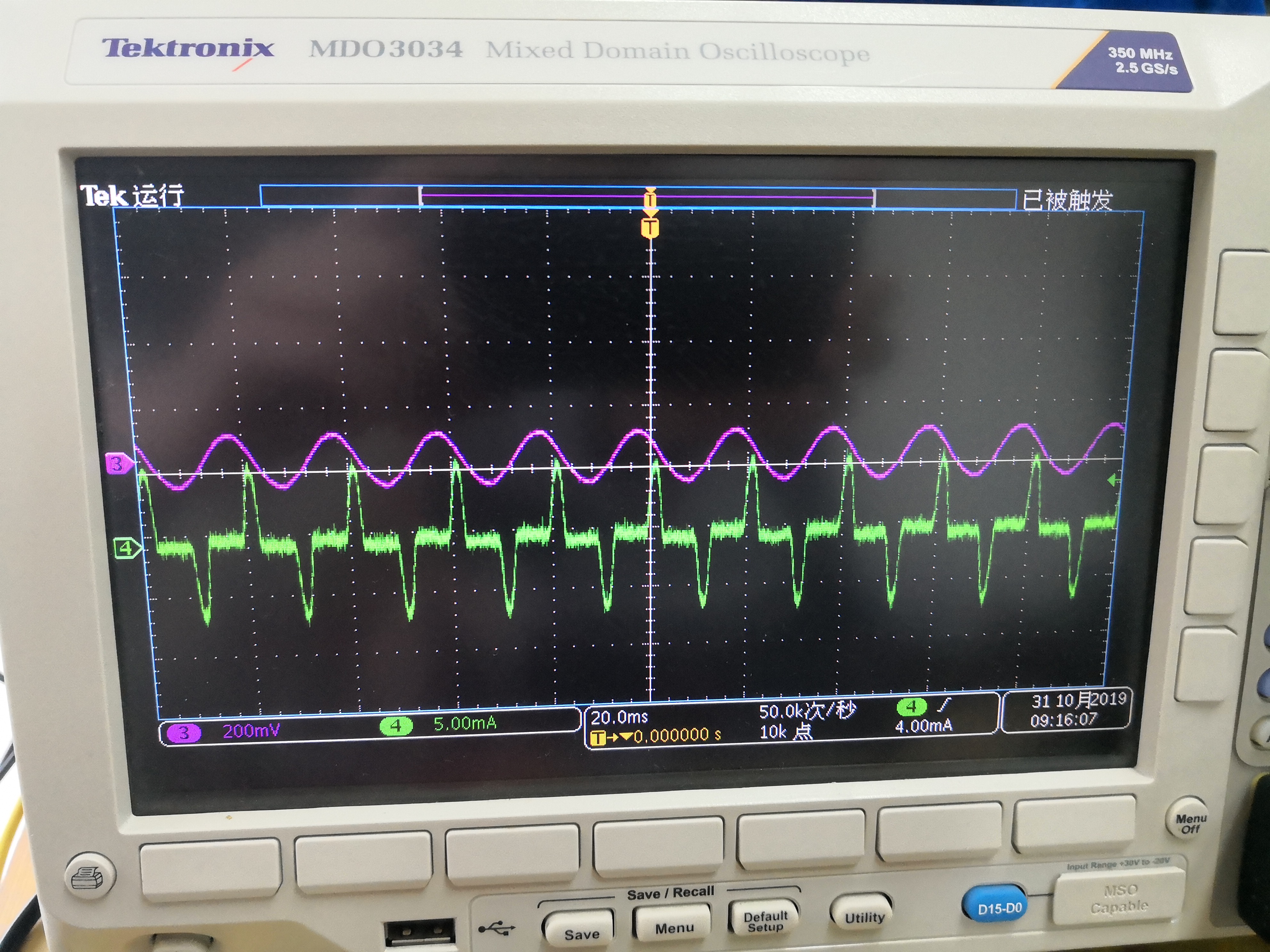

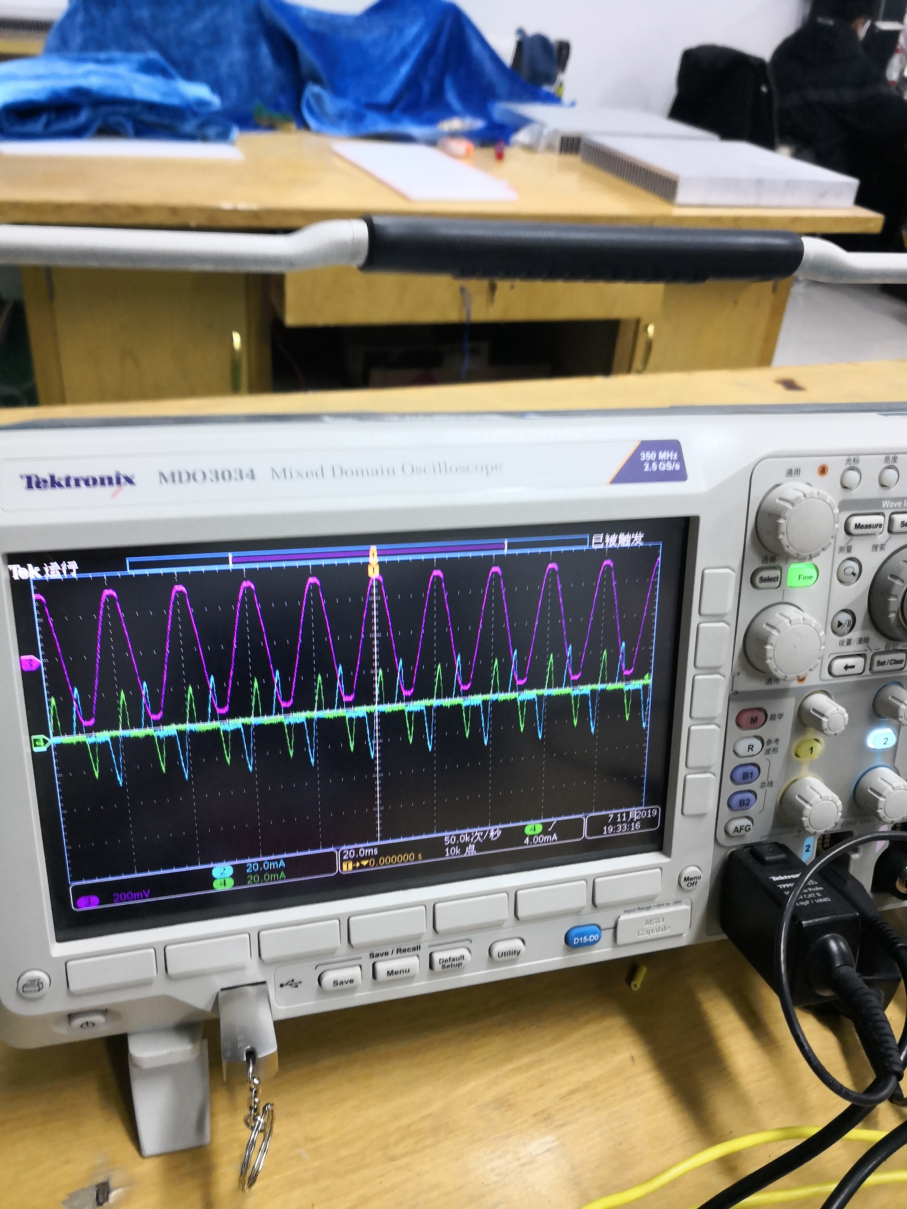

    Today, I tried to power on again. Input 30V voltage, phase a shows voltage, no current, the main side of the voltage regulator has current and is normal, phase B, phase C shows normal, phase n has current, I don't know why
    Phase A  voltage(Violet) and Current(green)
    Phase B
    Phase C
    Phase a of main side of voltage regulator
    N phase current,Voltage not.
    I doubt there is still something wrong in the baseboard causing this unbalanced current issue. Usually it takes time to debug.
    1. To also measure the PWM signal for all three phases to make sure they are correct.
    2. The good thing is your three phase input voltages are balanced based on the waveforms you provided. I remember earlier you see unbalanced input voltage showed in the watch window. So I assume this has been solved because of the voltage source.
    But the voltage you showed is in a level of 200mV. So is this the sensed input voltage?
    3. The peak current is around 5mA? With 30V input, it seems too low. So it is not the real input current?
    You need to measure the real phase current. If there is no phase a current, it can be some component broken on the board or because of the abnormal behavior of PWM signal. I will suggest to do hardware examination for phase a after checking the PWM signals.
    4. The neutral line current is caused by the unbalanced three phase current so it is not a surprise when there is no phase a current.

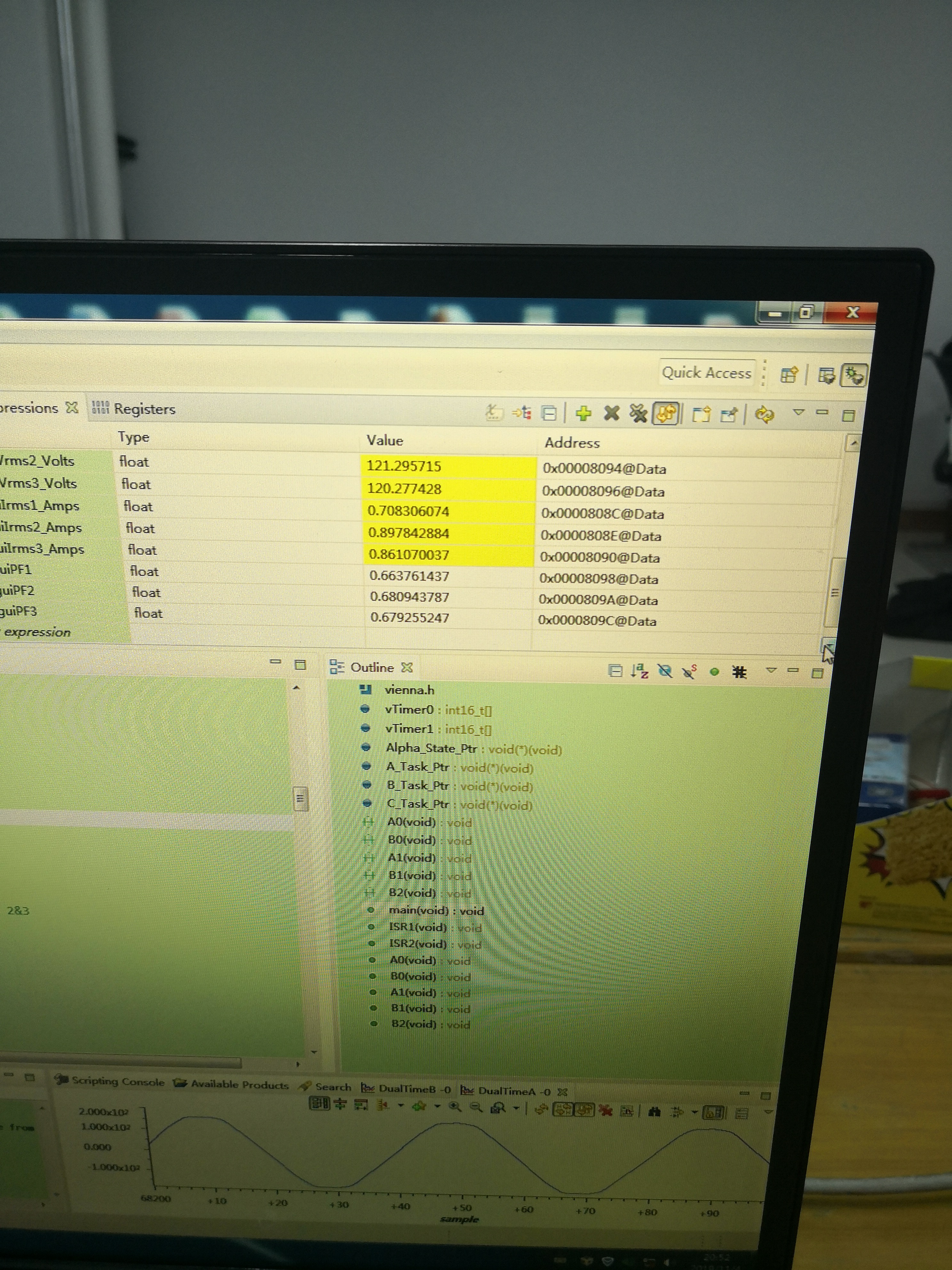

    Today, I tried open-loop debugging. As shown in the figure below, my AC voltage is 120V, but my DC voltage is not 320v, only 314v. Is this within the error range? The three-phase current is 0.70/0.90/0.85a respectively, which is not up to 0.92a mentioned in the manual. Is the current amplitude and the difference between each phase current within a reasonable range?
    Voltage (purple) and current (green) are measured by voltage probe and current clamp respectively, with gears of 500 times and 100 times respectively.
    I would say 314 is ok.
    Phase a current is a little bit low. Manish has gave you two suggestions, please check them again.
    Once you fix it, you are good to go to the next step. And you can also test the over current protection in the code and enable the current/voltage protection in your source.
    Chen

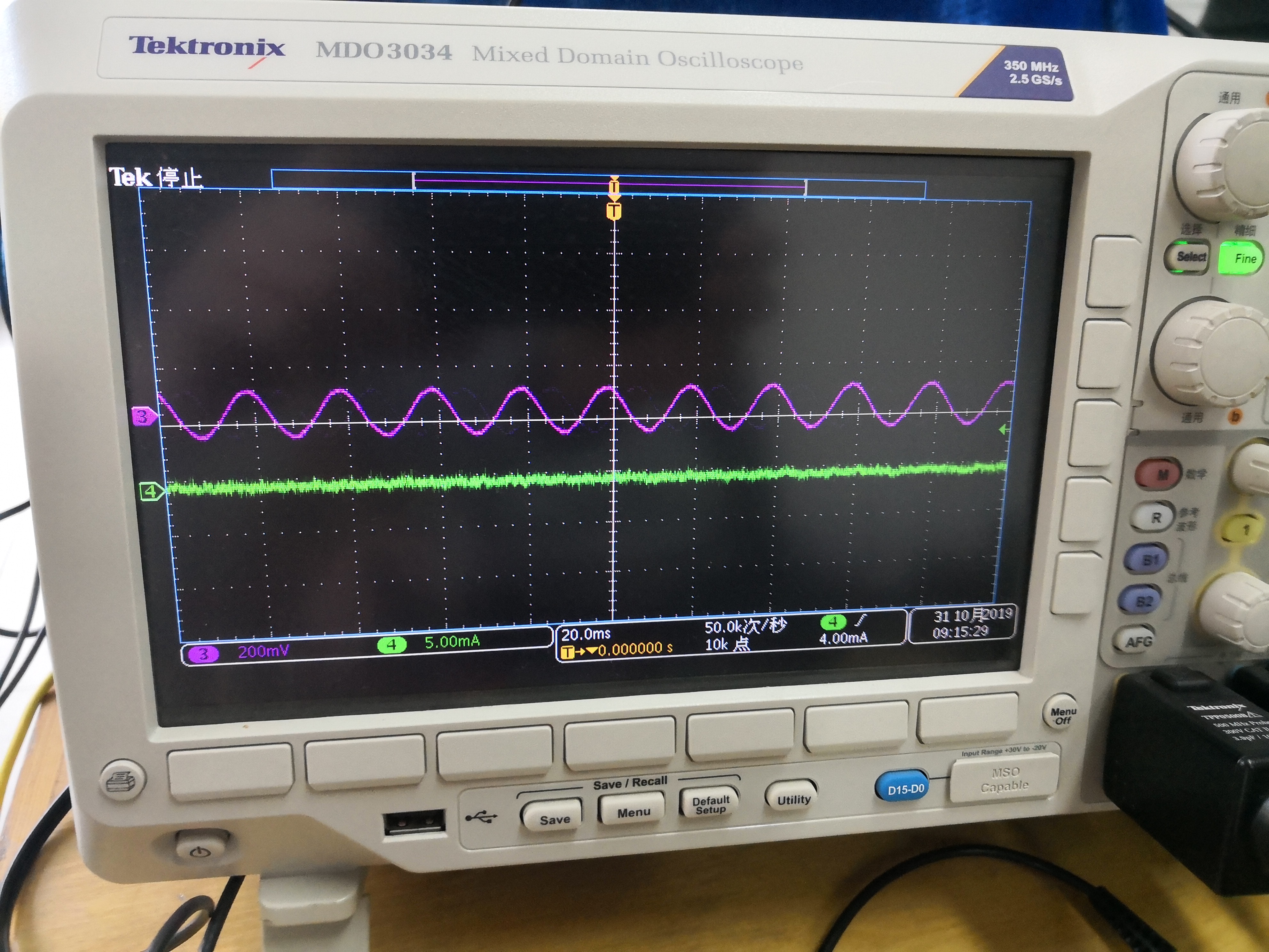

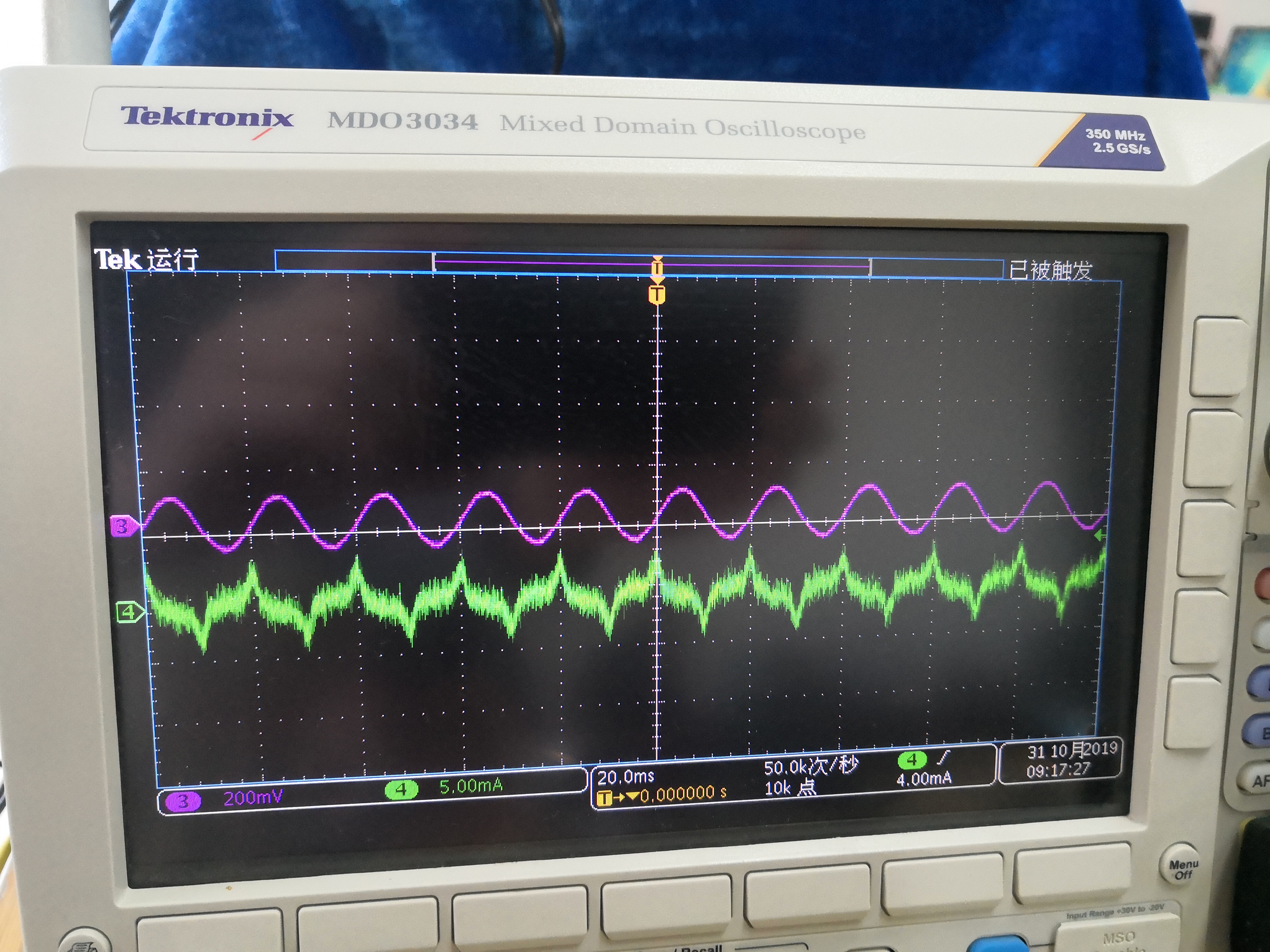

    I have checked the board according Manish says, The test results are shown in the figure below
    In the first picture,Purple is A-phase AC voltage, green is A-phase AC current, blue is B-phase AC current.
    in the second picture, Purple is A-phase AC voltage, green is A-phase AC current, blue is N-phase AC current.
    Q;1.Does the magnitude of surge resistance have a great influence on the magnitude of current?This morning, I measured 18.1 / 19.6 / 18.2 ohms of surge resistance, which changed to 14.2 / 15.5 / 14.3 ohms at night. If there is an impact, how can I reduce it?
       2.Manish mentioned that surge resistance needs to be heated evenly. How long should I wait?
     I look forward to your reply!
    The Inrush NTC we used are very variable, so this can happen. We suggest to remove the inrush NTC and check if this is still unbalanced.
    Also you have to be careful if you remove NTC to apply sudden voltages.

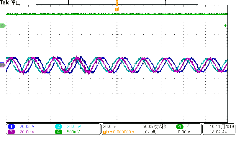

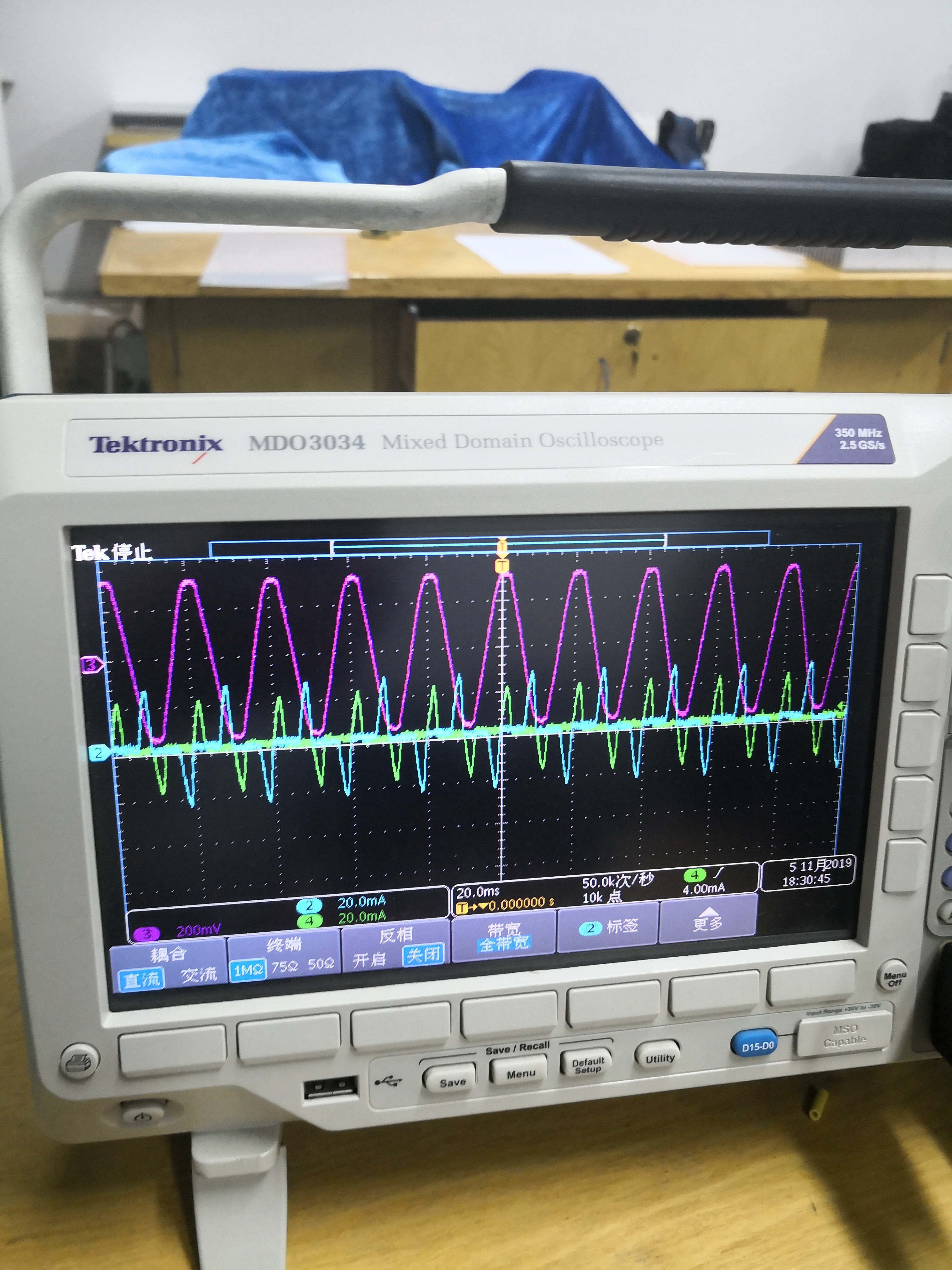

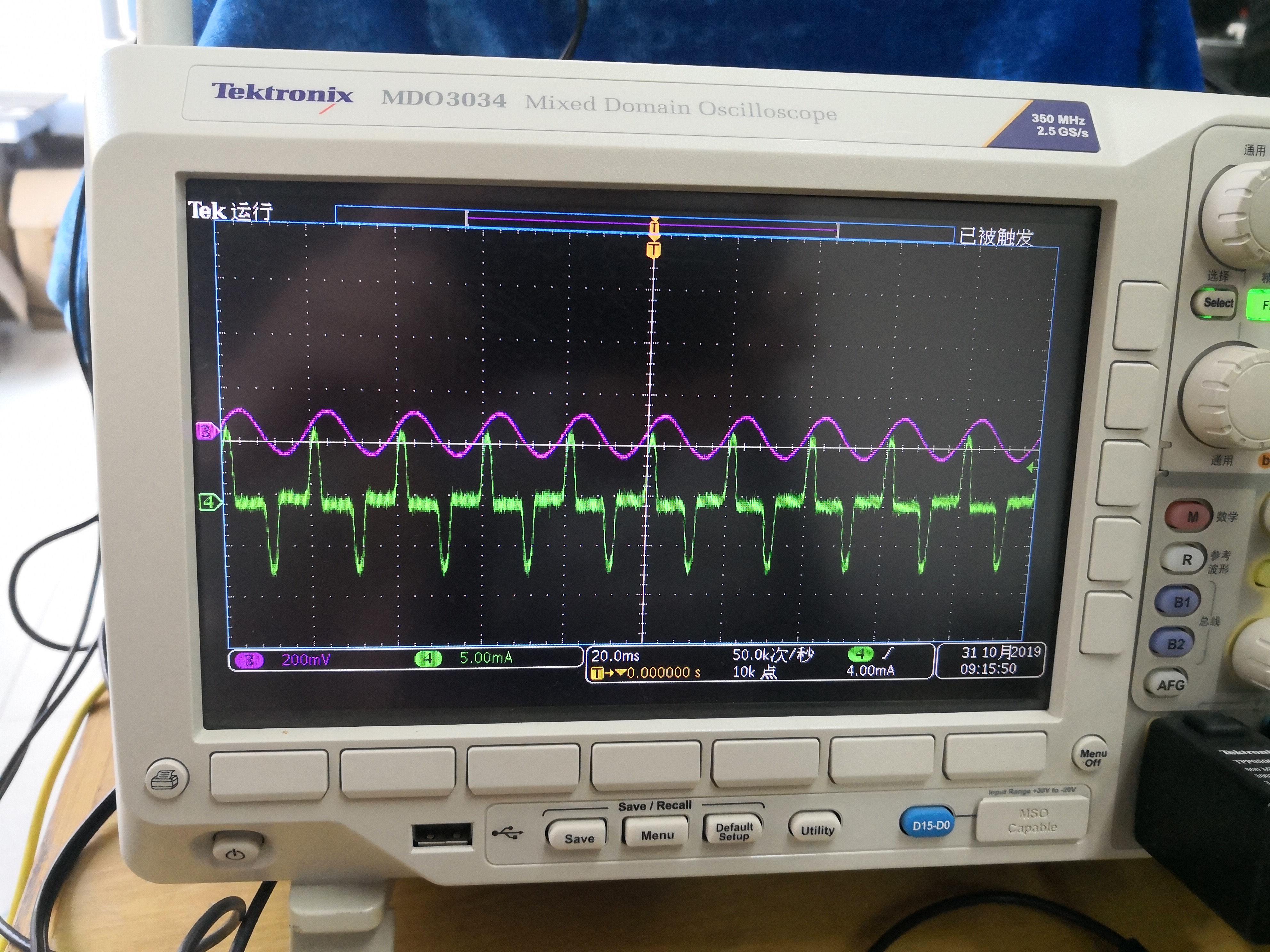

  • As shown below, it is the three-phase current under the open-loop, current loop and voltage loop. They are asymmetric. 2 (cyan) is C phase, 3 (purple) is a phase, 1 (blue) is B phase. Can you help me analyze what caused it? I haven't seen the three-phase current before, but now I find that it's not symmetrical. There's a problem with the phase
    1.open loop
    2.cuuent loop
    3.voltage loop
    Ok, so basically your three phase current are not 120 degrees apart. Have you plotted the three phase input voltage waveforms? Are they 120 degrees apart from each other?

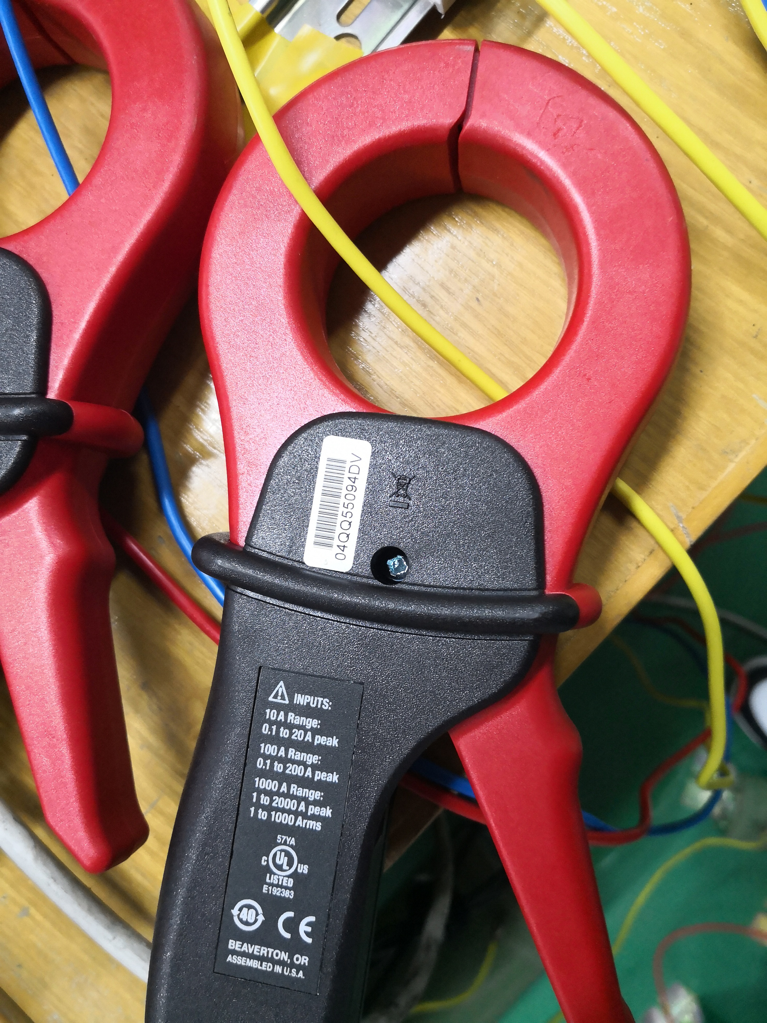

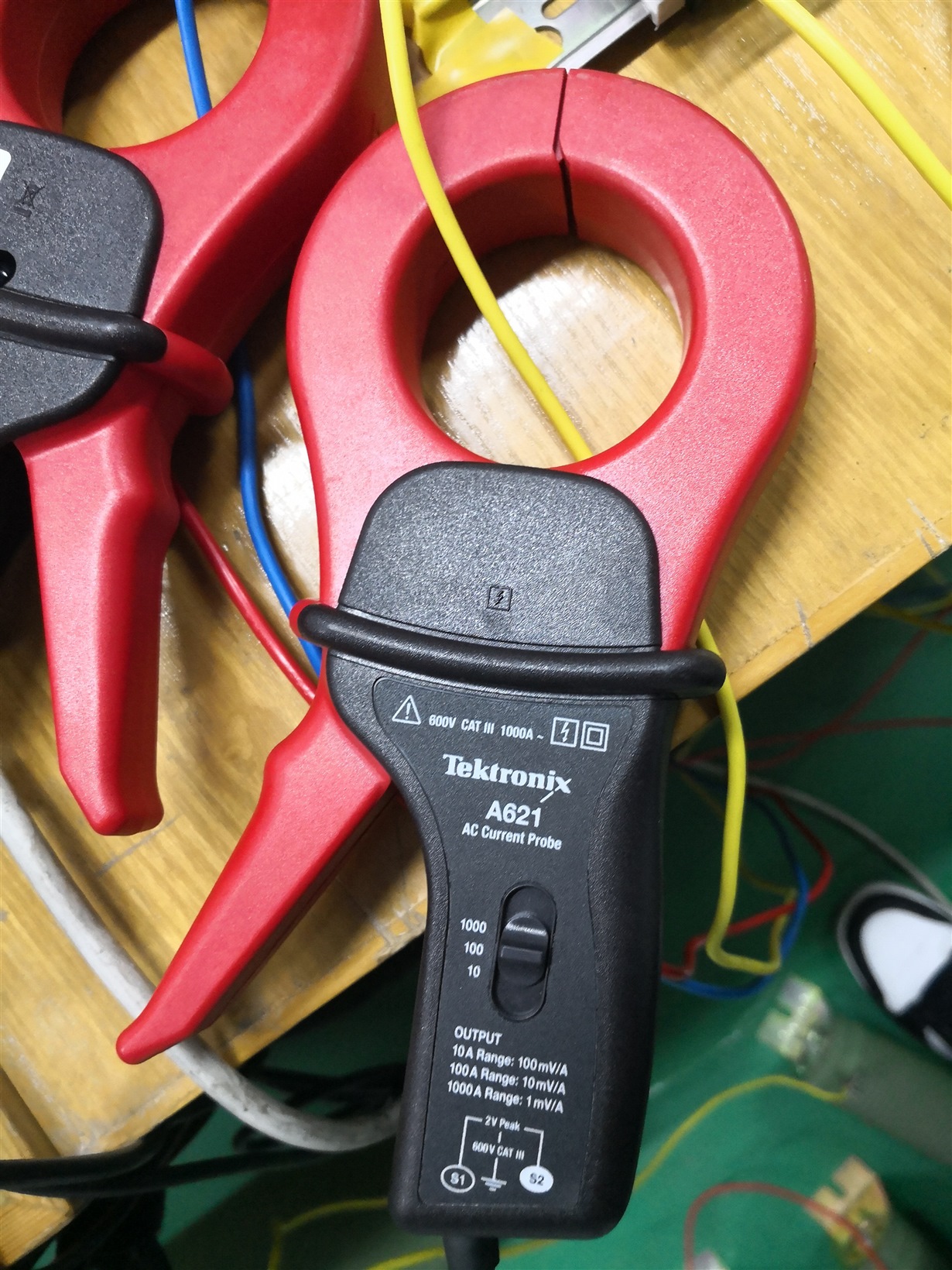

  • The current clamp is reversed.

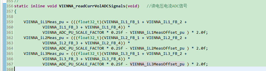

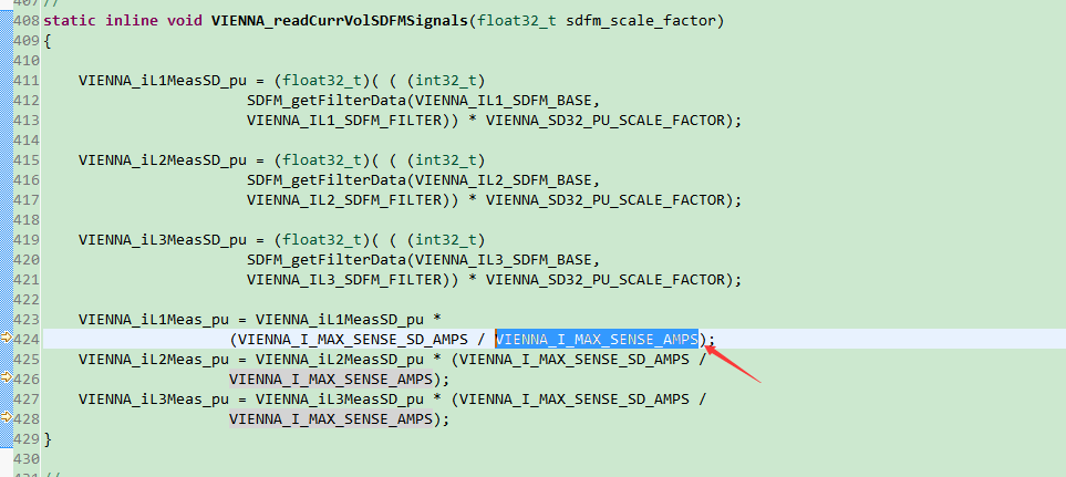

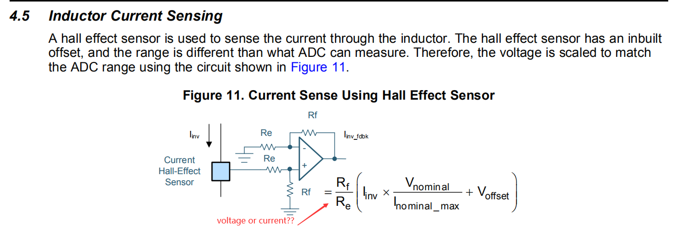

    Why does the current value displayed on the upper computer multiply by 12A?
    The IL1 / 2 / 3 here can be understood by multiplying by 12a if sdfm sampling is used
    But the hall sensor used here
    Is the formula in the last figure current or voltage?
    I hope I can get back to you as soon as possible. Thank you

    Could you please explain a little bit further about "The current clamp is reversed."? Is there anything wrong in the hardware you noticed?

    To answer your questions above:
    1. 12A is the ADC current reference
    2. ADC and SDFM have different reference value
    3. the formula you mentioned is for current sensing. But it is a voltage value representing the current.
    Next time please create a new thread for these software related questions.

  • Ok,I mean, the direction of the AC current probe  is reversed.There's no problem now.

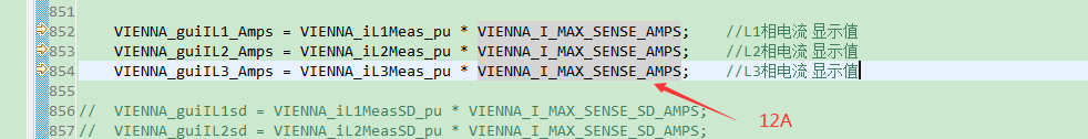

  • 1.I mean, why do I multiply by 12a, can I not?
    This is just to transfer a PU value to a real value(GUI value). The GUI value is not for control. It is for indication.

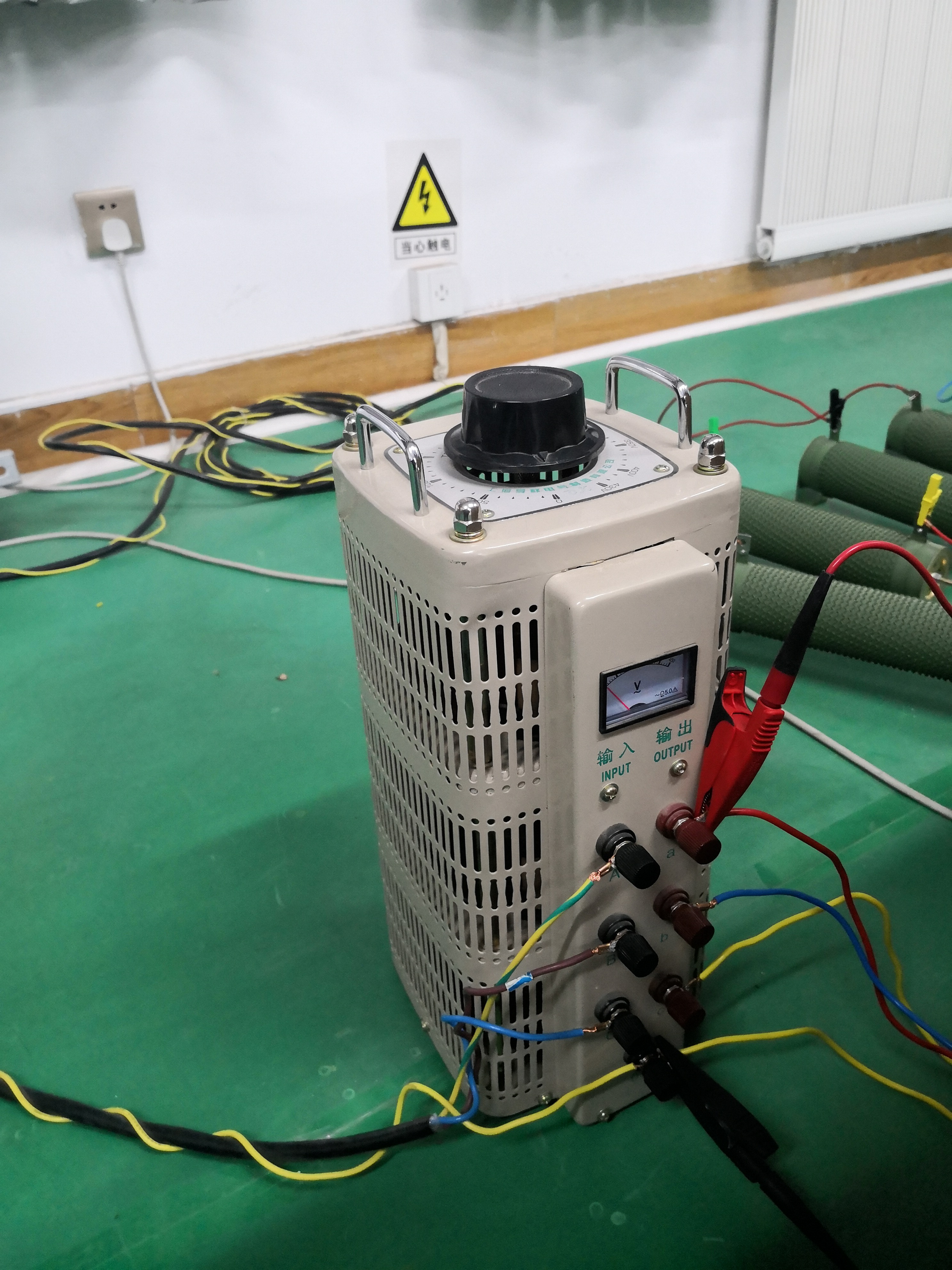

  • 1.Ok.Let me answer the first question.As shown in the figure on the left, I placed the current probe in the same way at the beginning; later, I placed the current probe in accordance with the figure on the right, and the phenomenon of current asymmetry disappeared, so there was no problem of current asymmetry. I got the current direction wrong

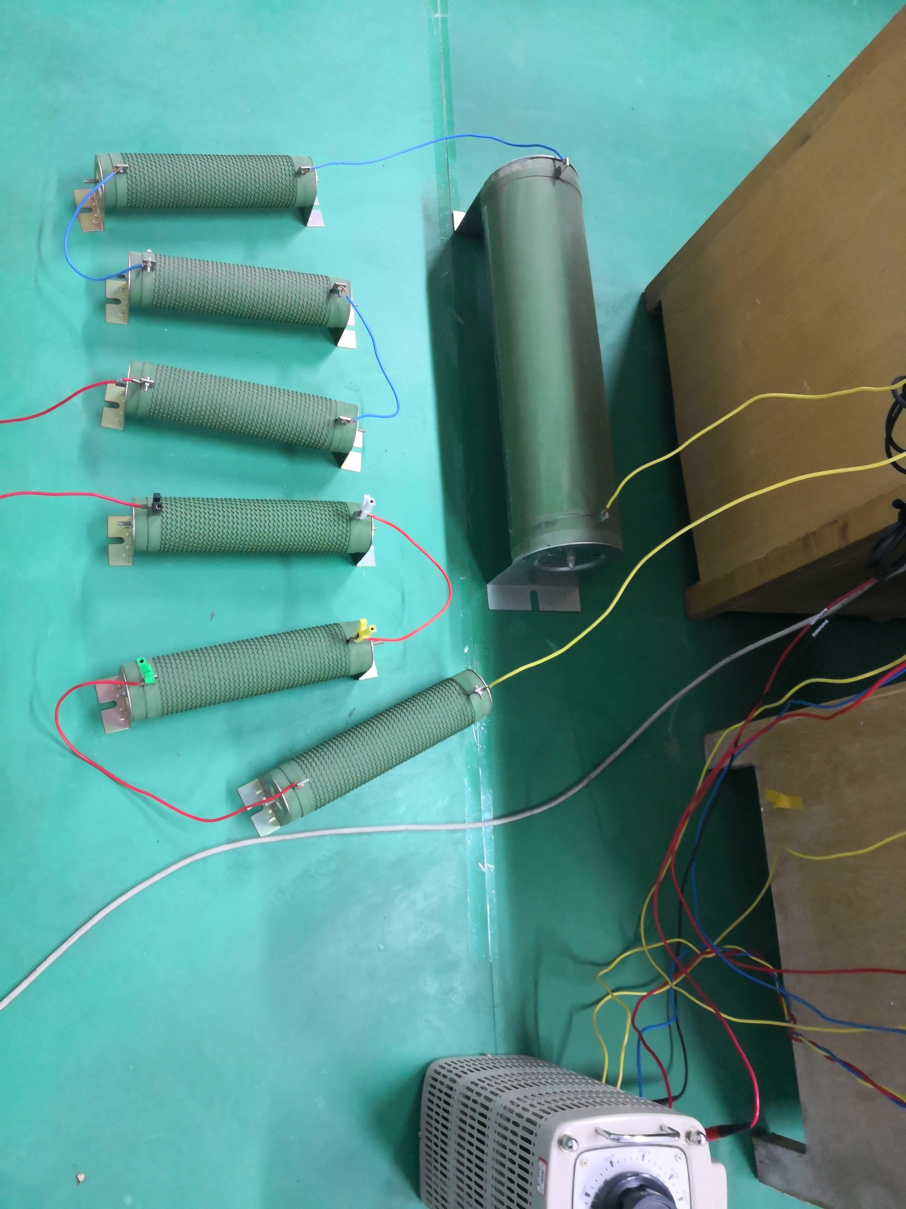

    2.I'll give you a brief account of the laboratory so that you can restore it. As shown in the figure, it is the resistance on the load side: Six 50 ohm (1kW) resistances, one 200 ohm (10kW) resistances,
    The input side is connected with a 6KVA voltage regulator,Voltage adjustable input, frequency 50Hz.

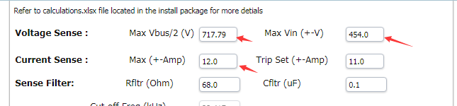

    How is Max VIN here determined? How to determine the maximum value of current sampling? I saw the calculation in the calculation.xlsx, but the max VIN calculated in it is 416.917v, which is different from here. What resistance is the Rdiff in the table? How to make sure? Is there any formula to support it?

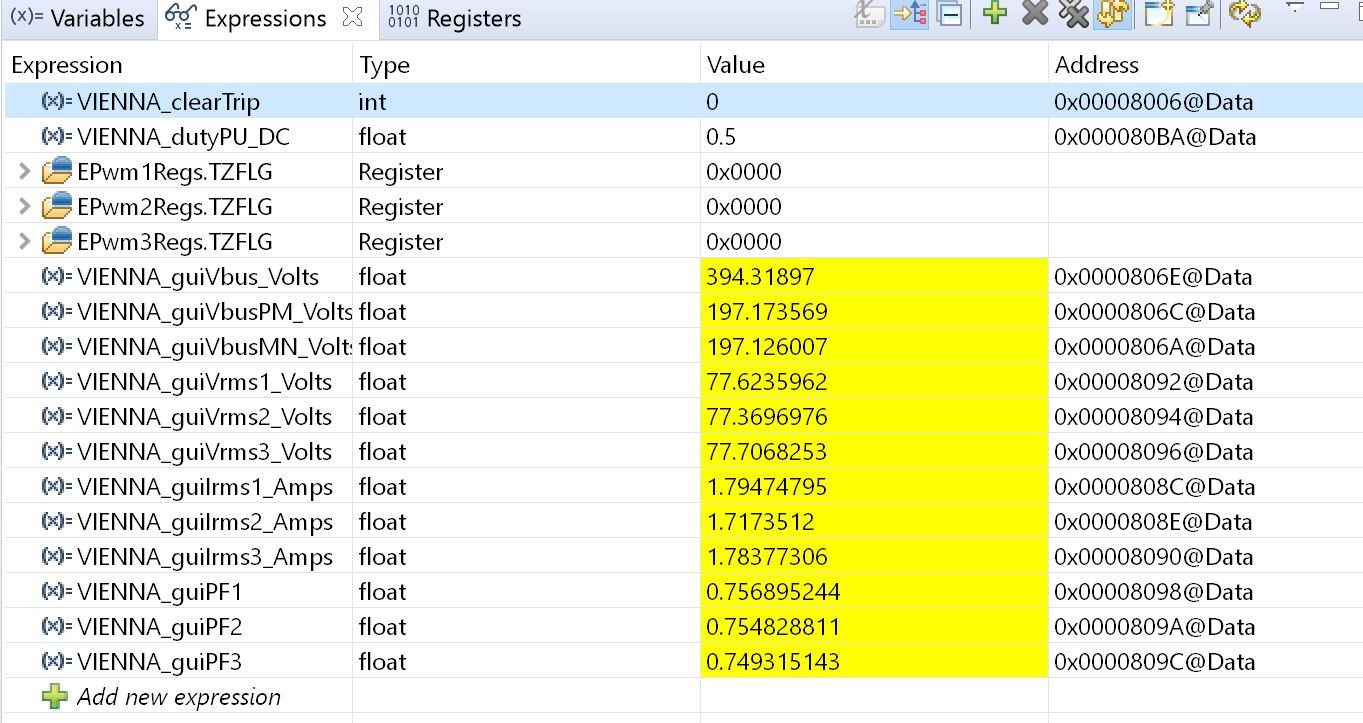

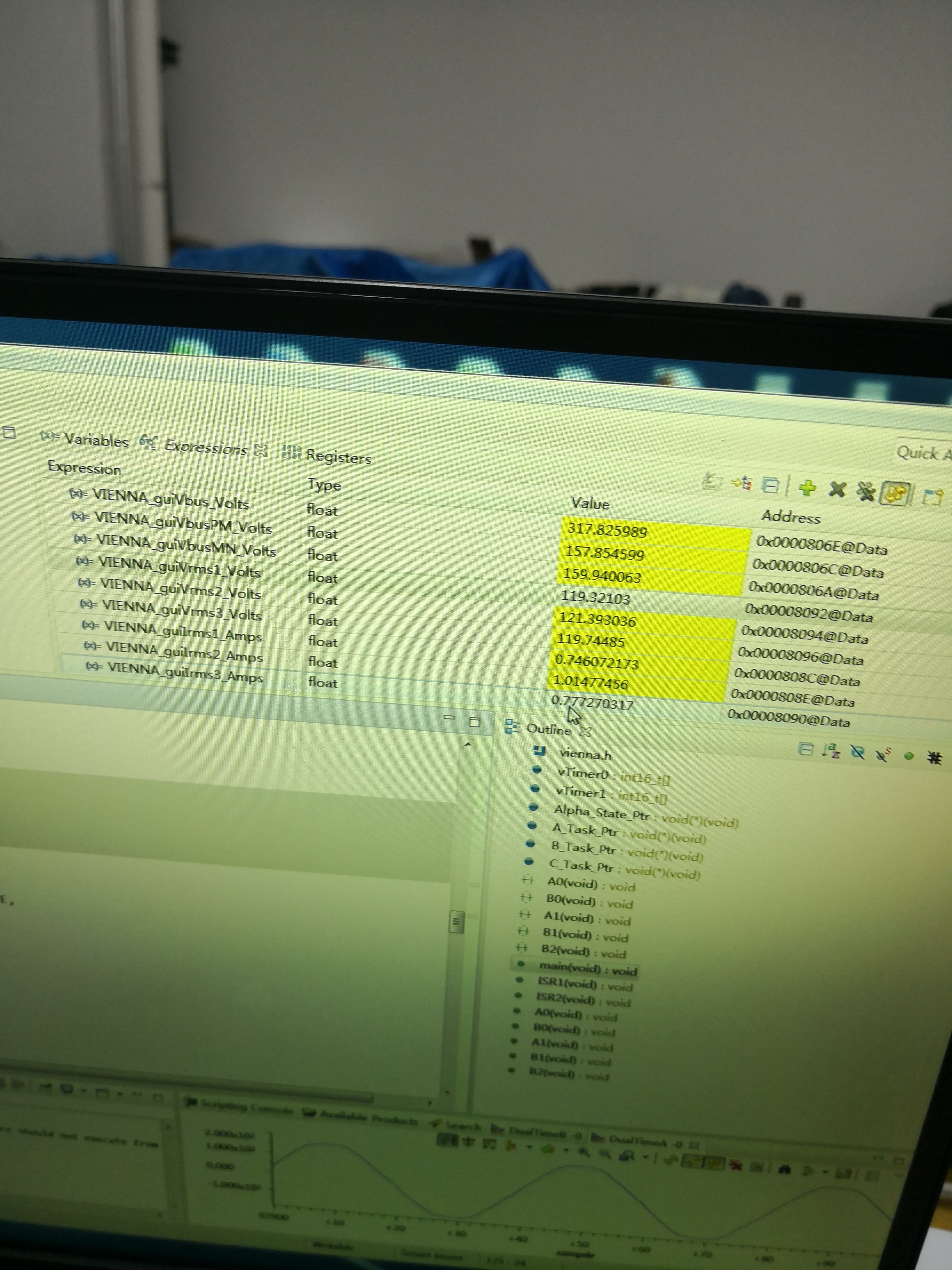

    I have retested code based on F2837x and I don't see anything wrong with build 1 and build 2 with 50kHz. Please see the expression window as below:
    Build 1:
    Build 2:
    You can see that with open loop, there is minor imbalance for three phase current. But with current closed loop, the imbalance is negligible. Can you compare your expression window with mine to see if there are any difference there?
    Also, the neutral line current exists when input current is not sinusoidal.
